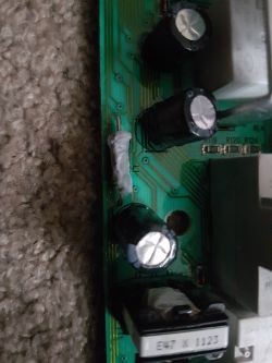

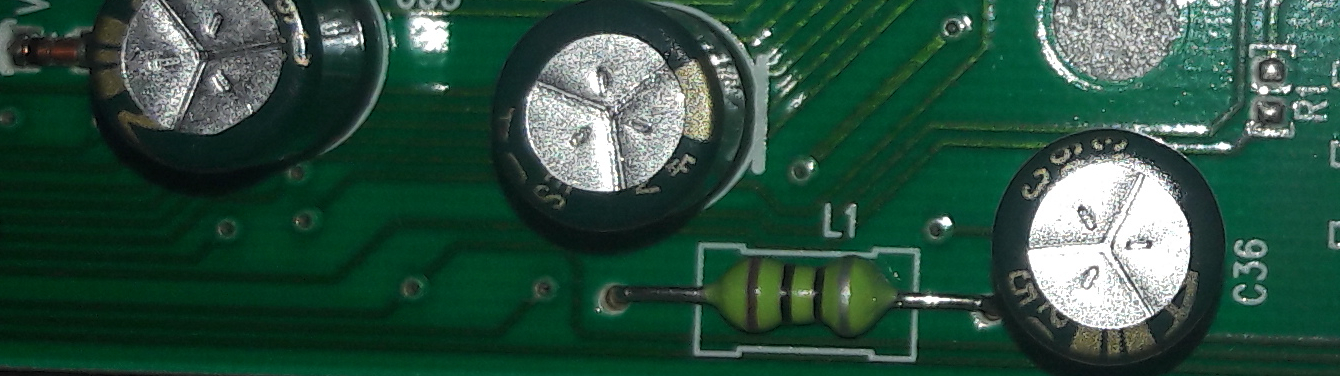

    Hi there,
    I need to know the value of the L1 resistor on EWM2100.
    if anyone can help me please?
    Thanks

    This resistor is not 0.01 mH

    L1 self

    10uH
    Added after 13 [minutes]:
    >>21487910
    The lack of feedback to LNK304GN would turn IC off
