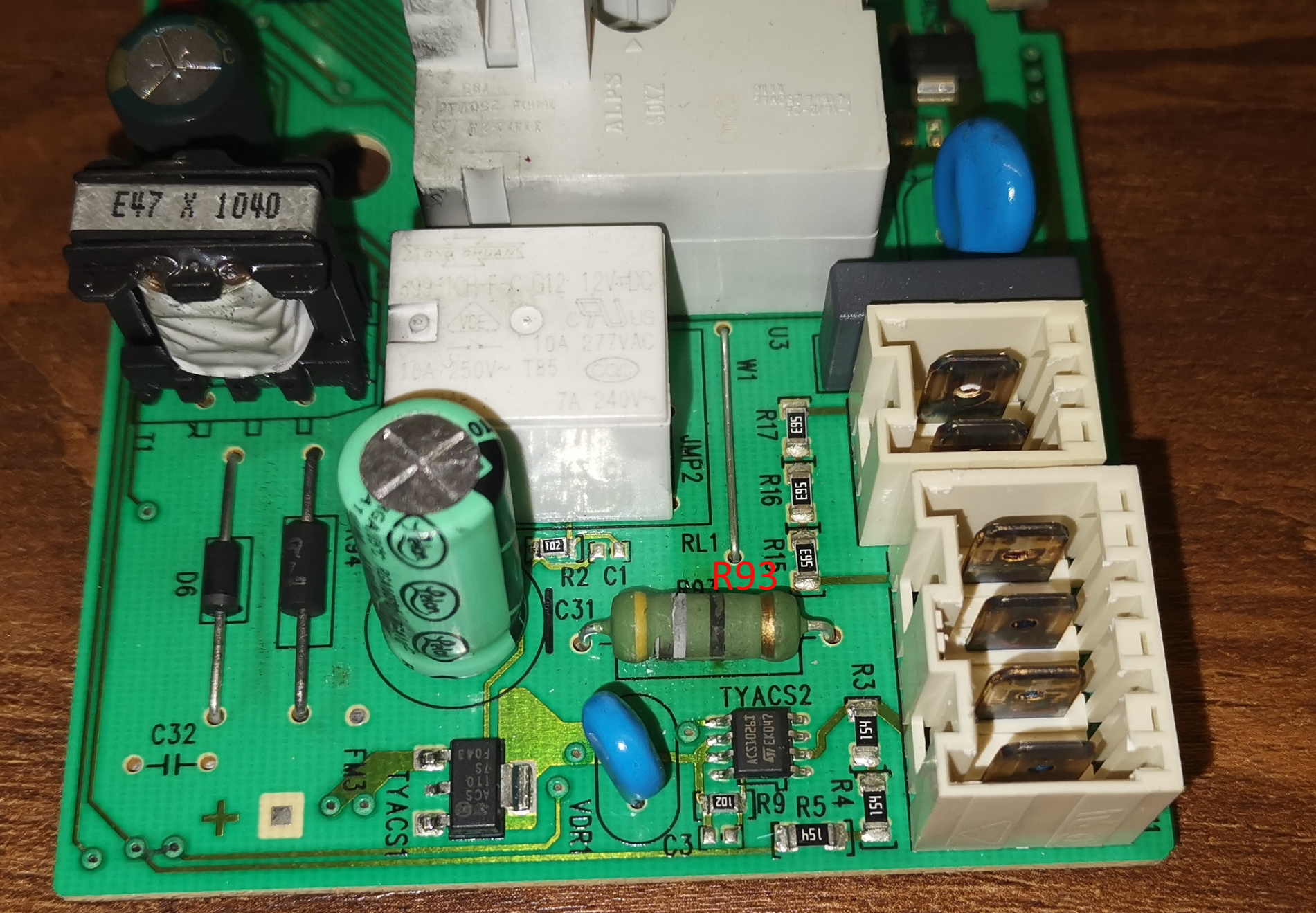

EWM 2100: Seeking R93 Resistor Value - Assistance Needed (with Images)
Mohamed aziz 13383 5
  • #1 18553763
    Mohamed aziz
    EWM 2100: Seeking R93 Resistor Value - Assistance Needed (with Images) EWM 2100: Seeking R93 Resistor Value - Assistance Needed (with Images)
    Please help me to get R 93 value
  • #2 18573021
    TONI_2003
    Moderator
    Posts: 15334
    Help: 2195
    Rate: 3826
    Printed circuit board with electronic components, including a capacitor, a 47-ohm resistor, diodes, and integrated circuits.

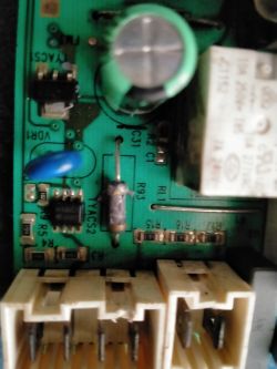

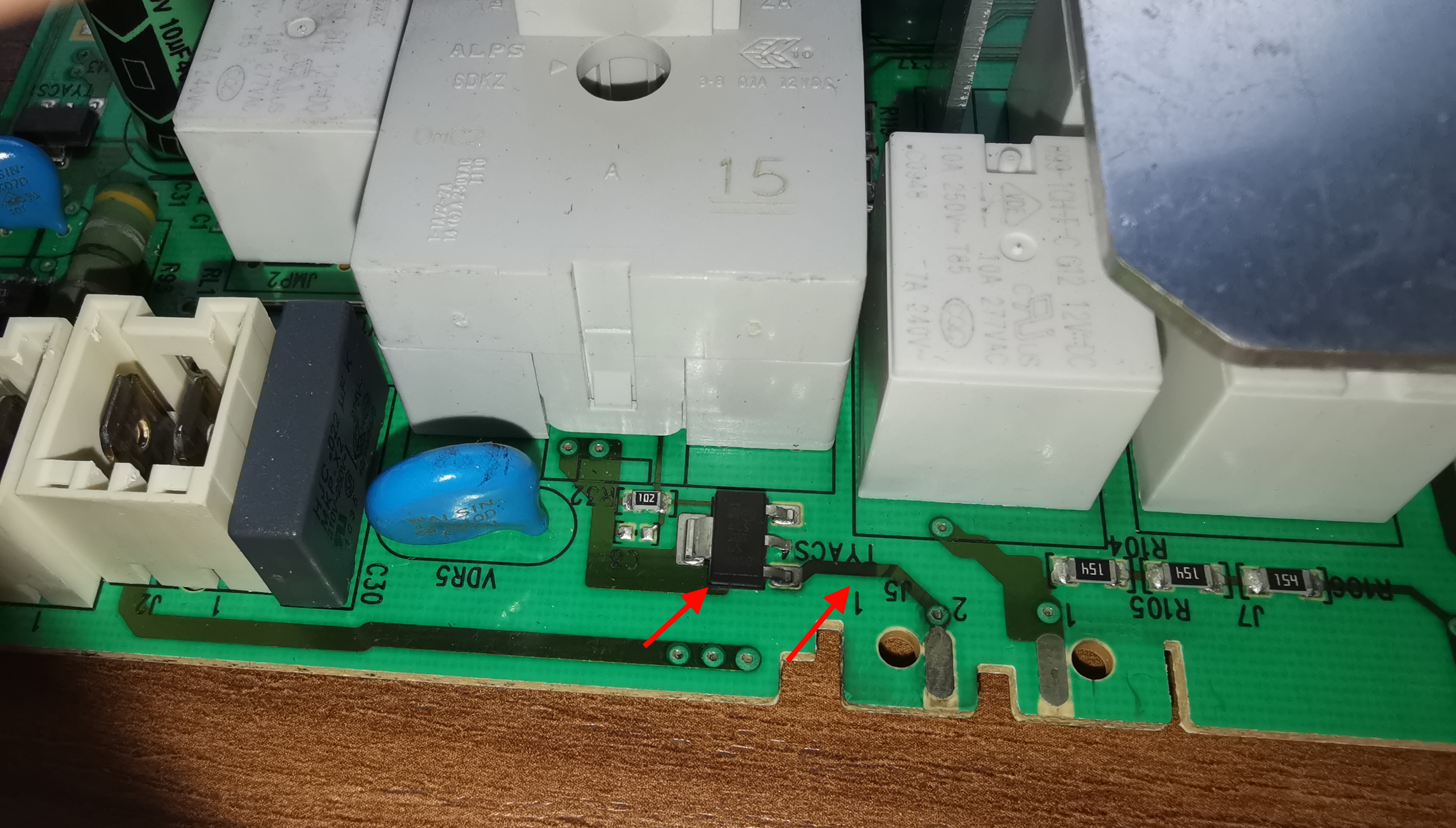

  • #3 19626833
    SXC
    Posts: 143
    Rate: 22
    @Mohamed aziz, I have a similar problem. Broken R93 resistor and welded ACS108 6S S052 triac with track.
    Did you fix it?
    If so, what items did you mention?
    What could have caused the R93 resistor to burn?
    Thanks for the hint.
    • EWM 2100: Seeking R93 Resistor Value - Assistance Needed (with Images) IMG_20210925_163051_.jpg (3.79 MB) You must be logged in to download this attachment.
    • EWM 2100: Seeking R93 Resistor Value - Assistance Needed (with Images) IMG_20210926_015209_resized_20210926_015248901_.jpg (1.39 MB) You must be logged in to download this attachment.
  • #4 19627578
    TONI_2003
    Moderator
    Posts: 15334
    Help: 2195
    Rate: 3826
    @SXC
    Control board with labeled components for a washing machine.
  • #5 19628316
    SXC
    Posts: 143
    Rate: 22
    @ TONI_2003 thank you for this diagram, I am looking for more information, what should I replace when I have burnt Resistor R93?
  • #6 19628381
    TONI_2003
    Moderator
    Posts: 15334
    Help: 2195
    Rate: 3826
    This is a wrong question, look at the areas marked as no. 1 (measurements + exchange) :D
    Image of a green printed circuit board with areas marked as numbers 1, 3, and 5 in red outlines and yellow lines.
