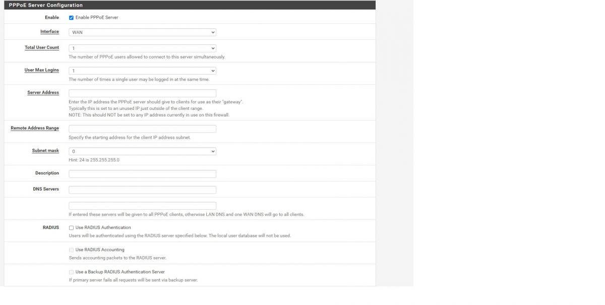

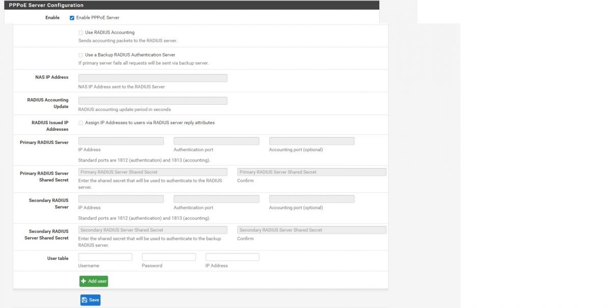

    But let's move on. Just like a colleague here @yszne he wrote. DMZ is DMZ, so set DMZ on your pfSense and you don't need to enter any logins and passwords from neostrada.
    But I want to disconnect FunBox 3.0 from the optical fiber, connect the optical fiber to the terminal and then connect it to a computer with PfSense installed and a network card with 2 LAN ports with a capacity of 1gb / s (then to Swich and to servers)
    the panel is working, etc., but there is no internet access
    Because I have to enter my Neostrada login and password somewhere

    but you don't have to make a PPPoE server but create an interface which will be the PPPoE client
    I think you have Google turned off.

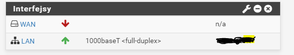

    I filled in according to the guide and it still does not connect
    Added after 4 [minutes]:
    IP variables how to set IP constants additionally PfSense configuration to Orang
    Added after 49 [minutes]:
    Anyone else has any idea how to configure it with Neostrada
    I will add that I connect everything to a separate computer with a network card on a pci express

    and have you read that the internet is on another vlan, that voip and iptv also have their vlans?

    MANAGED TO
    It is true that instead of 1gb there is 500mb, but this is normal for Orange
    I had to enter 35 in Vfn and add port to PPOE
