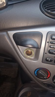

    Hello, I have a question: Is it possible to easily make it so that when the car is turned off (turning the key), the cigarette lighter also turns off? I use a water recorder/transmitter, so it's annoying to have to pull the plug out of the socket every time. Ford focus car Ford cigarette lighter power supply - How to turn off the cigarette lighter power supply with the ig

    Anything is possible ;) . Look for the power supply for this cigarette lighter near a fuse panel, find the line that is controlled by the key and switch the cigarette lighter there. Remember about the fuse and the current carrying capacity of the circuits, because you can quickly burn up the car.

    Strange, the cigarette lighter should be disconnected when the key is removed. I guess someone has already messed with this before.
    The camera consumes so little power that when I have the opportunity, I would install a second socket to power it, even from the radio that is next to it.

    The simplest option is to power this socket through a relay. Then, control the relay coil + through the ignition switch and turn on the 12v power supply. Just remember about the relatively high current of this relay (min 15A). Regards

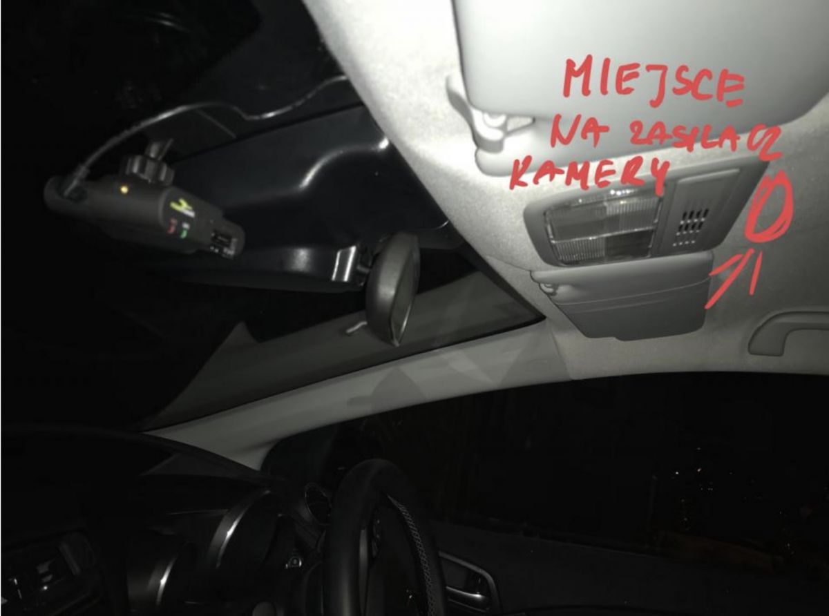

    Check whether the interior illumination lamp turns off after closing the car (locking the doors with the remote control).
    This happens in Renault Scenic, Nissan Micra and Leaf, Honda Civic. I have video recorders connected to the power lamp. Works very nicely. It records from the moment the car is unlocked with the remote control until it is locked again. If you turn off the engine and sit in the car, it continues to record, which is sometimes useful.
    Actually, it's not stupid, but how do I get there with cables?
    For example like this:
