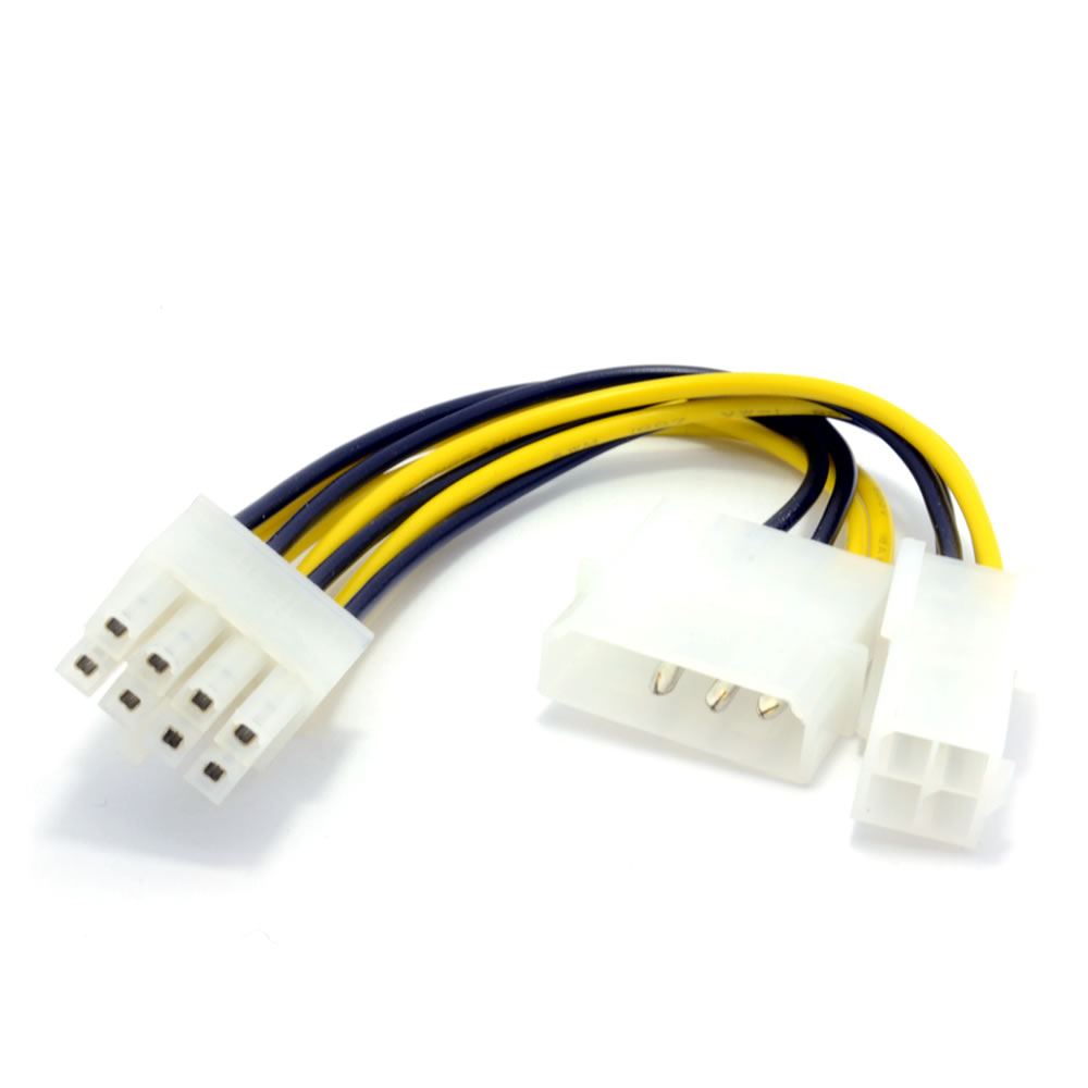

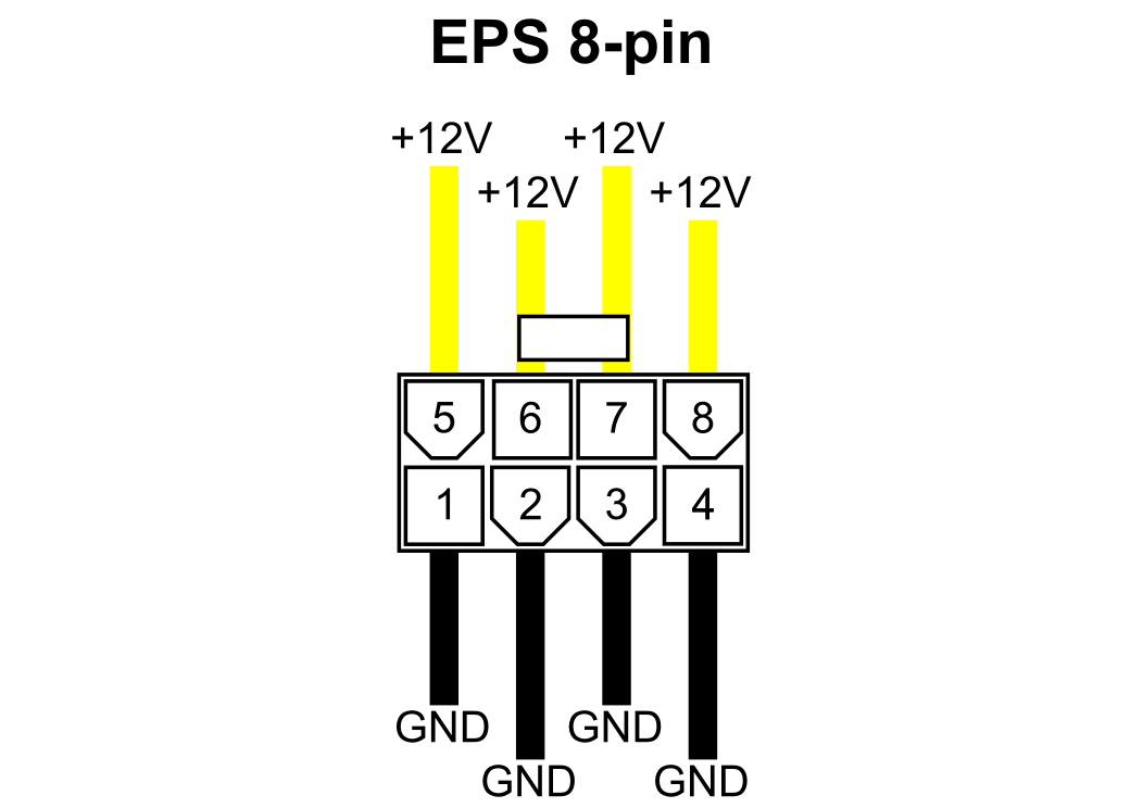

    The power supply diagram of the EPS 12V 8PIN socket is as in the figure below, i.e. 4x12V / 4xGND
    They also sell adapters if someone does not have a power supply with such a cable.
    The molex plug is 12V / GND / GND / 5V
    So the adapter sold gives the motherboard 2x12V and 2x 5V, not 4x12V.

    This adapter is bad!

    I started to wonder why this adapter is bad ... Seriously, someone connected the 5V molex to the CPU power .... But it has no right to work. There are probably good adapters in circulation, but in this case it will be unnecessary, unless there is some extreme OC. But it's also not on this album.

    Maybe they also sell motherboards and power supplies. This adapter has the potential to kill both.
    Today everything that someone is ready to buy is selling. I have even seen passive DVI-D - D-SUB adapters - they do not work and do not work, but they are available for purchase.

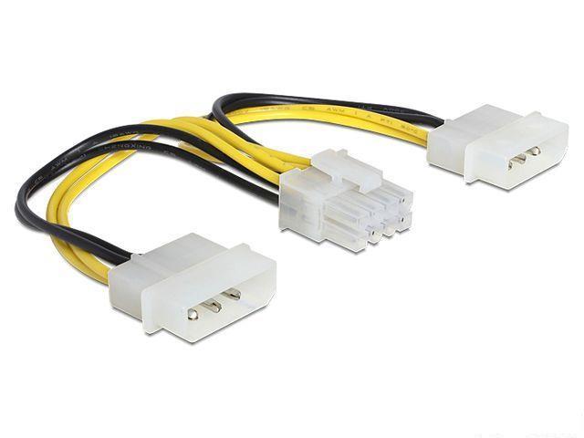

    The best logically speaking is this:
    Understanding the Power Supply Diagram for the EPS 12V 8PIN ATX Plug
    It fulfills its role both in theory and in practice. Ideally, as if it had two MOLEX connectors, but I have never seen one like that. There are at least 3 12V lines here.
    Are available.
    For now, it's such a problem search - 4pin alone is enough!
