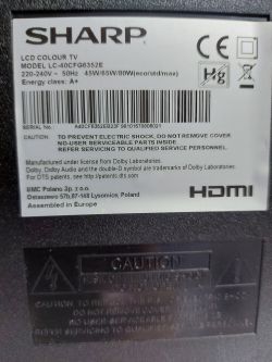

    Greetings!
    This TV came to me. There was no remote control for it, I assigned a new remote control on eBay but it doesn't respond. The remote control is of course RF not infrared, its packaging says to be paired with the TV, it describes how but the TV does not ask for pairing. My suspicion is that the software on my TV is bad because the TV works but the picture is very low contrast and extremely grainy.
    If anyone could help me with a good USB firmware.
    chassis: TP.MS6486 PB711
    screen: LY.24601G001 4VW40171Y 40KM-C
    T-CON: K0075ZP
    Thank you very much!

    which remote control have you buyed?
    the remote control code for this model is SHW/RMC/0117
    here is the right software
    • A40CF6352EB23F.zip (149.08 MB) You must be logged in to download this attachment.

    MrFrank01
