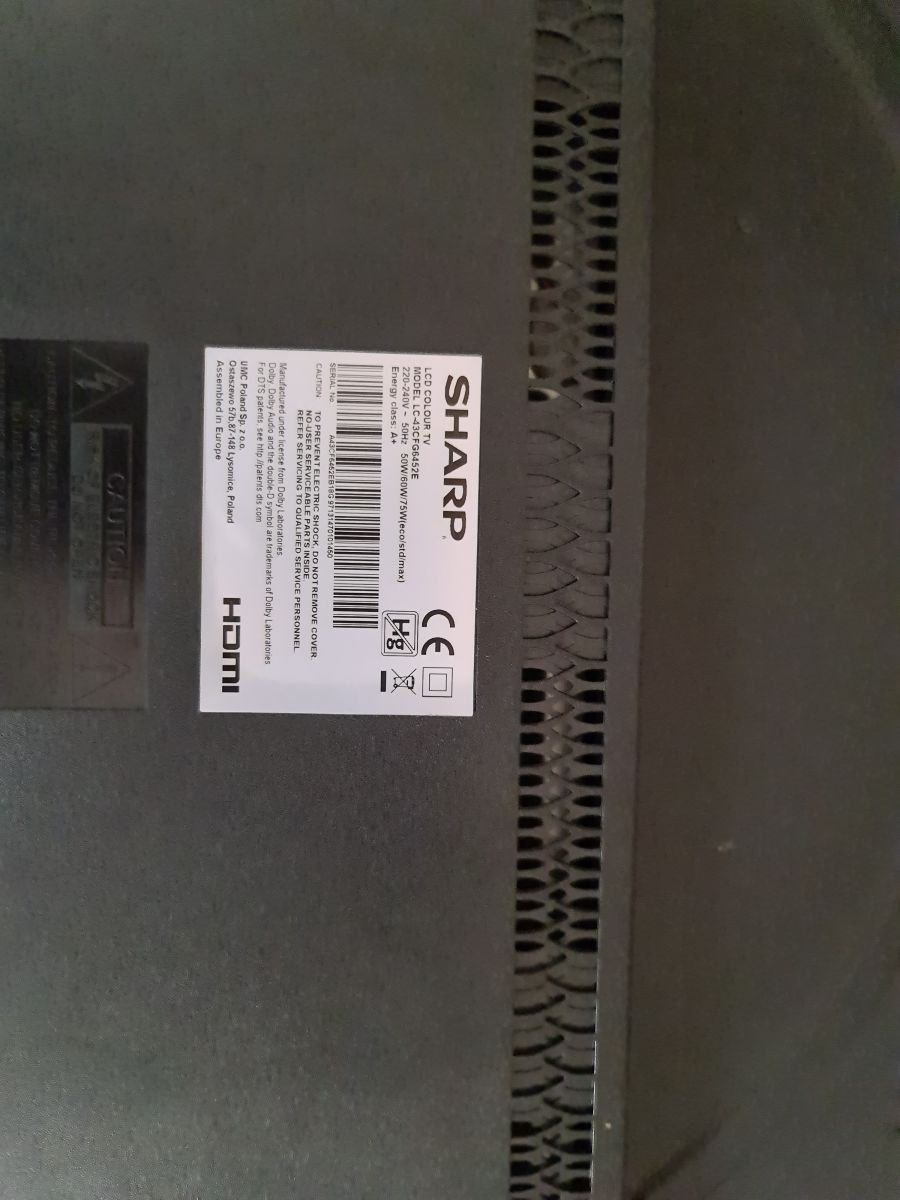

  • #3 21022839
    idkot2014
    Mark: SHARP
    Model: LC-43CFG6352E
    Sharp Aquos keeps switching channels up
    Firmware please
    Product label of a Sharp Aquos TV, model LC-43CFG6352E.
    The unclear photo shows LC-43CFG6452E, the model and photo need to be corrected.
  • #6 21023672
    Aquario_blue
    Level 19  
    Posts: 277
    Help: 41
    Rate: 155
    The software, is for label template

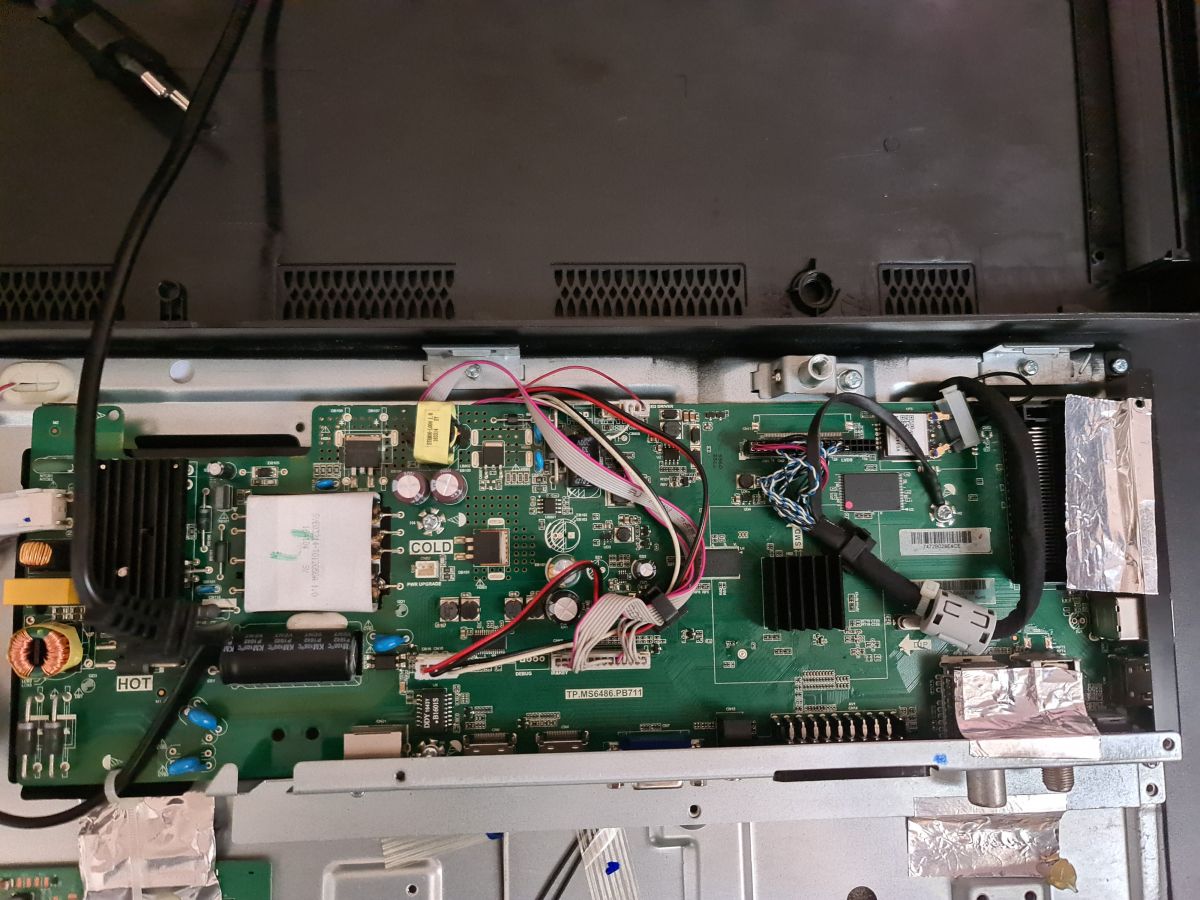

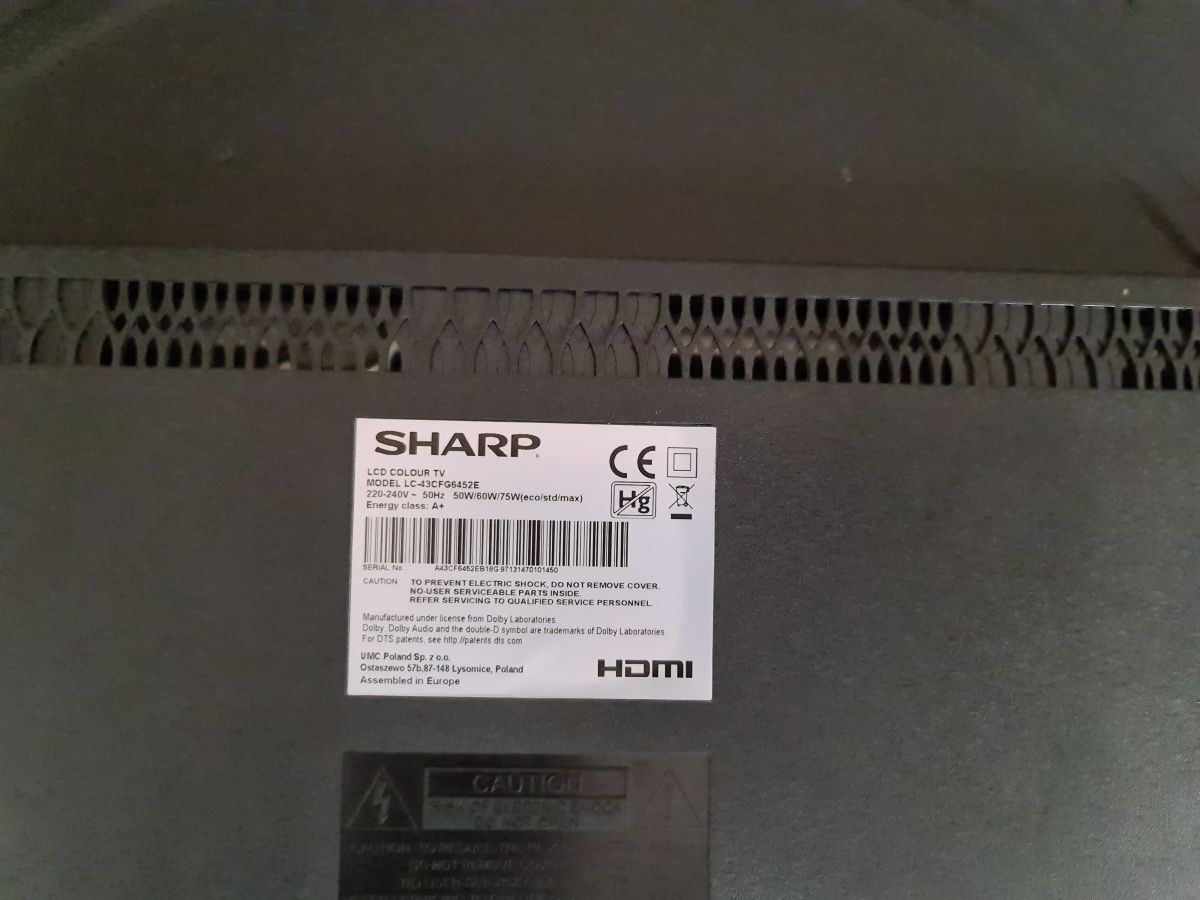

    #7 21024628
    idkot2014
    Yes you are right, sorry about that
    Sharp LC-43CFG6452E
    Firmware needed please to test
    Sharp Aquos keeps switching channels up by itself, anyone has faced this problem?
    Is it a software problem or a hardware, I have disconnected side buttons from the main board, and the same problem keeps switching channels up Label of Sharp LC-43CFG6452E TV with technical information and HDMI logo.
    Main board of Sharp LC-43CFG6452E TV with visible connections and components.
  • #8 21028117
    querij
    Level 21  
    Posts: 375
    Help: 42
    Rate: 227
  • Asking whether TP.MS6486.PB711 main boards are compatible
    #9 21030484
    idkot2014
    I have this model Sharp LC-43CFG6452E TP.MS6486.PB711
    B16117722-0A00148
    screen: LC430DUY - SHA1 75W3
    2- You have this model on sale (Link below), is this compatible with the model that I'm looking for?
    a- https://www.tvparts.co.uk/lcd-tv-spares/main-...ms6486-pb711-main-pcb-for-sharp-lc-40cfg6452k
    b- https://www.ebay.com/itm/266745091136?mkevt=1...&osub=-1%7E1&crd=20240403003034&segname=11050
