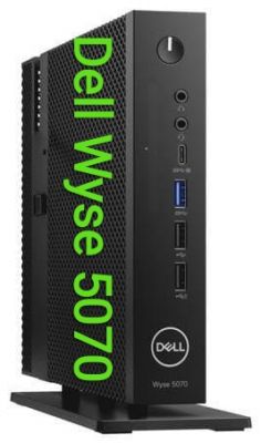

    Hello!
    I would like to ask about unusual use of the terminal. Will Dell Wyse 5070 with such parameters play YouTube videos smoothly in Full HD?
    Intel Pentium Silver J5005
    (4 Core, 4M Cache, Frequency 1.5 MHz - 2.80 GHz)
    Intel® UHD Graphics 605
    (Frequency 250MHz - 800MHz)
    DDR4 8GB RAM

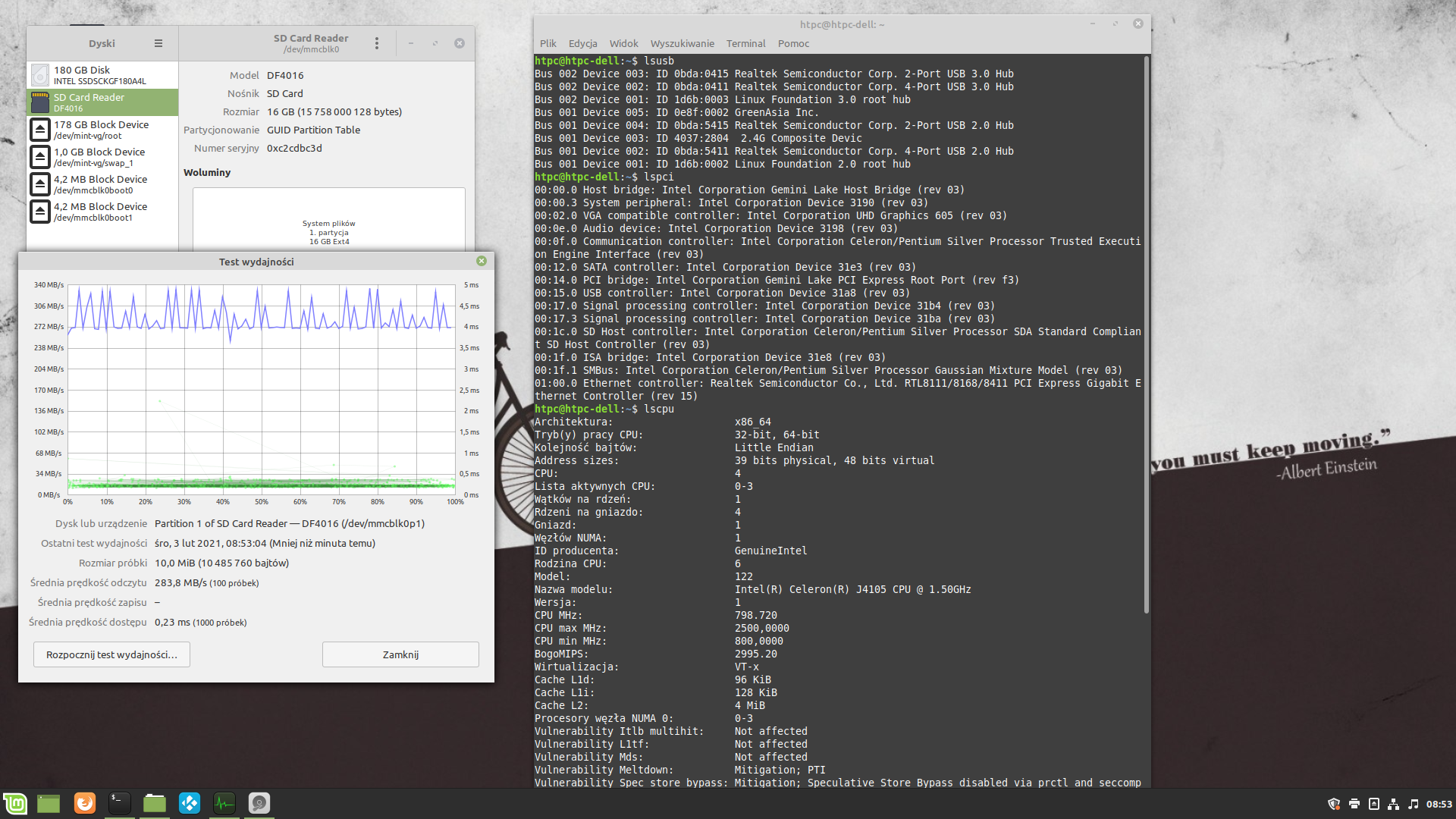

    6. I don't use it. When I decided on Mint, I immediately wanted to avoid the tightness and gymnastics of more specific updates, especially since the SSD costs PLN 70. The eMMC memory is visible as an SD reader, but SMART data cannot be displayed for it. Below you can see a test of its performance and the Wyse hardware (Asia and 2.4G are my peripherals connected to USB).
    Dell Wyse 5070 - YouTube video playback in Full HD with Intel Pentium Silver J5005 processor
    SSD achieves a result of approximately x2.

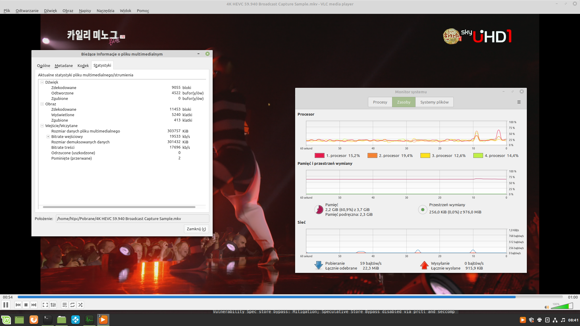

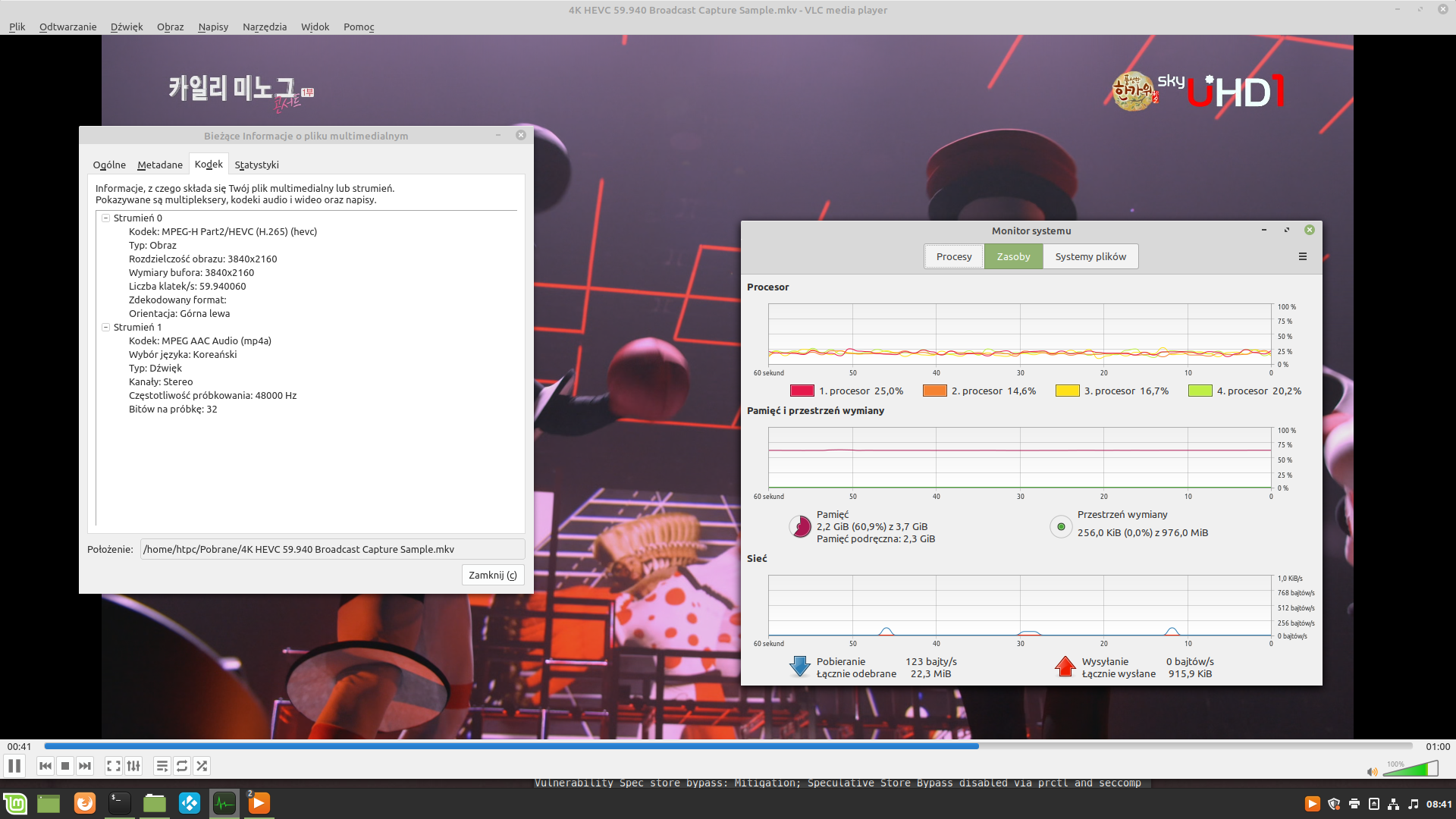

    I also did a 4K test for higher FPS. Result from VLC below:
    Dell Wyse 5070 - YouTube video playback in Full HD with Intel Pentium Silver J5005 processor Dell Wyse 5070 - YouTube video playback in Full HD with Intel Pentium Silver J5005 processor
    You can watch it without any problems, but as you can see, it loses about 8% of frames.

    Now I know that Wyse has eMMC SanDisk DF4016 memory that can accommodate max. save 16 TB of data. There is also a 32 GB version with a maximum storage capacity of 22 TB of data. Your eMMC read test of 283.8 MB/s is consistent with the datasheet.
    When it comes to the 4K test, I am positively surprised. It is possible that Wyse with the J5005 processor and UHD 605 graphics card will play a 4K 60 FPS movie smoothly.

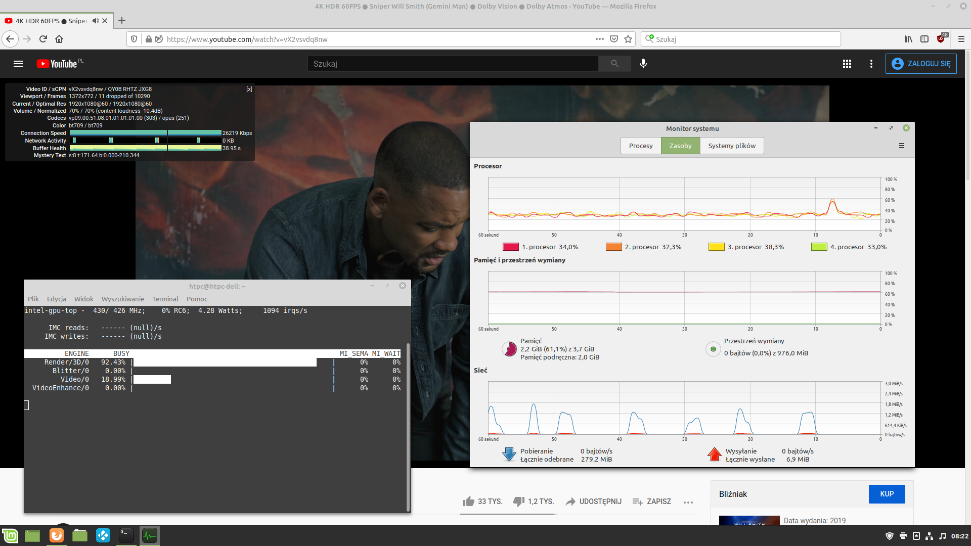

    Here you go, here's a short test :wink:
    But let's start from the beginning. In order for Firefox to use hardware acceleration, it must be configured as follows:
    https://wiki.archlinux.org/index.php/Firefox#Hardware_video_acceleration
    The browser had only one uBlockOrigin add-on installed, it was launched with MOZ_X11_EGL=1. Monitor resolution - 1920x1080 60Hz.
    The first test was a 1080p/60fps trailer from the website:
    https://www.youtube.com/watch?v=vX2vsvdq8nw
    Display result in browser window:

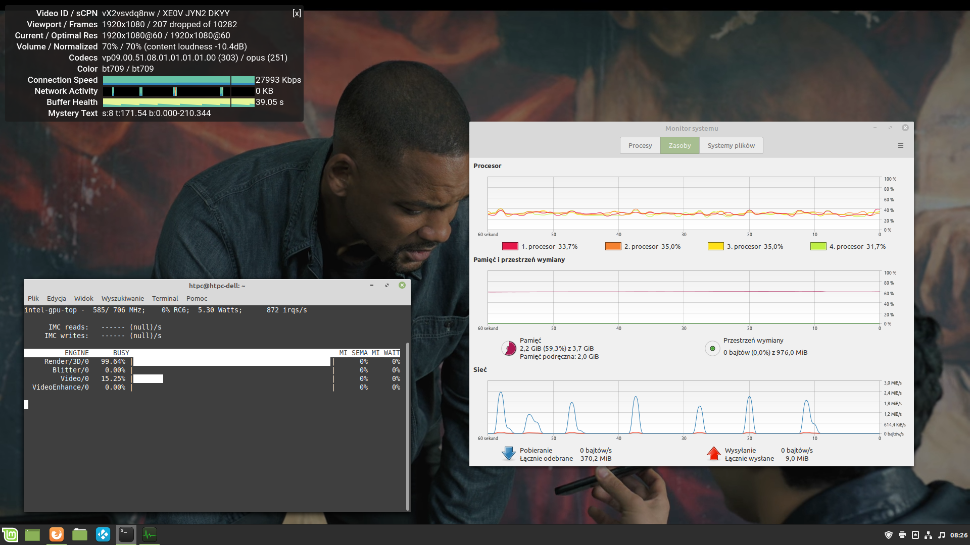

    Full screen display result:
    As you can see from the above, it loses some frames when displayed in full screen and the GPU starts to reach its clock frequency limits.

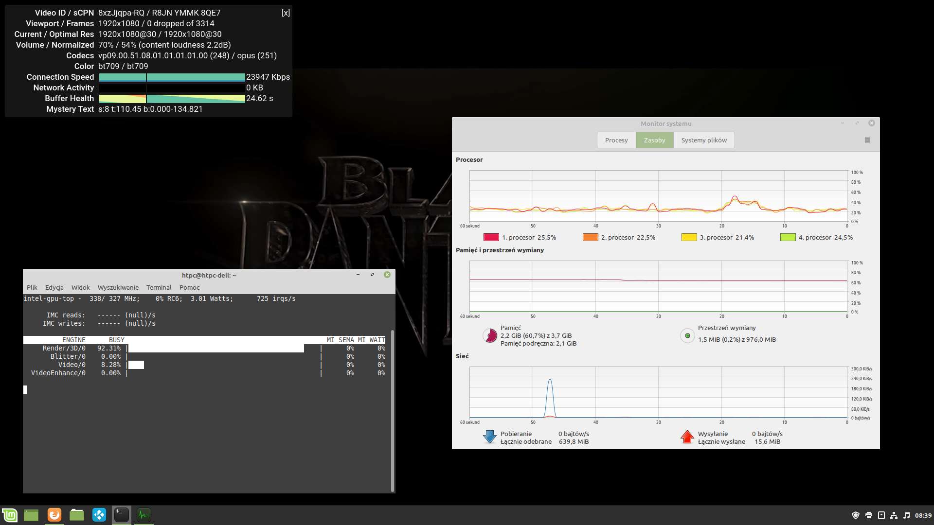

    For comparison, 1080p/30fps material from the website:
    https://www.youtube.com/watch?v=8xzJjqpa-RQ

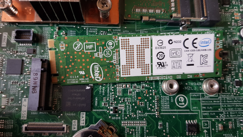

    Answers to questions:
    1) 1.1.3
    2) The entire installation is on SSD and boot directly from it.
    3) For me it looks like there are 2 mountings:
    I have a disk:
    https://ark.intel.com/content/www/us/en/ark/p...530-series-180gb-m-2-80mm-sata-6gb-s-20nm-mlc. html

    That is, playing YouTube in Full HD at 60 FPS in full screen resulted in the loss of approximately 2% of frames. I think this is a very good result.

    In fact, it's not bad and if you don't approach it pedantically, there's nothing to worry about. Most videos are up to 30fps anyway.

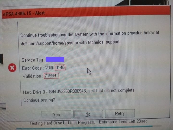

    First of all, I would like to point out that I bought the disk new with a 24-month warranty, but it was returned (it was unpacked and had 3 hours of operation).
    I installed linuxmint-20.1-cinnamon-64bit on the disk and using
    Code: Bash
    I did a quick test, but I didn't find any errors.
    Then I updated the BIOS to the latest version 1.9.0, but the ePSA test (4306.15) showed the same error (2000-0145).
    Linux Mint works stably on this disk, but I will do a more thorough test in my free time.

Yes. A Wyse 5070 with the similar Celeron J4105 plays YouTube 1080p up to 60 fps in Firefox. Expect comparable or better with J5005. Enable hardware acceleration to minimize dropped frames during fullscreen playback. [Elektroda, maciejsa, post #19225441]
How do I enable Firefox hardware acceleration for YouTube on Linux?
Use this quick setup:
  1. Follow the Arch Wiki link in the post to configure VA‑API for Firefox.
  2. Keep extensions light; the test used only uBlock Origin.
  3. Launch Firefox with MOZ_X11_EGL=1 and verify 1080p/60. The test ran at 1920x1080/60 Hz. [Elektroda, maciejsa, post #19234989]
Can VLC or Celluloid play 4K video on the Wyse 5070?
Yes. Both apps displayed 4K/30 fps content. In a VLC test, playback was watchable but dropped about 8% of frames. 50/60 fps at 4K was not verified. This is acceptable for casual viewing, but not ideal for critical use. [Elektroda, maciejsa, post #19230092]
Will 1080p/60 fullscreen in Firefox drop frames?
Expect small drops. One test at 1080p/60 in fullscreen lost about 2% of frames, which most viewers will not notice. [Elektroda, czasnagli, post #19235622]

Install on an M.2 SSD. The eMMC read measured about 283.8 MB/s and did not expose SMART. A SATA M.2 SSD delivered roughly 2× the performance. That makes the system feel more responsive and simplifies maintenance. [Elektroda, maciejsa, post #19230092]
Which M.2 sizes fit, and can I boot directly from SSD?
The board shows two mounting points, and a 2280 SATA M.2 SSD fits. The system installed to and booted directly from the M.2 SSD without extra steps. An Intel 530 Series 180 GB M.2 80 mm worked. [Elektroda, maciejsa, post #19234989]

Which BIOS version and ePSA build passed SSD tests?
With BIOS 1.1.3 and ePSA build 4306.15, the system passed a full ePSA test on an Intel 530 Series M.2 SSD. This indicates good baseline firmware stability. [Elektroda, maciejsa, post #19289337]
Why do I get ePSA 2000-0145 on my Apacer AST280 M.2 SSD?
One user saw ePSA error 2000‑0145 on an Apacer AST280 after updating BIOS to 1.9.0. Despite the error, Linux Mint operated stably on that SSD. This suggests a compatibility quirk or false positive in ePSA. [Elektroda, czasnagli, post #19289762]
