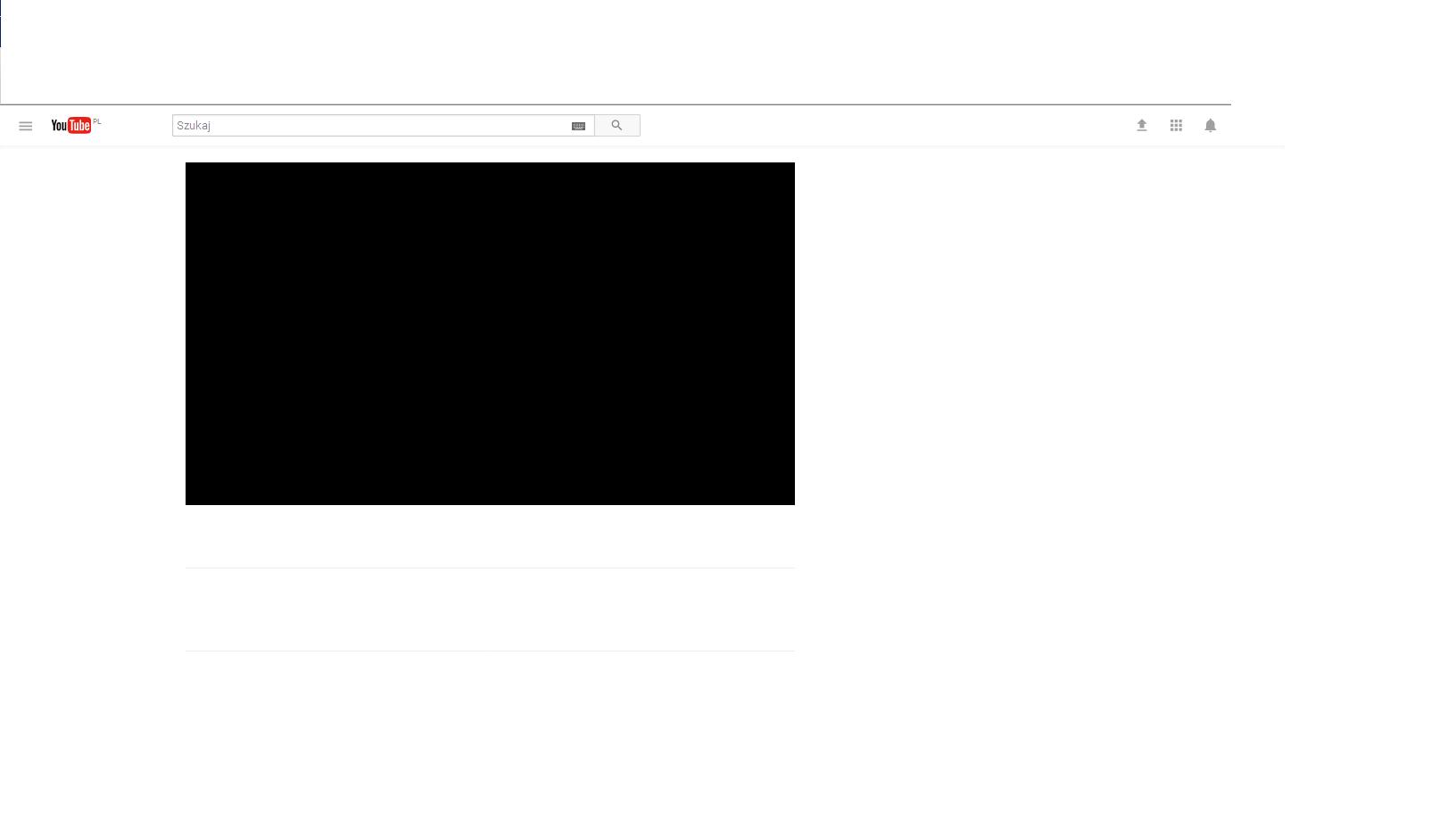

    Youtube does not break, I'm afraid it is thanks to Windows XP and browsers that are no longer supported on this system. This system was released 16 years ago and unfortunately it's time to say goodbye. Of course, it can be used e.g. in offices, but for multimedia or the Internet it is already a dinosaur.

    It is interesting. I have della xt2 with core2duo 1.6GHz with planted xp pro sp3 and I do not observe problems with youtube.
    Browsers are opera and firefox.

    There is no, you can optionally download movies to disk and play from the disk, maybe then they will play correctly.

    ruensky123 wrote:
    I also have Dell and Sp3.
    Don't you have something set up in energy management?
    I set it so that working on batteries I have limited performance and youtube cuts out but after connecting the power supply the system goes to maximum performance and playback becomes smooth.

    Or a dirty heat sink on the processor.

    Click on YT on the icon of your profile in the upper right corner and select from the menu at the bottom: "Restore Youtube classic look".

    You won't change HTML5.
    I have on one of the computers XP, 1GB of RAM, E2140 and YT work normally, so it's rather a matter of your computer / system / internet / settings.

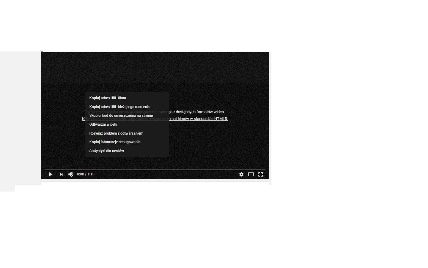

    I also stop after about 20 minutes, probably it has to do with inactivity, in the newer version of YT a message is displayed. Just jump forward 5s and continue playing.
    The same as here: https://support.mozilla.org/en/questions/1126635 it is possible that something is broken.
    If I have time, I will check if it stops under Chrome etc.
    From what I see, you can also try to uninstall Flash and see if something has changed.
    Is hardware acceleration on or off?

    Do you have enabled hardware acceleration in FF? They asked and you didn't answer.
    ruensky123 wrote:
    on html5 the movie stops after 20 minutes, without this error I would still be able to do it, what settings can be responsible for it?
    Amount of MB for FF buffer on disk (FF settings)?

    You may have an infection - screen # 1. Use MBAM, ADWcleaner, CureIt, specify FRST.txt and Addition.txt.
    You can reset the TCP / IP stack in connection with screen # 1.
    As for Flash vs HTML5, I note that newly uploaded movies due to a technological slip-up are only after a time of "converting" to HTML5 (Colleague @Kolobos maybe he'll explain better), because new movies on YT are like a "different race" of a movie.

    ATI RADEON XPRESS 200 series
    Compatibility does not guarantee such a retro card.
    In connection with stuttering, the issue of enabled acceleration and repeating occurs amount of RAM allocated to the card.
    On Geforce MX4 I don't remember full screen on YT at all.
