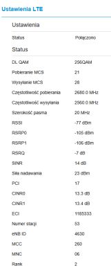

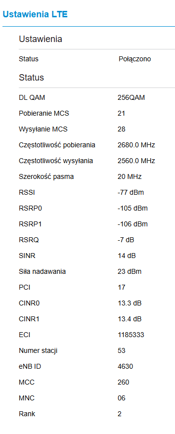

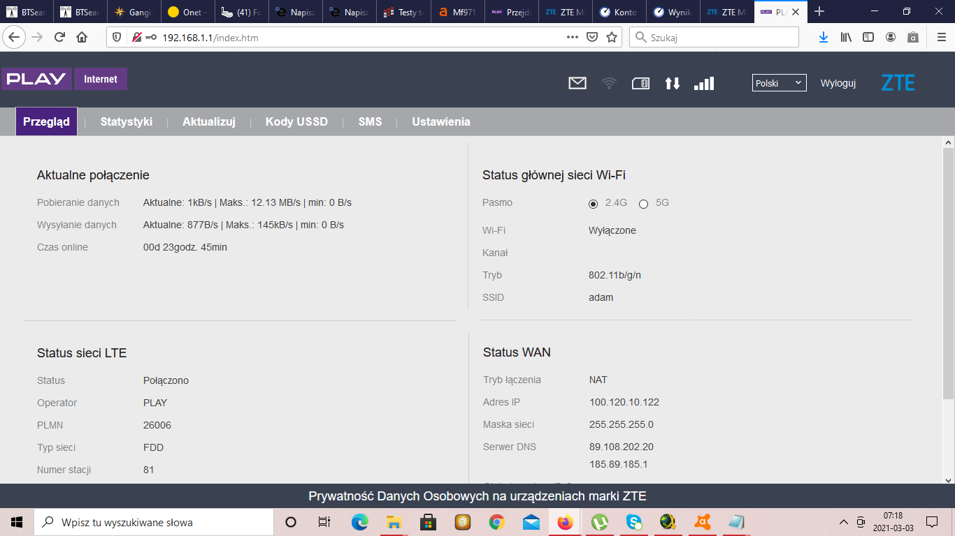

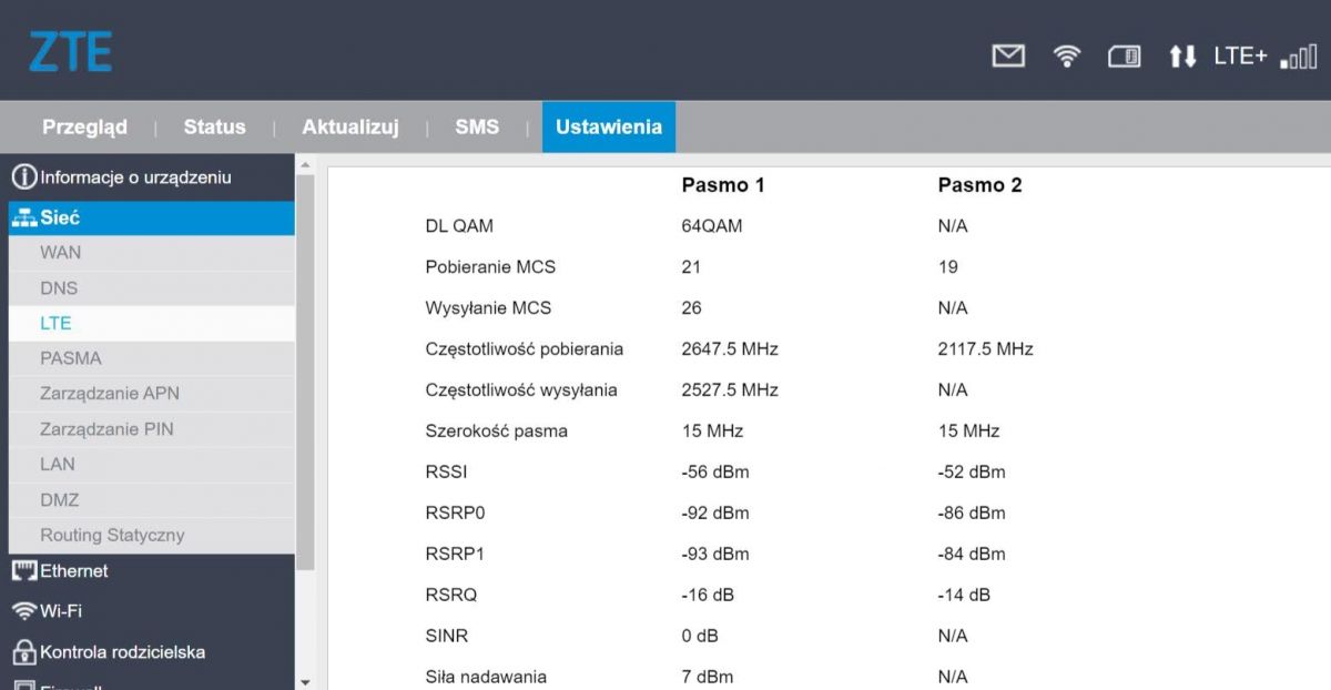

    Enclosed please find a few screenshots from the MF258K WebUI, particularly useful is the LTE Settings section which shows the base station data and signal parameters on individual LTE bands.

    • New ZTE equipment in PLAY: MC7010, MC801A and MF258K 5G/LTE? MF258k.PNG (109.52 KB) You must be logged in to download this attachment.
    • New ZTE equipment in PLAY: MC7010, MC801A and MF258K 5G/LTE? Ustawienia LTE.PNG (123.97 KB) You must be logged in to download this attachment.

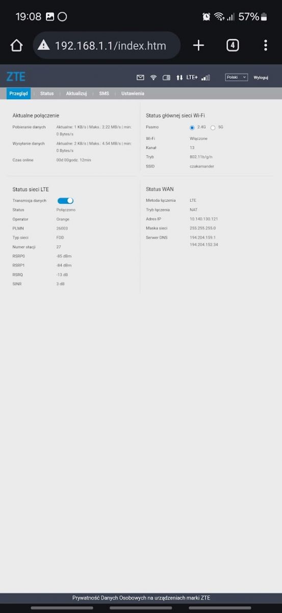

    Ok I bought a ZTE MF258K and the internet is working but I noticed that the station keeps changing. Is it possible to force the router to select the preferred station?

    And you've made a mistake, the MF258k is well known for jumping around base stations, changing them and bands. The antenna has a wide radiation angle, it receives sideways and even backwards, there are several NetWorks base stations for T-mobile in the area. Show me a screen shot of the LTE tab on the MF258K, where did it come from?

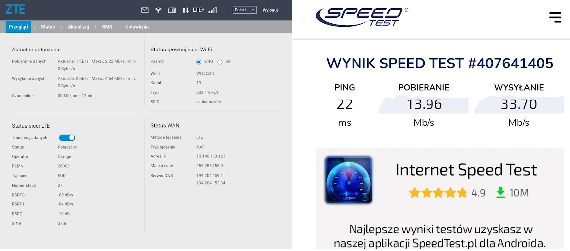

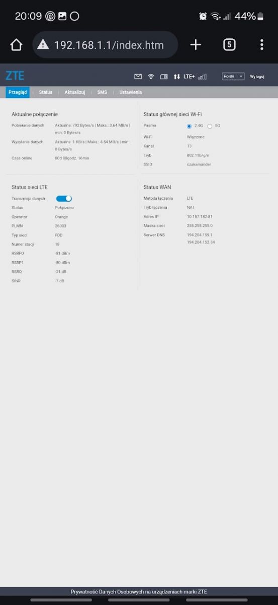

    I don't understand a bit. In your first post you write all superlatives about this equipment. So what equipment would be better?
    I attach a screen from the Overview tab (later I can add from the LTE tab)
    Station 27 has better parameters and the router switches to station 18 which has worse parameters
    I purchased from this offer:
    https://allegro.pl/oferta/zestaw-zte-mf258k-net-box-lte-cat-15-bez-simlocka-13679273282 .
    Screenshot of ZTE MF258K router settings, displaying LTE and Wi-Fi network statuses.
    Screenshot of the network interface of a ZTE LTE router.

    In the course of using the MF258K, problems with it came to light, the main one being the aforementioned changes of BTS when there are several in the vicinity. It works particularly poorly with Play softm, slightly better with T-mobile or without branding.
    Show LTE and speedtest results.

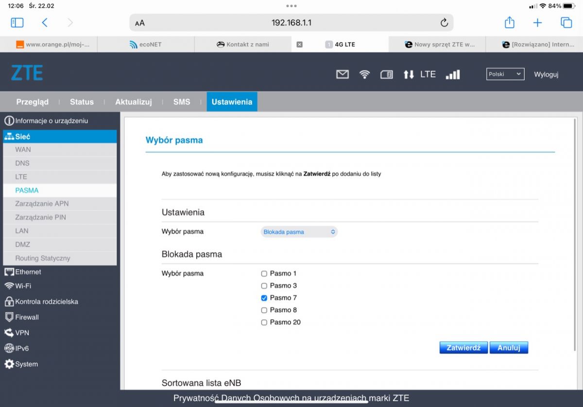

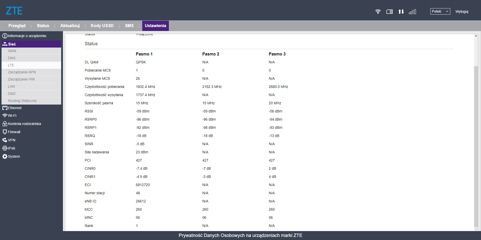

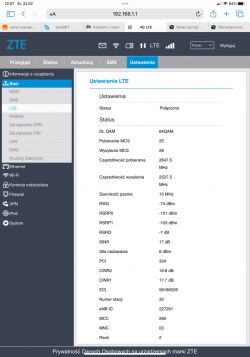

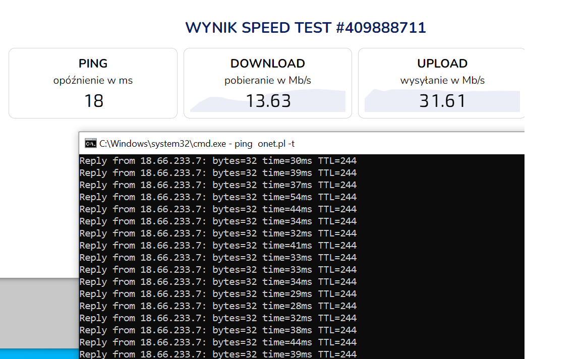

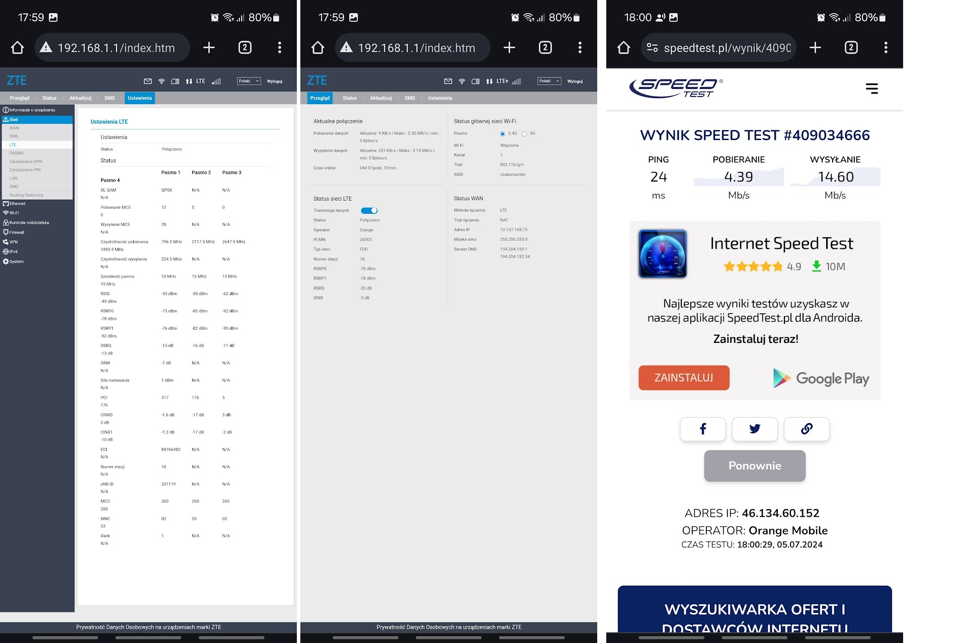

    It's hard to measure anything because these stations change all the time. The first time I set it up I caught the best range on station 27 and there I had a result of 13/33Mbps on the speed-test. Today when I was at the plot the antenna was connected to station 18 and the speed-test showed 4/14Mbps. Please find attached screenshots
    I have a question, are there any such devices where it is possible to set the stations rigidly?
    Screenshots showing ZTE modem configuration and SpeedTest results. Three screenshots showing ZTE router settings and internet speed test results.

    I still wanted to mention the band blocking function itself. From what I have tested, selecting "block bands", a list of bands appears (1,3,7,8,20) and selecting the individual bands with a "tick" (checkbox) does not mean which bands are blocked but which are left for use (the remaining ones without a "tick" remain blocked).
    List of bands distinguished by frequency:
    1 - 2100 MHz
    3 - 1800 MHz
    7 - 2600 MHz
    8 - 900 MHz
    20 - 800 MHz
    I have left bands 1 and 7 for use and then I have the best transfer of 13/31Mbps and next to the LTE icon there is a + sign, i.e. LTE+ (I do not know what this means exactly)
    ZTE configuration panel with LTE settings Screenshot of internet speed test results and CMD window showing ping results.
