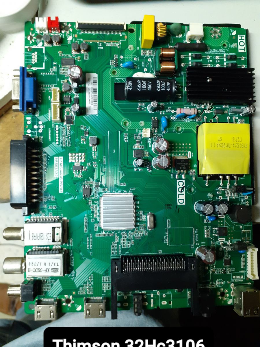

  • Intermittent blue LED startup fault not caused by dump
    #9 19444913
    johndor127
    Posts: 16
    Thanks my friend. Today the TV started normally so I cannot try it, but that’s what it’s doing sometimes it starts up sometimes stuck on Blue LED not switching on.
    John from Malta my WhatsApp number is 0356 99497539 in case you need anything.
    But when it stops I try, your bin it seems like my bin the codes.
    Do you manage to download from the Russian site ?
    https://remont-aud.net/dump/lcd_pdp_tv/thomso...board_tp_ms3463s_pb782_3ms63ax2/256-1-0-99507
    It’s doing the same with your bin so it’s not the bin faulty.
    It’s stuck on blue LED and not powering on.
    Attached find Main board of this TV I need Dump for TV UNITED Model LED29X11. Panel TC290BPE1-MA1Thom 1.jpg (2.82 MB)You must be logged in to download this attachment. I need Dump for TV UNITED Model LED29X11. Panel TC290BPE1-MA1
    Any guess pls ?
