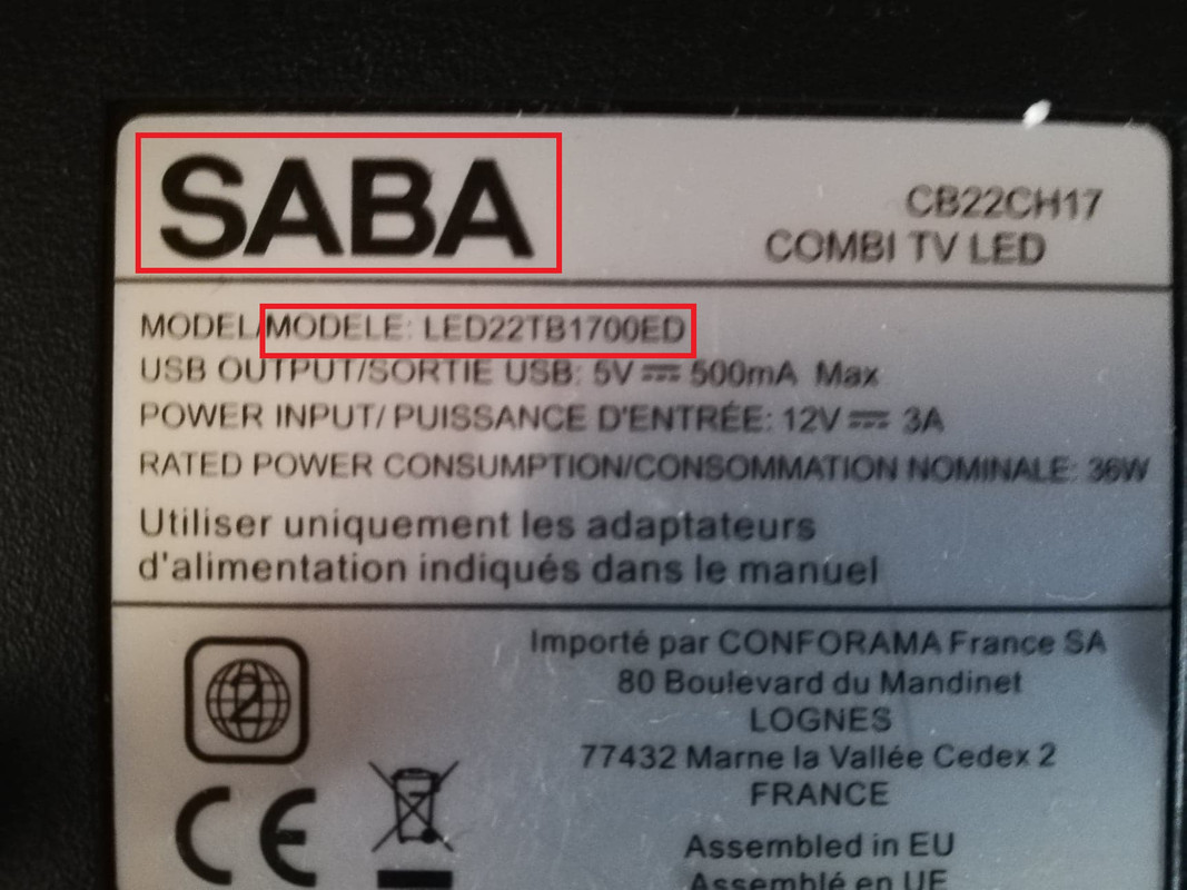

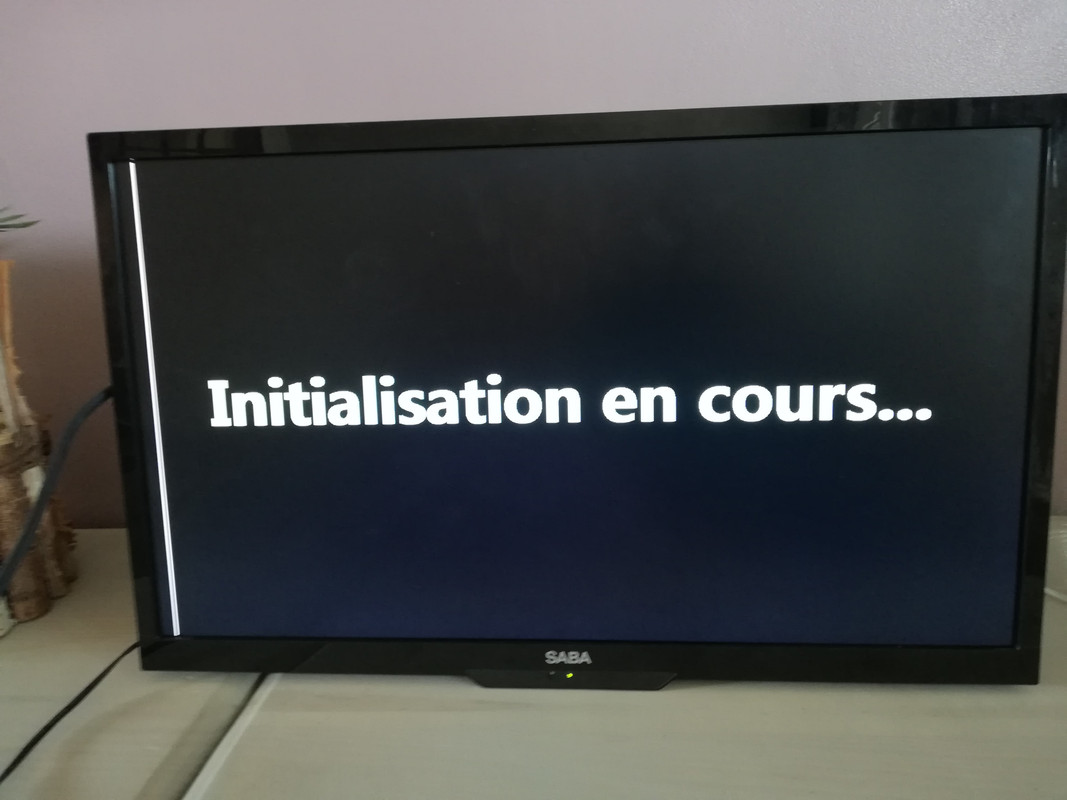

SABA LED22TB1700ED - it just show me a message " instialization en cours &q
medd303 3330 6
  • #1 19737992
    medd303
    please help me to find a firmware for tv SABA LED22TB1700ED
    thanks in advance
    • SABA LED22TB1700ED - it just show me a message " instialization en cours &q SABA-Modele.jpg (149.56 KB) You must be logged in to download this attachment.
    • SABA LED22TB1700ED - it just show me a message " instialization en cours &q initialisation.jpg (90.61 KB) You must be logged in to download this attachment.

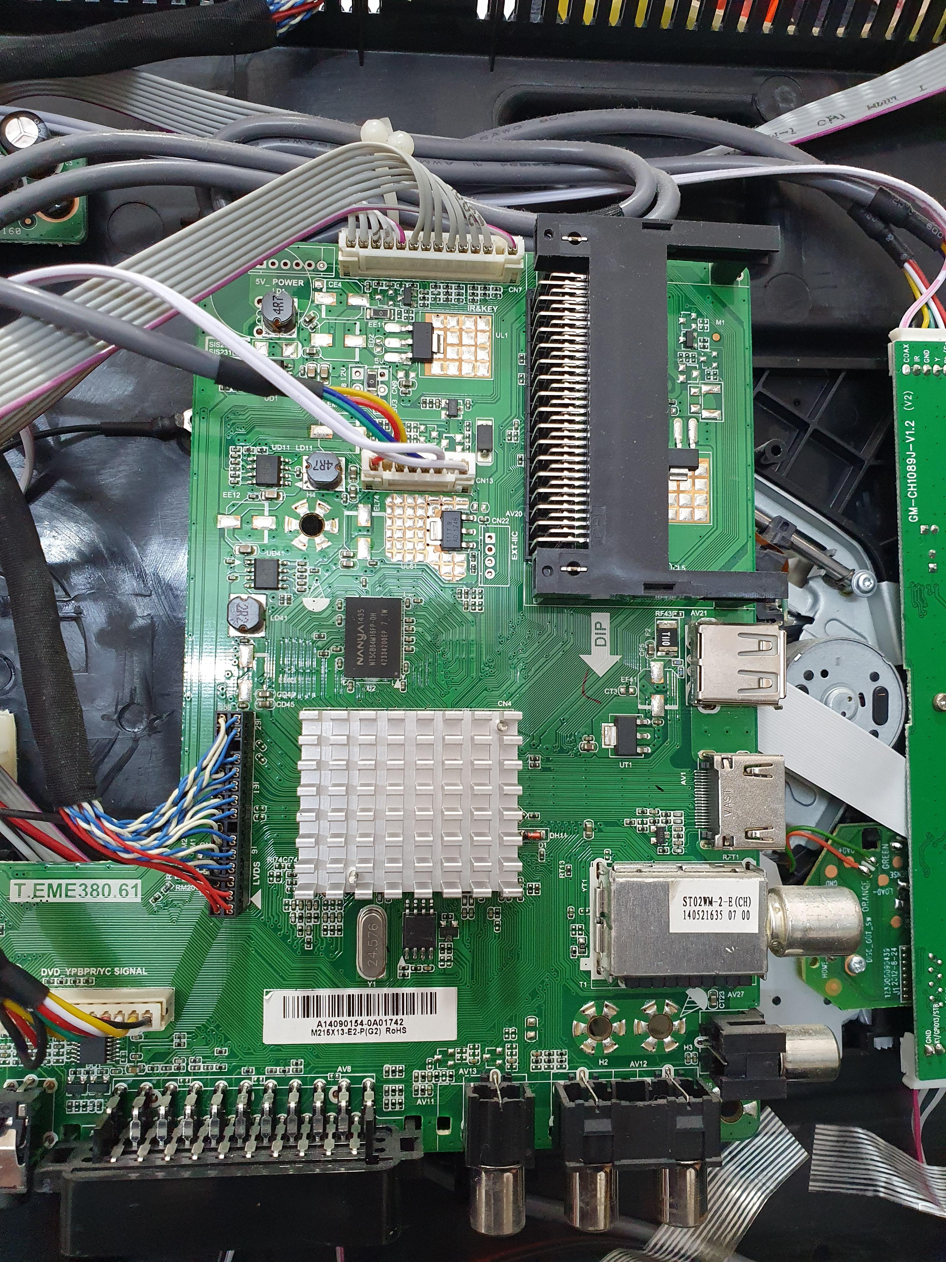

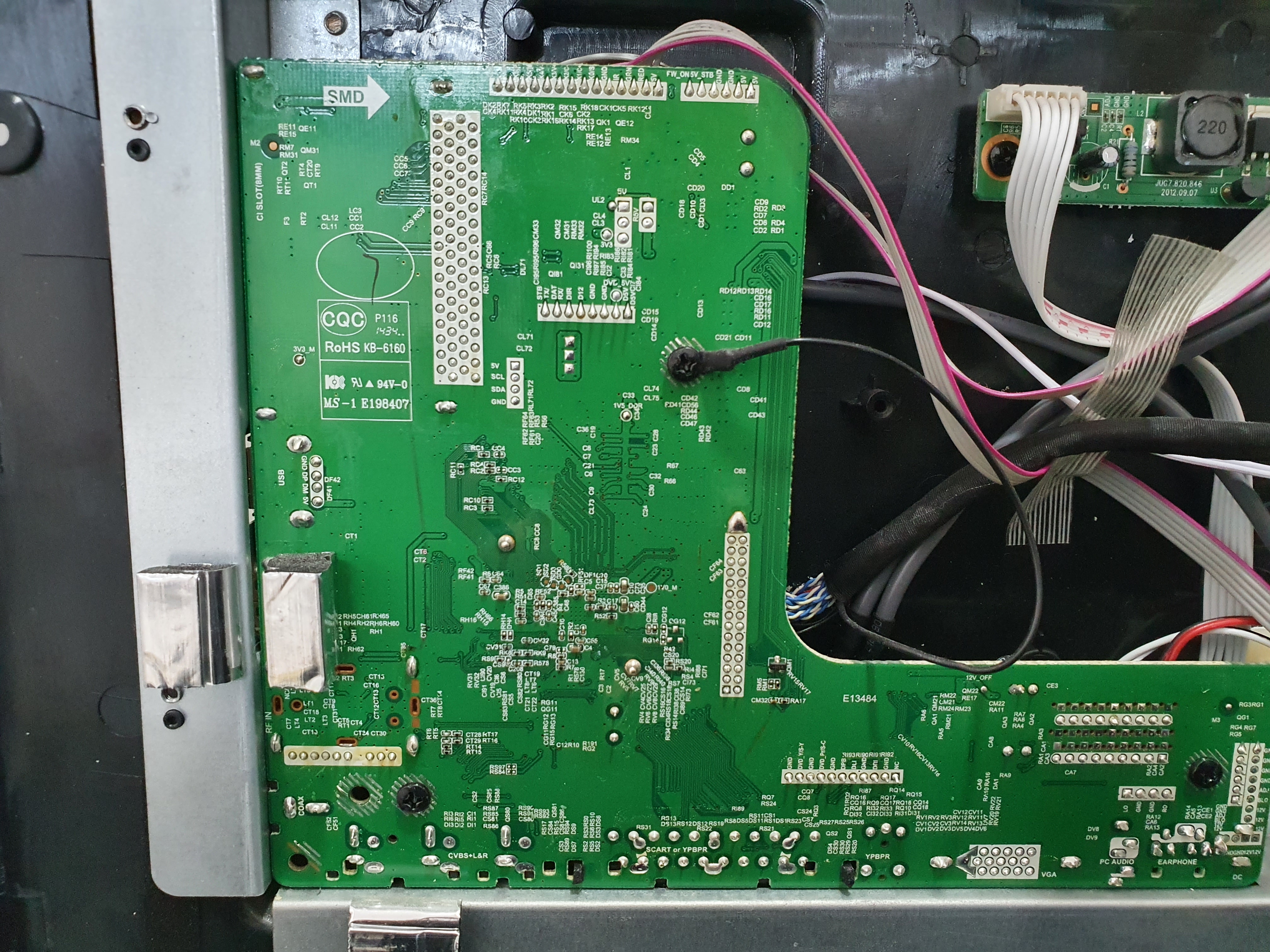

  • #3 19740979
    medd303
    I really not found it, but this the motherboard of this TV
    about serial is: CB22CH17
    • SABA LED22TB1700ED - it just show me a message " instialization en cours &q 20211202_122841.jpg (2.06 MB) You must be logged in to download this attachment.
    • SABA LED22TB1700ED - it just show me a message " instialization en cours &q 20211202_122125.jpg (3.38 MB) You must be logged in to download this attachment.

    #4 19741207
    billobirillo
    Posts: 1136
    Help: 337
    Rate: 791
    main T.EME380.61
    panel M215X13-E2-P(G2)
    try the usb recovery
    copy the file SISEU23X8M.bin on an empty usb stick fat32 formatted
    unplug the power cord
    insert the usb stick and reconnect the power cord
    look at the standby led, at the beginning it flashes slowly, after about 1 minute it doubles the speed: update completed
    unplug the power cord and the usb stick
    reconnect the power cord and turn on the tv: it will start in first installation mode
    if it doesn't work with usb recovery, rewrite the spiflash with the file U5_25Q64.bin (better if you replace it with a new one)
