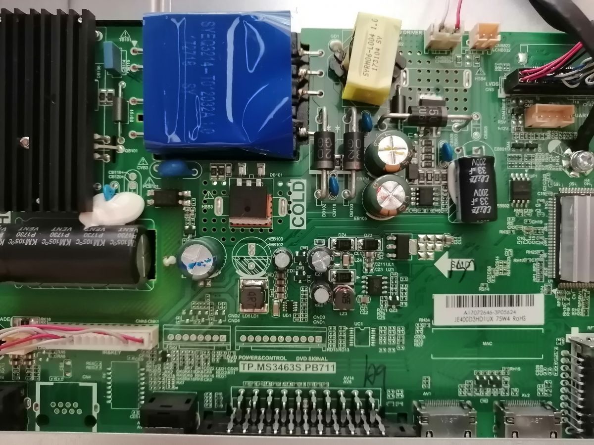

    Hi to all, I hope somebody can help me:
    LCD TV
    brand: sharp
    Model: LC-40FG3242E
    Serial: A40CF3242EB27Z
    chassis: TP.MS3463S.PB711
    display: JE400D3HDIUX
    When I try to switch it on, it starts, loads the sharp logo and starts to load the last input but immediately switches TV off. Also the Led. I need to get off by power wait more minutes and after can I put it back again in the power and try to turn it on.
    Could it be firmware?
    If yes I ask for it :P
    Thank!

    Put the original dump on review.

    Post orig. dump.

    try the usb recovery or replace the spiflash UF1 with a new one
    use this one Link
    fully working also for A40CF3242EB27Z

    memory load uploaded
