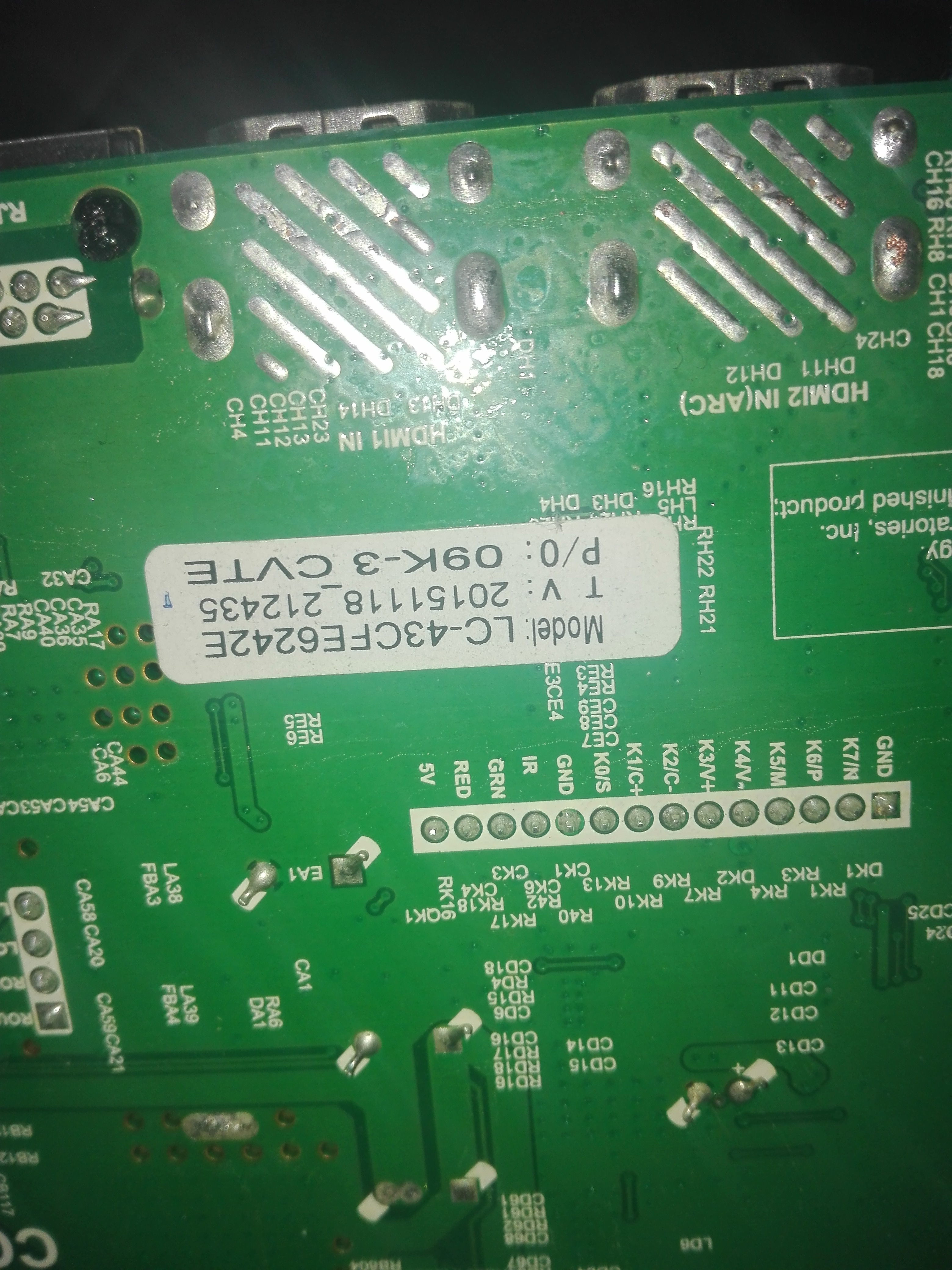

    tv is out after wrong firmware :blinking led status
    Need SHARP TV LC-43CFE6242E Firmware: TP.MS6308.B711, Serial F43CF6242EB09K, LED Blinking

    • Need SHARP TV LC-43CFE6242E Firmware: TP.MS6308.B711, Serial F43CF6242EB09K, LED Blinking IMG_20221229_215643.jpg (3.32 MB) You must be logged in to download this attachment.
  • USB update attempt leaves screen blank and blinking LED
    #5 20360951
    mekademi20001
    Posts: 8
    hello
    thank you for your help
    i fat formatted usb driver put all files in it, and put in the usb port of tv then put the ac cord
    the led of tv becomes green the lcd screen lightens dark without any data and nothing happened i tried some usb drivers and tried with holding power on of tv for a long time but nothing
    before the wrong software tv was working perfectly now only blinking led red then green continuously

    #6 20364638
    mekademi20001
    Posts: 8
    hello
    i will share the last issues with my sharp tv
    as tv did not accept any software i tried with secureCRT and putty with this command "usb_bin_check" with usb drive in the port of tv and with software sent by elmo071 and billobirillo... after checking ok i disconnect ac wait few seconds then plug in cord without hitting enter of keyboard
    the update begin(the lcd screen show upgrading process) the upgrade is successfully but tv shows logo SHARP and restarts i tried the two software sent to me i got same result the other one given by querij is not working shows error in upgrading
    is there any suggestion or solution to bypass this loop

  • #12 20652239
    mekademi20001
    Posts: 8
    Sorry tv was had been repaired by changing new nand originally programmed and now i've no more this set in hands
  • #13 20652244
    mekademi20001
    Posts: 8
    I ordered one flash NAND originally programmed and problem solved
