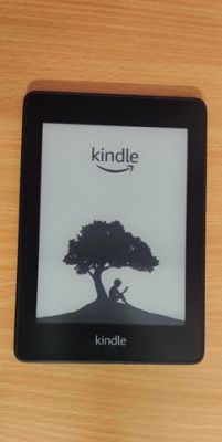

    Reader same as other Kindle Paperwhite 4.
    Now it hangs on the screen without responding to the button.
    Photo from the net.

    I opened it with guitar picks (it opens relatively easily). I disconnected the battery, waited and reconnected. No success - all the time "boy under the tree" on the screen.
    I disconnected the battery again, connected it to the RPI power supply and reconnected the battery - now the display shows the battery with an exclamation mark.
    Added after 18 [minutes]:
    After a while, the "boy under the tree" is on the display again.

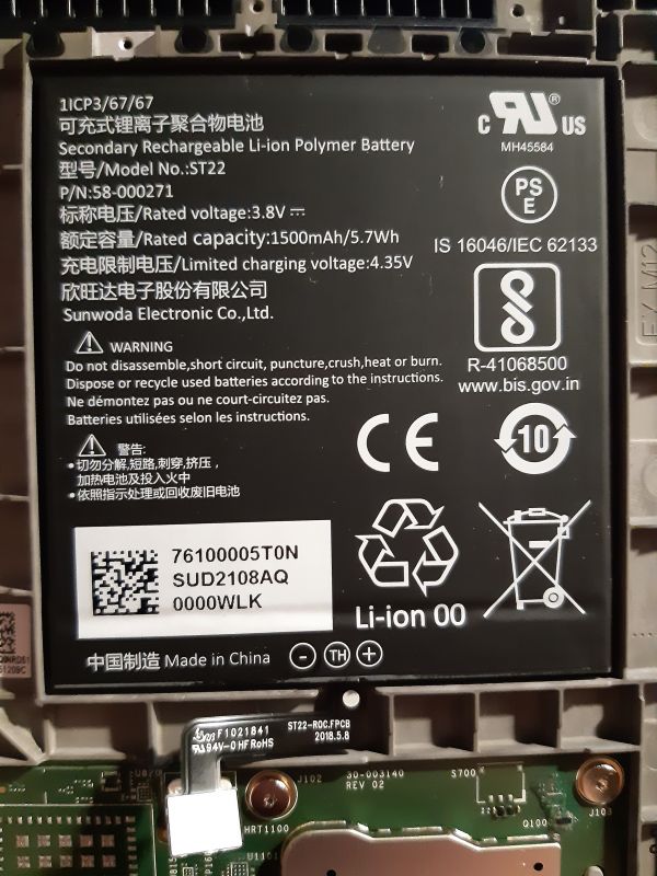

    I bet on a damaged battery. If you have a multimeter, you can check the voltage after disconnecting the battery. A fully charged battery should be 4.2V.
  • #15 19490828
    gervee
    Automation specialist
    Posts: 1077
    Help: 100
    Rate: 94
    The battery is 4.0 volts - just checked.
    It looks like in the picture
    So far I have not found any replacements, but is it dead?

    Since it has the 4V, it is functional. Check if you can upload the update. Does the PC detect anything after plugging the reader into USB? The battery also has a TH temperature sensor. You can check it what resistance it has, if I remember, between GND (-) and TH. Sometimes, but I do not know if in this case the sensor is damaged and the system can read that, for example, the battery temperature is outside the norm and disable the start of the system.
    There is no Reset type mark on the disc. Send a photo of the motherboard.
