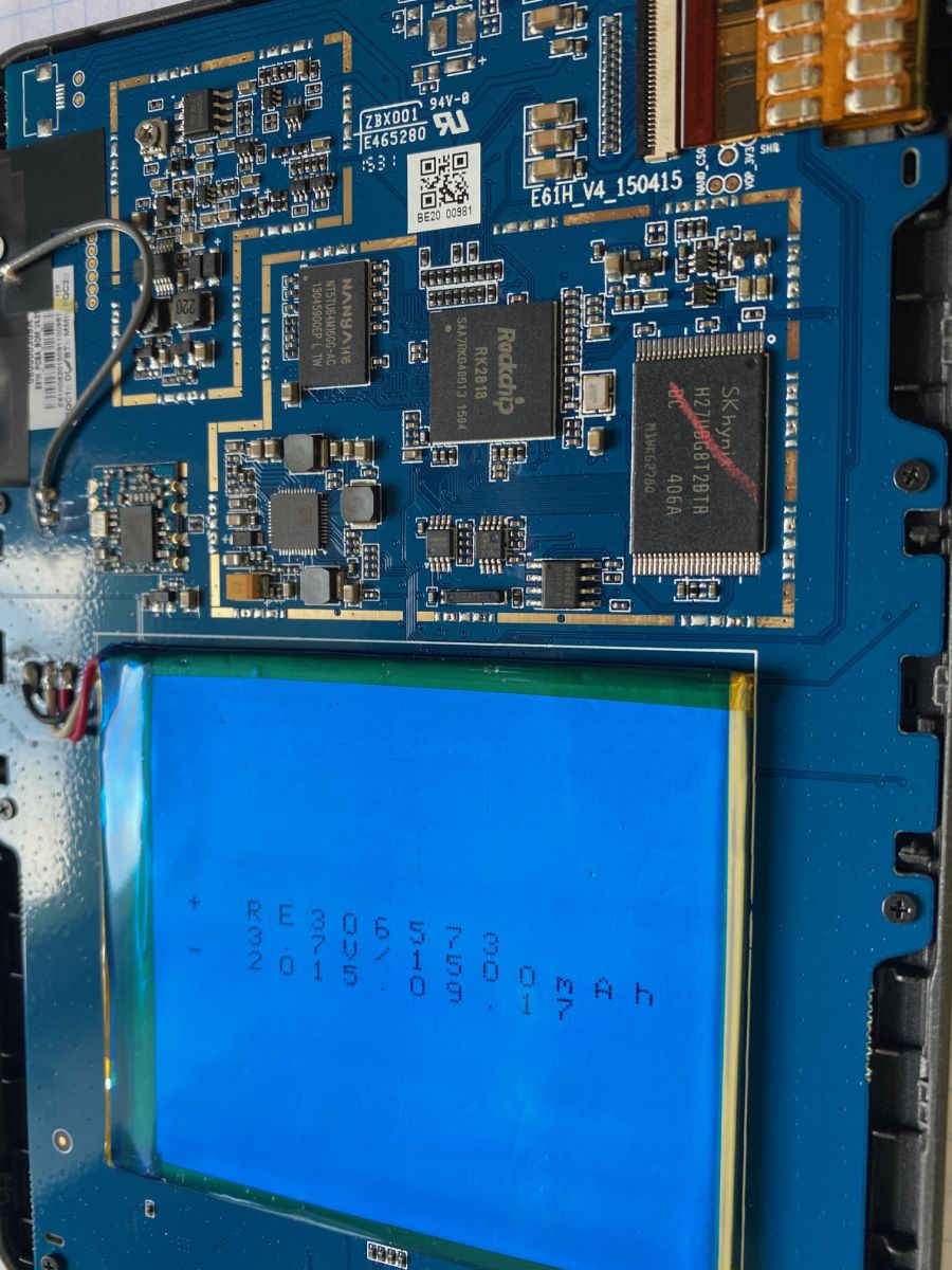

    Hi,
    I have such a problem that my InkBook Classic reader just won't turn on. When I connect it to the power supply - the green LED lights up and the screen changes as if the reader is turning on (but without the charging icon). No connection to an external power supply - no reaction. Likewise, no response to the reset.
    Any advice?

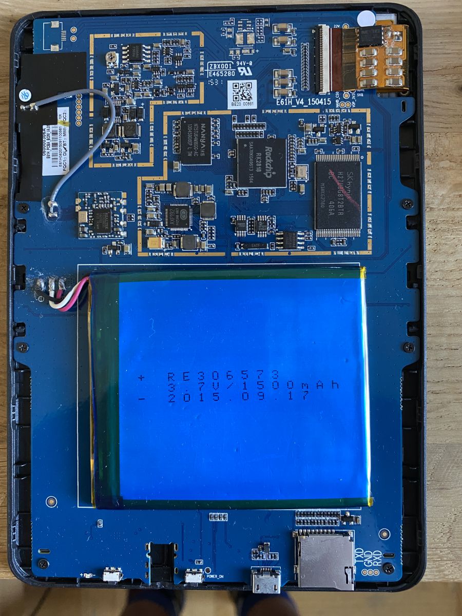

    Yes - I opened it, but I haven't measured it yet. I will do it tomorrow because I have no equipment in Krakow. "The battery can be operational, it just needs to be brought to life" - how? I was charging it for over 24 hours.
    This is what it looks like inside:

    Measure the battery voltage with and without connected charger.
    Connect the charger e.g. for an hour and then, while measuring the voltage all the time, disconnect the charger and see if the voltage drops.
    RE306573 is a type of battery and its dimensions are: 3.0 x 65 x 73 mm.
    yofi18 wrote:
    Probably he will go to the hasiok, because I will probably not buy such a battery anywhere.
    If you throw it away, I will gladly take it for a poor friend who learns "electronics" :) I already gave him this type of "hasiok" and he was very pleased.
    He just isn't afraid of damaging something more :) So far, the recovery is ~ 5%, but for him it is a lot. :D

    The battery is 5 years old so it's not that old. Desolder it Red is + and black - White is probably a temperature sensor, do not connect anything under it. If you have a meter and you are able to check the voltage on this battery, check and enter the value indicated by the meter. If below 3V, the protection electronics will not start charging, you would have to connect the cell with the protection electronics to the charging voltage of 4.2V, but 3.7V will also be ok. how much the rest is operational. Your friend Freddy has already given you the dimensions of the batteries.
    New battery "Li-Po, Li-Poly 1500mAh 3.7V 3-wire battery" alledrogo .

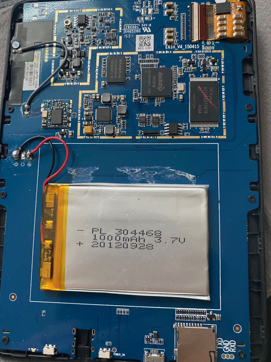

    I have the following problem. I have replaced the battery in my InkBook Classic reader. From 1500mAh I replaced it with a new 1000mAh. And, unfortunately, there was such a problem that:
    1) the battery is charging very slowly
    2) the maximum level of charge reached perhaps 48%. Usually it is around 39%. Even after 12-18 hours of charging.
    What may be the problem? I measured the battery - the device showed 3.70. I also checked the charging socket and the result is about 5 there.
    Thanks for the help!

    Show me this new battery. I hope you didn't throw out the old one? Have you checked charging on a different USB cable or a different charger?
  • #25 19218829
    yofi18
    Posts: 24
    Rate: 9
    Oh, unfortunately I fired. I tried on a different cable - there are some that do not charge at all, but I have one that charges. I also tried various chargers - from iPhone to Alcatel. I just don't know what power they have. I also tried through the computer. As for the battery:

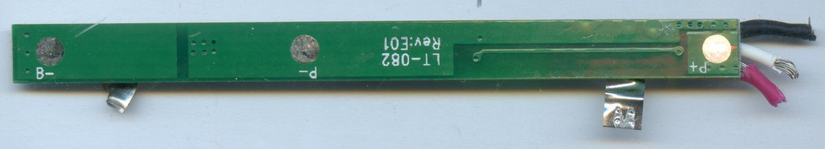

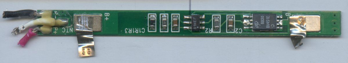

    As a colleague Freddy wrote, you could transfer the electronics from the old battery to a new cell with the third wire from the NTC temperature sensor (thermistor). The charging system may have required this sensor to control the charging temperature. The lack of this sensor may cause charging problems, i.e. charging takes place but with a very low current.
    InkBook Classic Reader Won't Turn On: No Response to Reset, Green LED On - Need Advice InkBook Classic Reader Won't Turn On: No Response to Reset, Green LED On - Need Advice
    I don't know what resistance the thermistor had at room temperature.

    I'm not 100% sure, but something reminds me that the thermistor had 50K Ohm. If you have such a resistor at hand, you can solder it between the center pin and GND (-) ground for tests and see if the charging starts. If you don't have one, you can buy such a 50KOhm thermistor in some store

    I see. Maybe I will ask a stupid question, but unfortunately I do not understand these topics. Doesn't my current battery have a thermistor to which I could solder the cable? Unfortunately, soldering such a thermistor to a battery is not feasible for me.
    Could there possibly be some other way to charge this battery bypassing this problem?
  • #30 19229391
    gradek83
    Posts: 9105
    Help: 929
    Rate: 2099
    It is about connecting the thermistor as in the photo.
    Electronics may not have it with the current battery, but I'm not sure.
