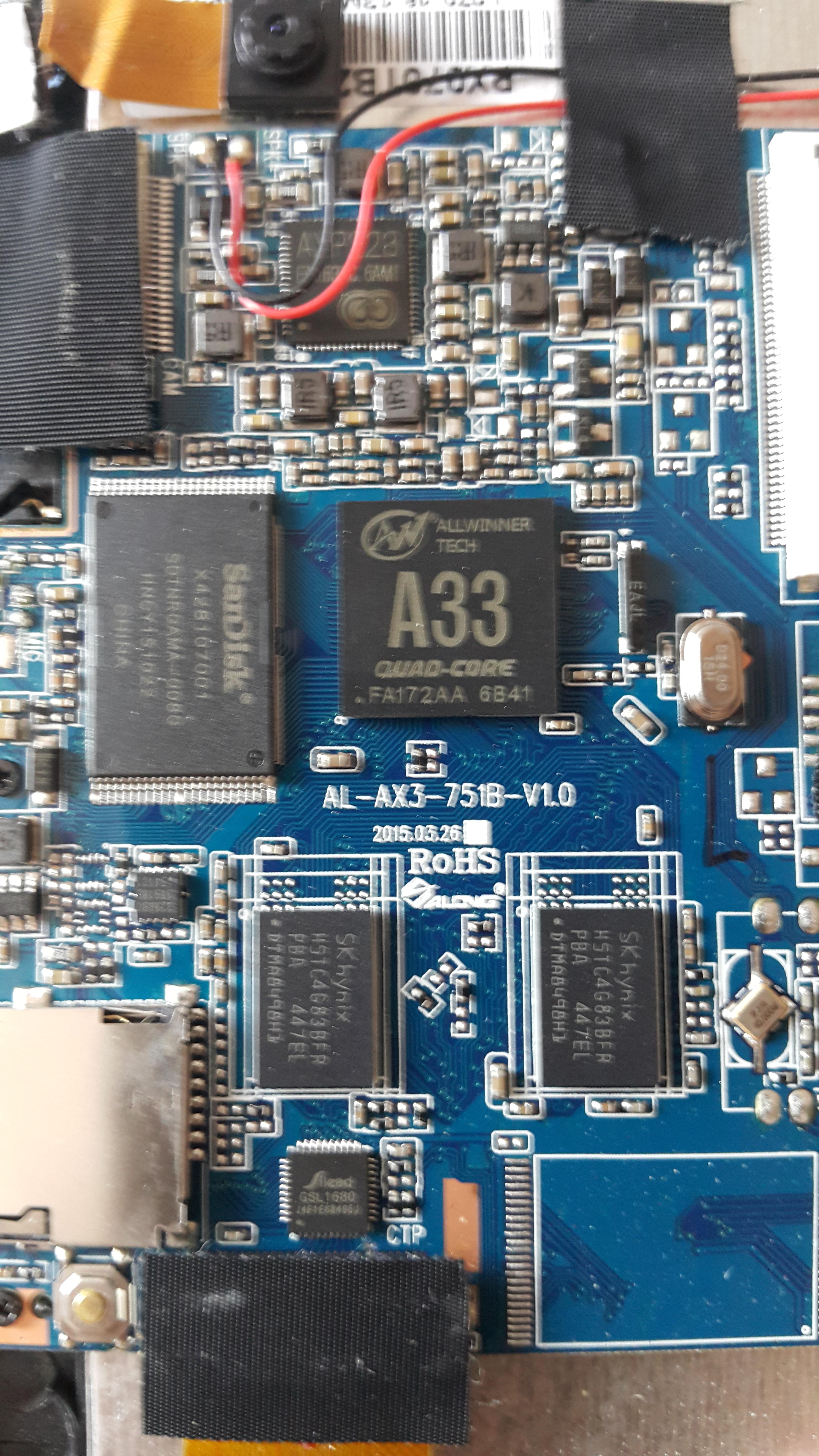

    I am looking for firmware for the kliver Klipad smart i745 tablet. The tablet starts up to the logo, over and over again.
  • #2 16554493
    nutergsm
    Posts: 8429
    Help: 1034
    Rate: 1665
    Take the tablet apart and give the disc markings.
  • #3 16556410
    dzedaj2000
    Posts: 445
    Rate: 37
    • Seeking Kliver Klipad Smart i745 Firmware for Bootloop Issue 20170628_160153.jpg (1.67 MB) You must be logged in to download this attachment.

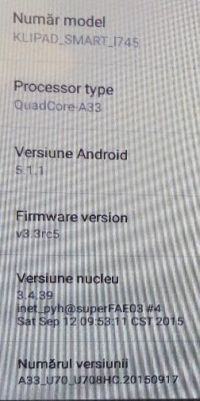

    Here you have additional information
    KLIPAD_SMART_l745
    A33_U70_U708HC.20150917
    build.prop
    Spoiler:

    Possibly Seeking Kliver Klipad Smart i745 Firmware for Bootloop Issue
    LINK
    Direct to file as long as you don't have to log in LINK
    A33_U70_U708HC.20150717
