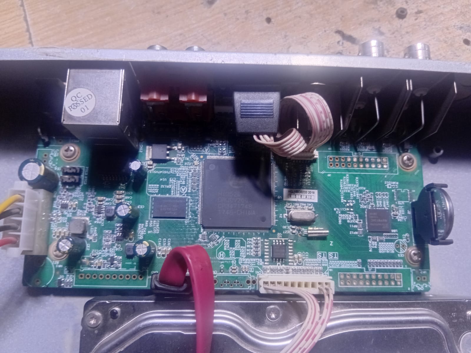

    DrCh3sT3R
    gradek83 wrote:
    To be sure, send a picture of the motherboard.
    https://download.xm030.cn/d/MDAwMDAxNTI=
    Hi Bro ty for the firmware (I'm using another and I suck.. just loading screen no more) I try some time remove bios battery and more more solution I can't repair :-(
    But I send u my board pic now

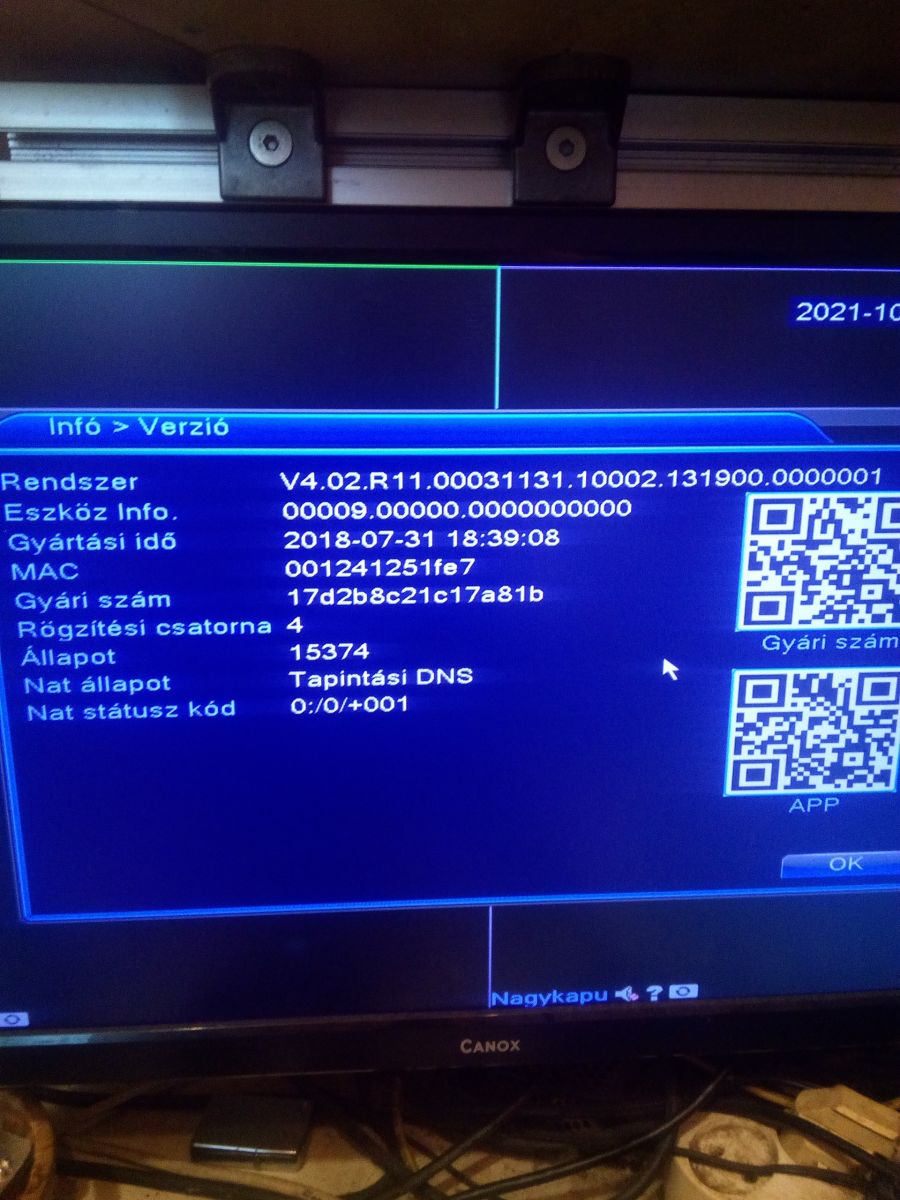

    #4 19643234
    5aeb
    Posts: 7
    Rate: 9
    Hi, this dvr 4ch 700TL bios dump 7804t-lmb setup password: 1957 v4.02.r11.00031131.10002.131900.0000001
    T4-3520D-6134C-ZS V1.01 Firmware Search - Help Needed for CCTV System (20161125) T4-3520D-6134C-ZS V1.01 Firmware Search - Help Needed for CCTV System (20161125)
    • sanyi.BIN (8 MB) You must be logged in to download this attachment.
  • #5 19644000
    5aeb
    Posts: 7
    Rate: 9
    For "4ch t700L" dvr bios damp setup pw: 1957 v4.02.r11-00031131-10002-1319001

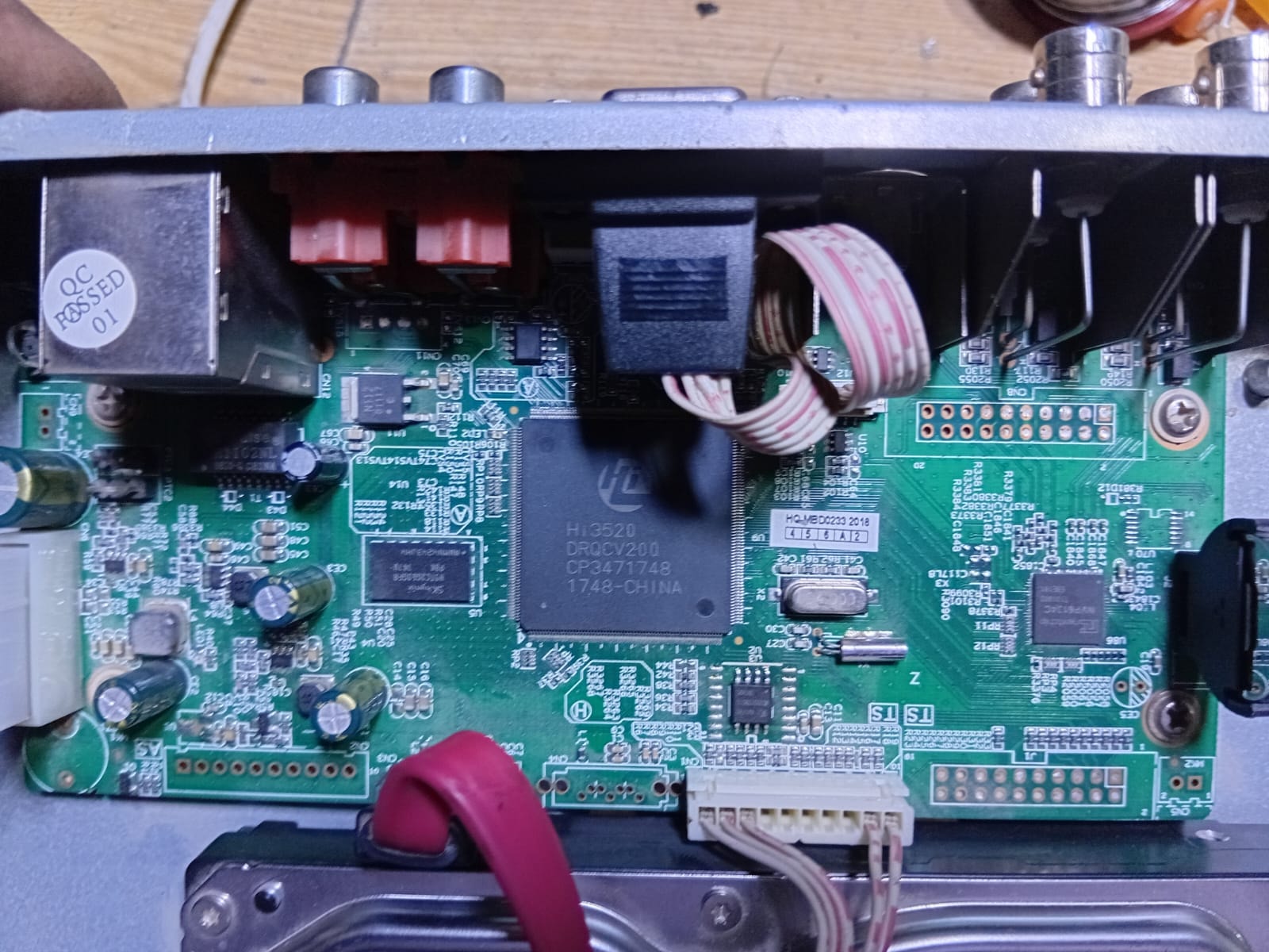

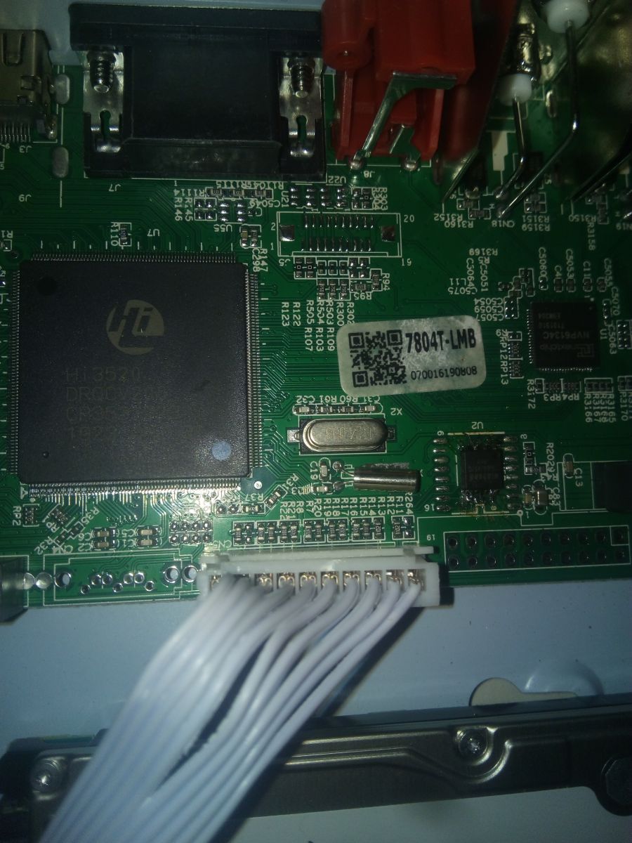

  • #19 21497354
    yousafasher1122
    hi3520 DRQCV200 CP3471748 FILE PLEASE
  • #20 21497440
    gradek83
    Posts: 9106
    Help: 930
    Rate: 2103
    yousafasher1122 wrote:
    hi3520 DRQCV200 CP3471748 PLEASE PLEASE
    Please provide firmware version and photo of motherboard.
  • #21 21510576
    yousafasher1122
    Please provide the firmware version and a picture of the headboard.
    • T4-3520D-6134C-ZS V1.01 Firmware Search - Help Needed for CCTV System (20161125) WhatsApp Image 2025-04-07 at 6.52.23 PM.jpeg (198.43 KB) You must be logged in to download this attachment.
  • #22 21510579
    yousafasher1122
    Please provide the wirmware version and a picture of the headboard.
    4channel software please
  • #23 21510583
    yousafasher1122
    • T4-3520D-6134C-ZS V1.01 Firmware Search - Help Needed for CCTV System (20161125) WhatsApp Image 2025-04-07 at 7.03.22 PM.jpeg (253.74 KB) You must be logged in to download this attachment.
  • #24 21510758
    gradek83
    Posts: 9106
    Help: 930
    Rate: 2103
    Send a Z photo of the motherboard from the other side on this page you cannot see the markings.
