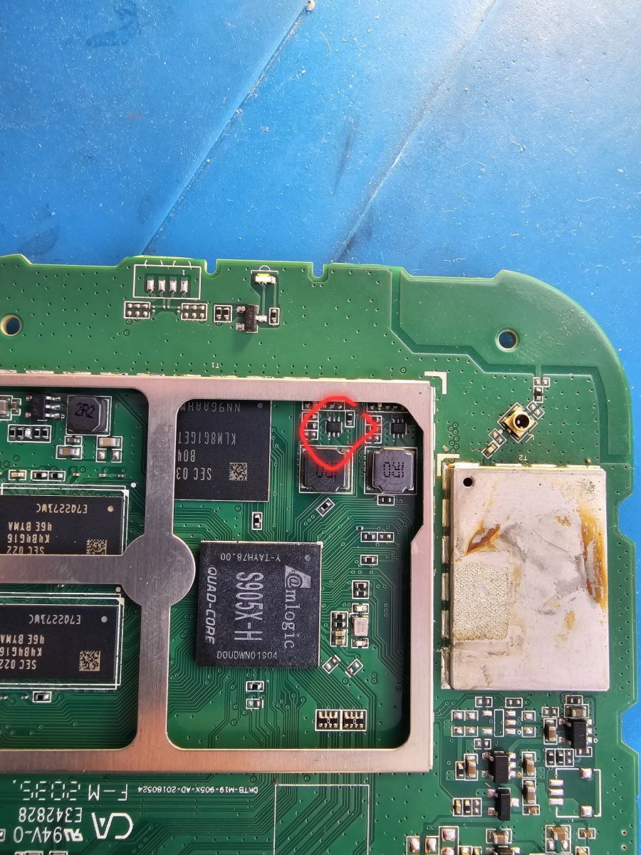

    Hi
    I am curious if anyone can help identify this part. It says on it AVBM 932. It shou
    PCB with Amlogic S905Y chip and a small IC circled in red
    ld be some kind of volt. regulator and should output 1v. Its a mdz-22-ab xiamoi tv box.
    Thx
