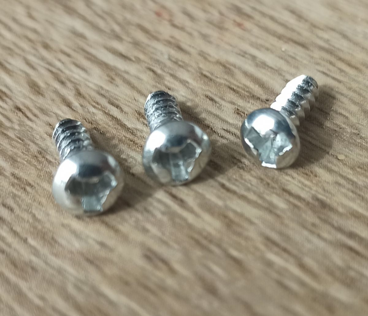

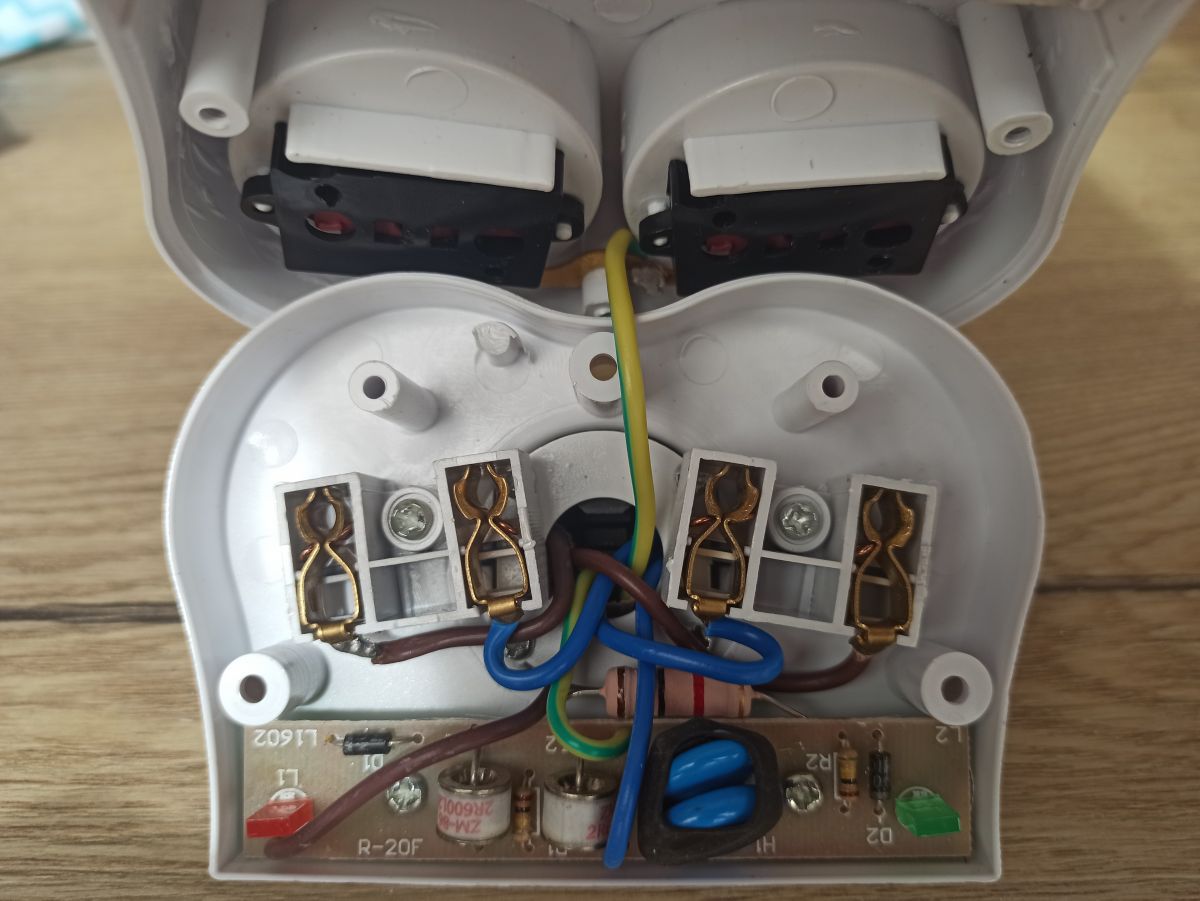

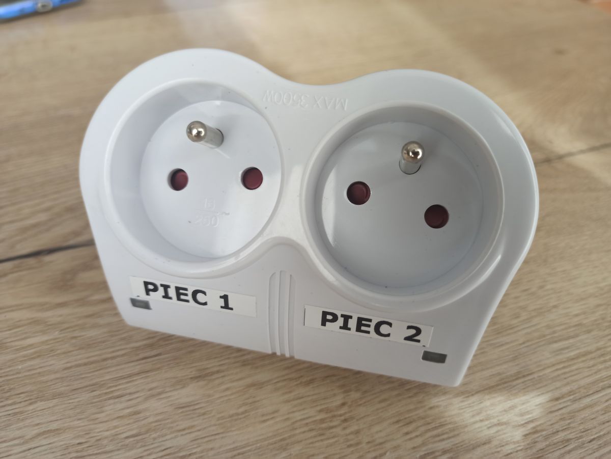

    Hey, I'm going to share my case. I finally bought a Stanley inverter generator. There is a problem with the power supply to the furnace due to phase change. I finished the adapter for Allegro and now it's running nice ?
  • #16 19752057
    sneer
    Posts: 30
    bogut wrote:
    I finished the adapter for allegro and now it's running nice ?
    Good to know, thanks!
    Maybe, for posterity, you could disassemble and take pictures of what's inside and how it's connected?

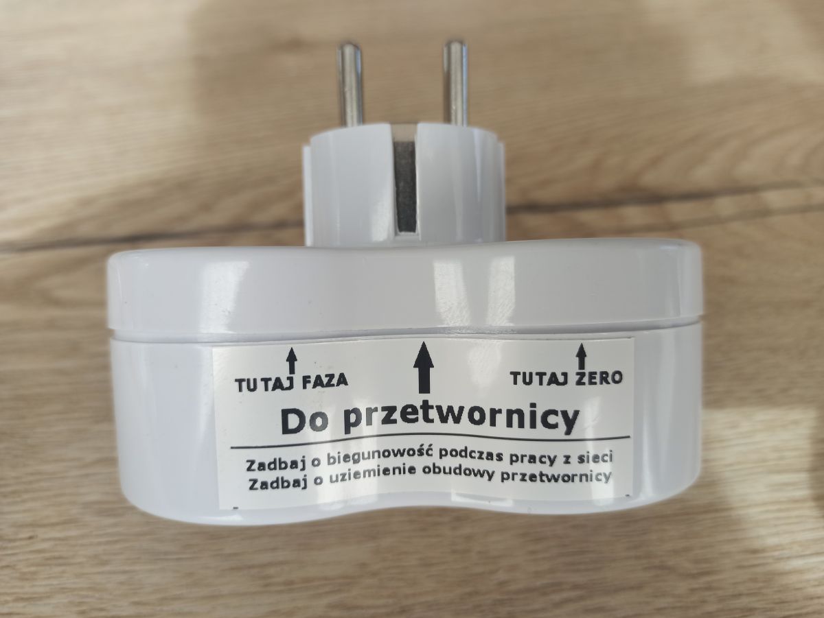

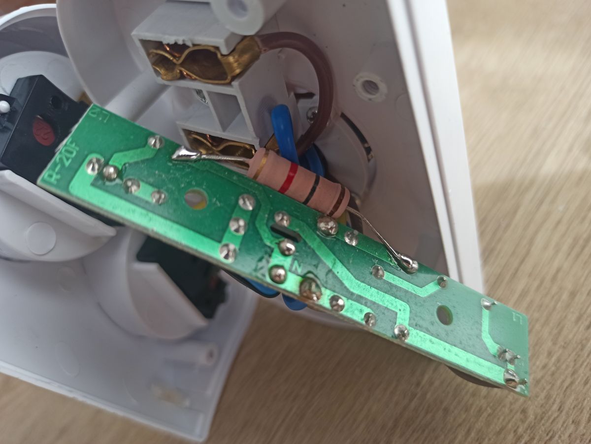

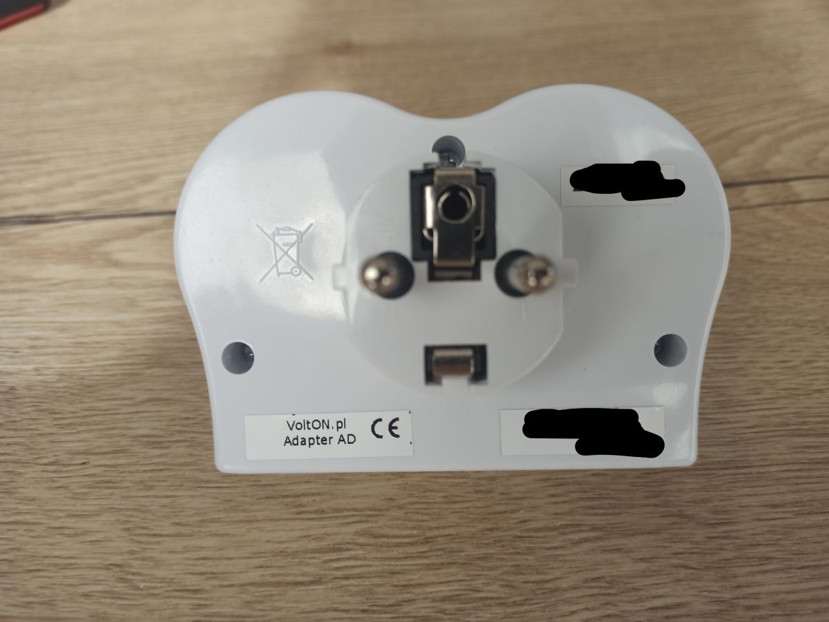

  • #18 19752129
    sneer
    Posts: 30
    This device is most likely just an Elgotech R-20F surge protector covered only by Volton. It caused me to throw out the differential (probably).
    Supposedly it works with UPSs that have a constant phase - Techtrons and Volts from mid-2020 and Kemots after May 2021, but I don't have such equipment, so I wasn't able to confirm.
  • #19 19752153
    bogut
    Posts: 20
    Rate: 10
    I don't know I don't know. The furnace with the aggregate itself did not work with this miracle it works.

  • 1 kΩ resistor between PE and N identified
    #24 20164345
    BorgWarnerT5
    bogut wrote:
    Can't undress.
    "Hold my beer" ;-)
    Asking for an opinion on Fogo F3001is / F4001iSE suitcase units? Asking for an opinion on Fogo F3001is / F4001iSE suitcase units? Asking for an opinion on Fogo F3001is / F4001iSE suitcase units? Asking for an opinion on Fogo F3001is / F4001iSE suitcase units? Asking for an opinion on Fogo F3001is / F4001iSE suitcase units? Asking for an opinion on Fogo F3001is / F4001iSE suitcase units?
    All "magic" is a 1 kOhm resistor between PE and N.

    Yes, and how is the compliance of this adapter with the standards?
    The adapter can be easily inserted into a regular socket.
    In the case of an RCD-protected socket, it will trip. However, in the case of an unprotected socket, this resistor may be powered with mains voltage, which will cause it to dissipate 53 watts of power. However, if it is connected to a socket without a protective contact, or where the protective contact has not been connected, then the user will be exposed to electric shock (current 230 mA).

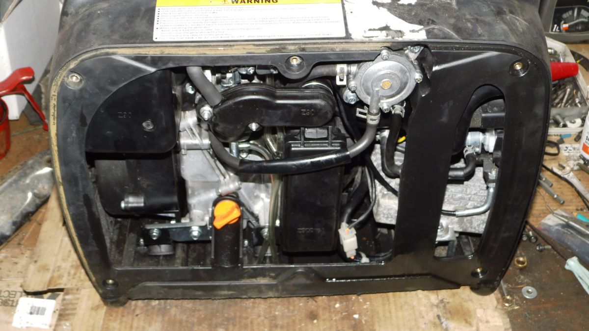

    As for the FOGO generator, I was making a very similar generator to the smaller one, only 1250 VA and Swedish brand. I have no idea what the engine capacity was, probably 50-80 cm? with a decompressor and certainly made in China (here the manufacturer marked the components with stamping). The carburetor (Ruixing) had a throttle controlled by a stepper motor (from the inverter module). The problem with this engine was that the choke cable (connected to the knob from the tap) rubbed a little and the spring on the starting throttle did not pull back well. The result was that the engine smoked a little soot. There was a spark arrestor in the exhaust tip which was clogged with soot + mineral wool from the exhaust muffler, after removing it, the engine started working normally. In addition, the housing is tight, it is inconvenient to service. The alternator at the inverter is a three-phase stator + magnet wheel as in motorcycle engines.
    EDIT:
    I found a photo. I didn't like that fuel hose pinched between the air filter and the housing cover. There was no other way to lead him. Z90 marking on plastics.
