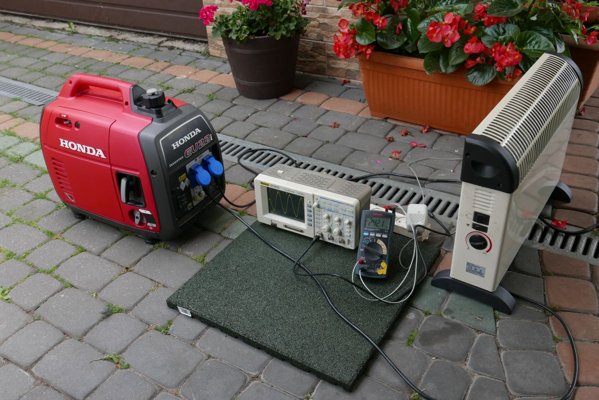

    A Honda at around PLN6000 and an AIVOLT at PLN1099. Honda purchased in early 2020. AIVOLT this month.
    Testing the Honda EU22i generator in a garden setting. AIVOLT SC2300i-0 generator, oscilloscope, and heater on paving stones.

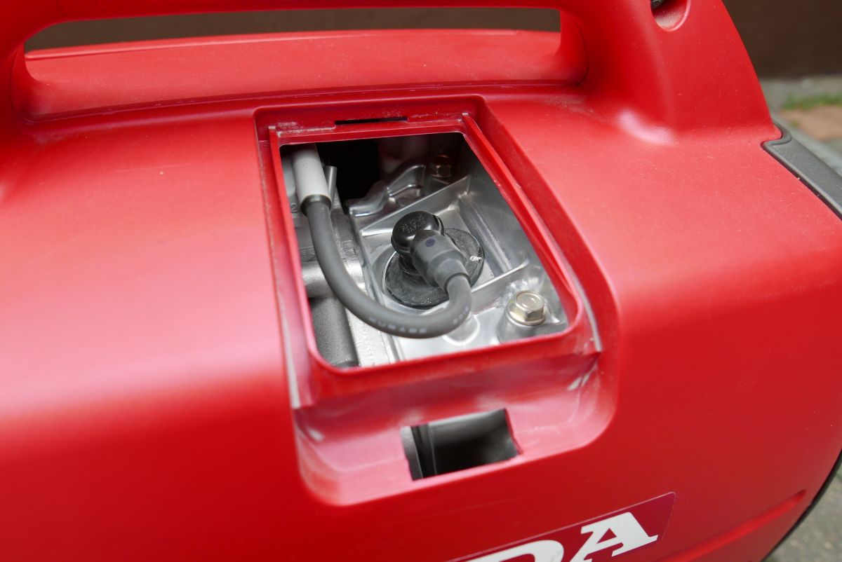

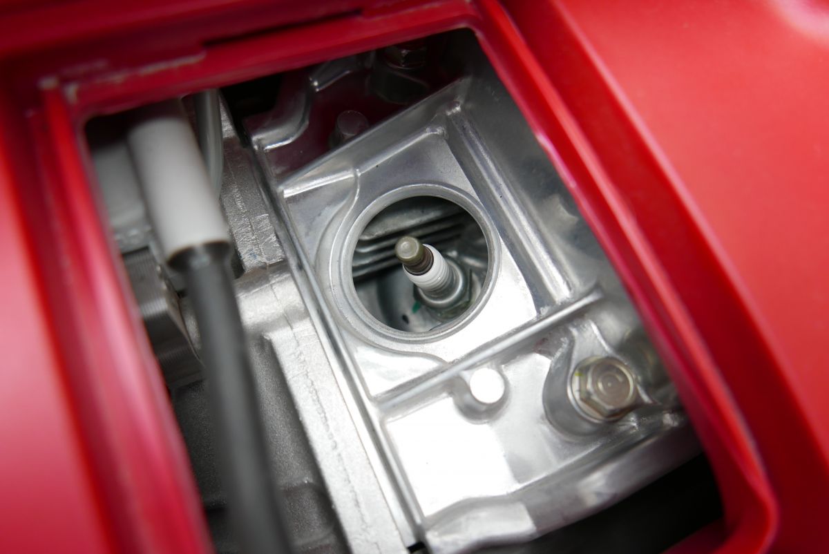

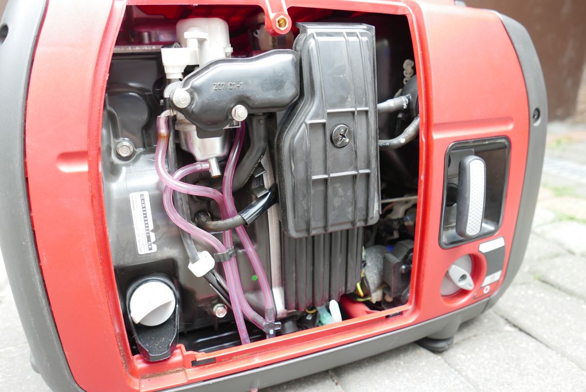

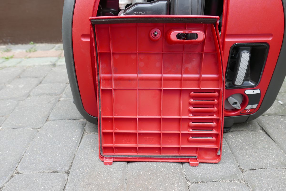

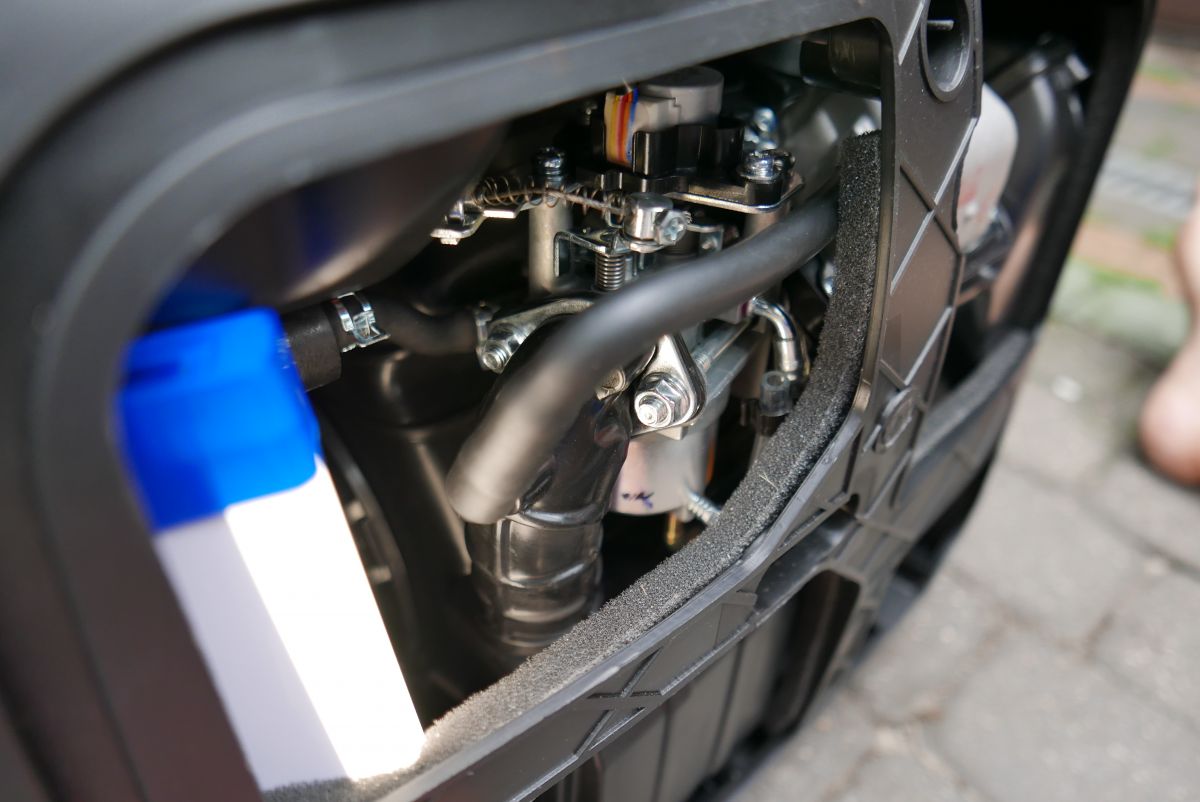

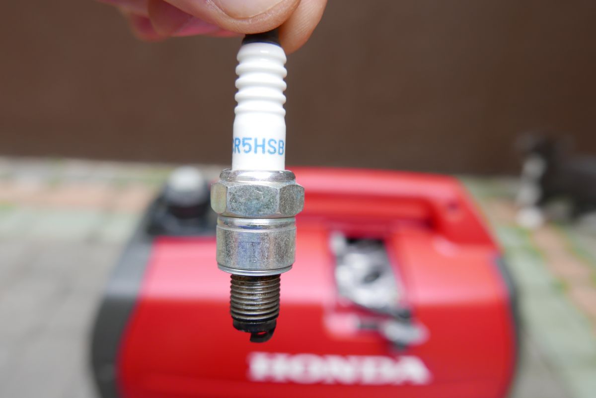

    Easy access to the oil or carburettor. All you need is a 5 penny coin.
    Interior of Honda EU22i generator showing engine components and wires. Photo of an open casing of a red Honda EU22i generator, showing access to the interior.
    Candle (CR5HSB), over 4 years without cleaning.
    Close-up view of the service cover on the Honda EU22i generator. Spark plug inside Honda EU22i generator Close-up of a spark plug from a Honda generator. CR5HSB spark plug held in hand, with Honda generator in the background. CR5HSB spark plug held in hand, with Honda generator in the background.

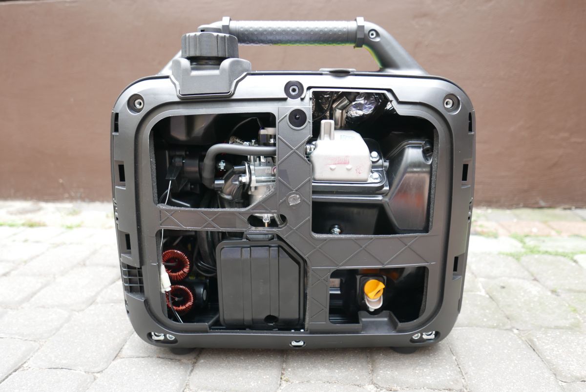

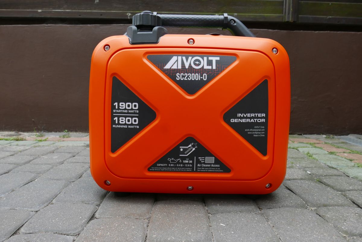

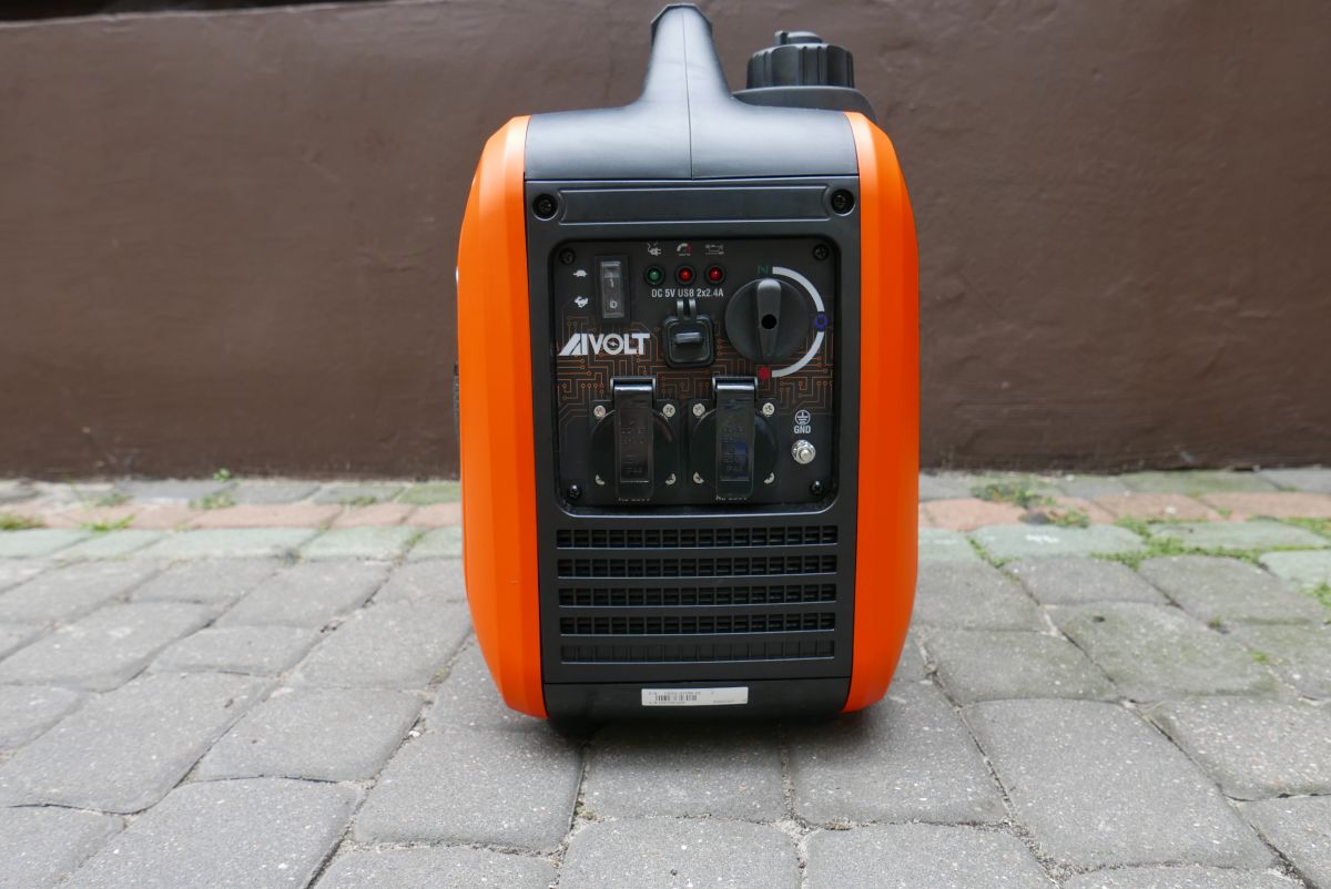

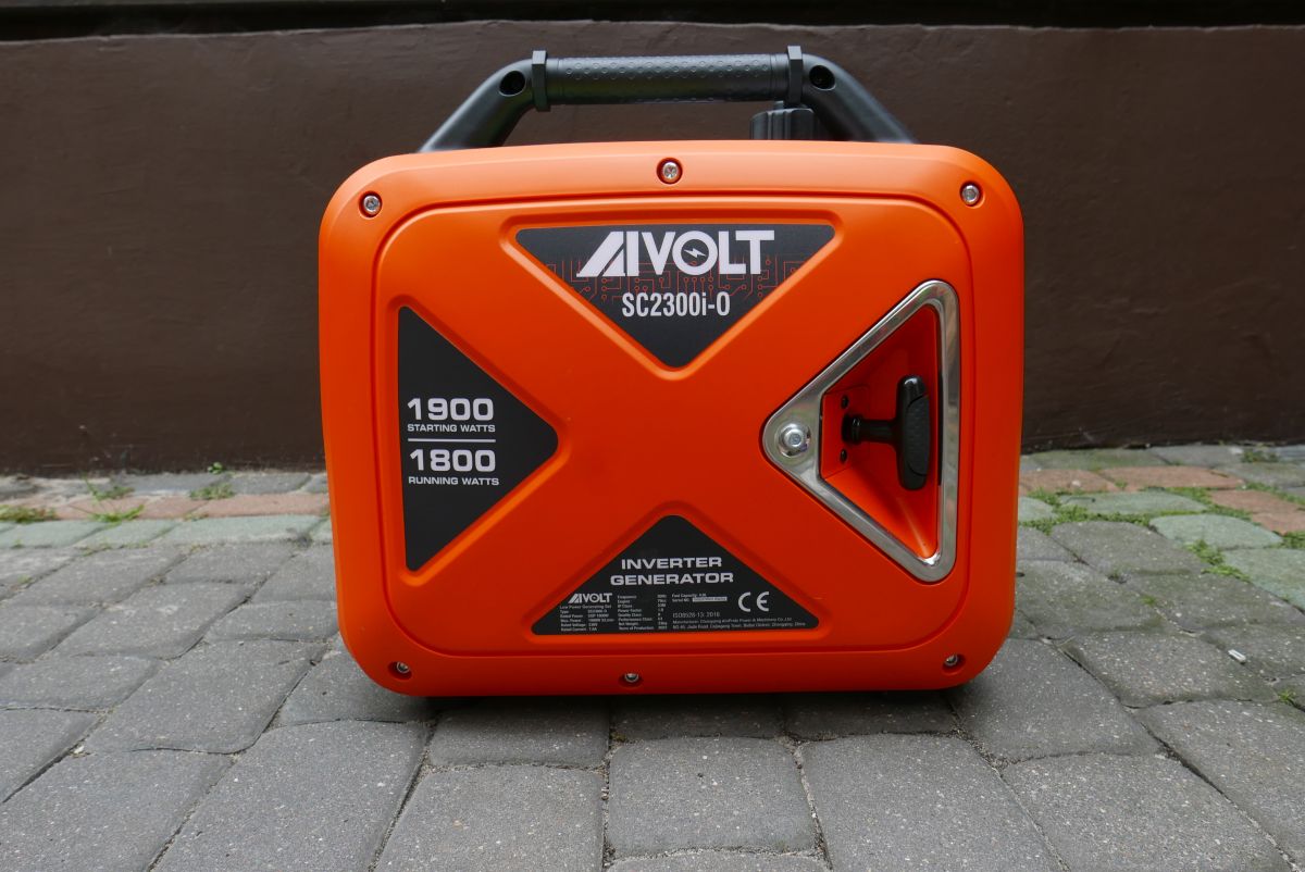

    AIVOLT SC2300i-0:
    Weight without fuel: 19.7 kg.
    Fuel tank capacity: 4 l.
    Engine capacity (SENCI SC80): 79 cm3.
    Rated power: 1.8 kW.
    Instantaneous power: 1,9 kW.
    Orange AIVOLT SC2300i-0 inverter generator on a cobblestone pavement. Portable AIVOLT generator in an orange casing on a cobblestone surface. Orange portable generator by AIVOLT model SC2300i-0. Portable suitcase generator outdoors. Portable suitcase generator outdoors.

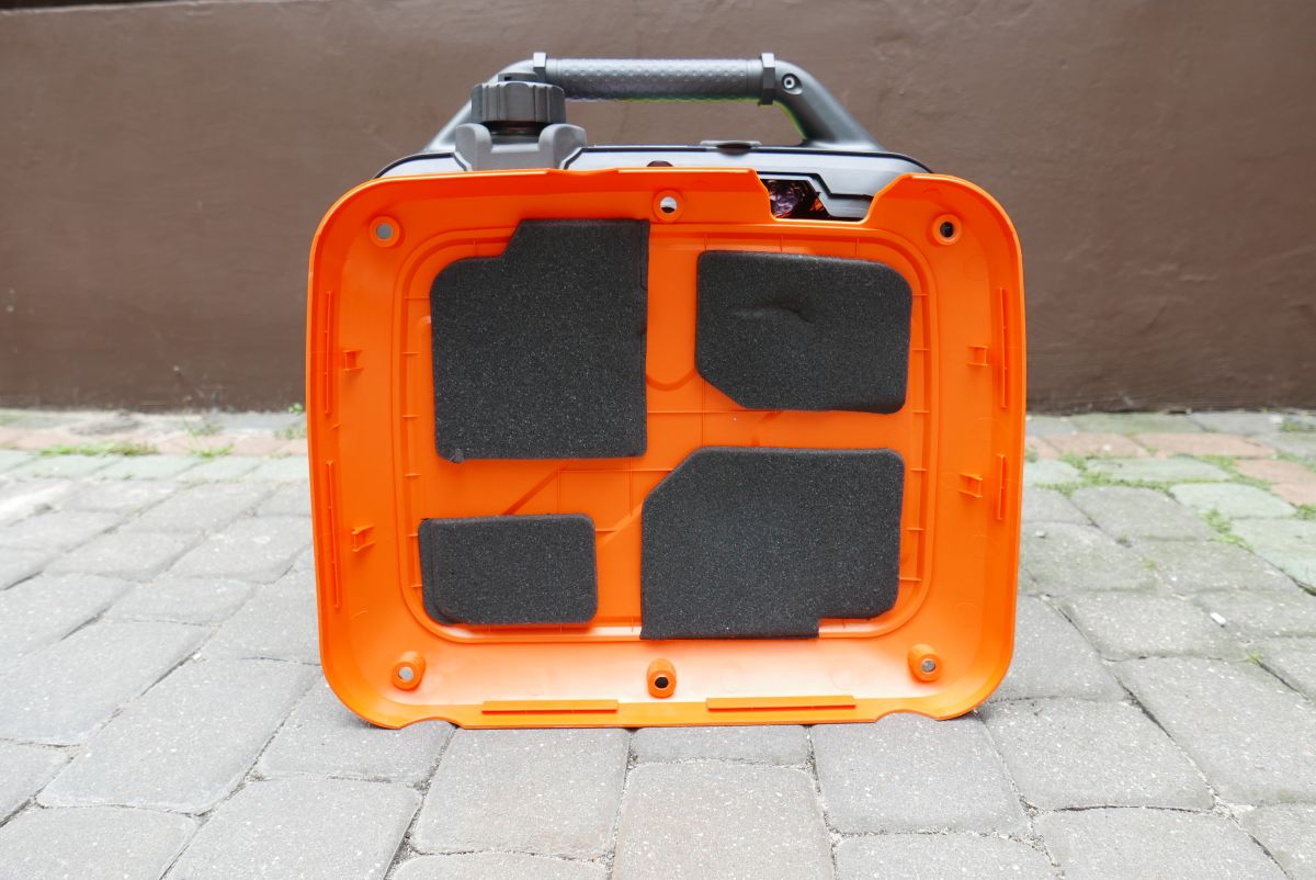

    6 screws to get to the oil or plug.
    Side view of an exposed portable generator. Cover of a portable generator with four attached soundproofing foams.

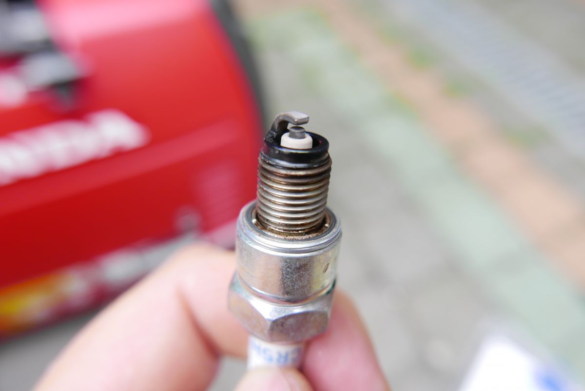

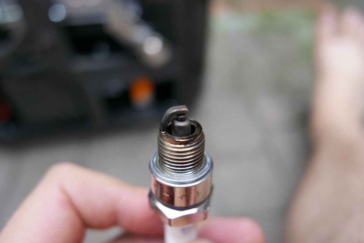

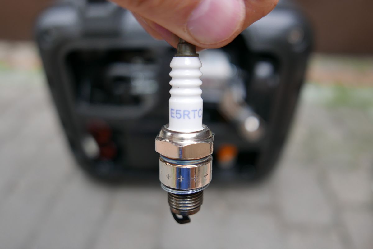

    Candle (E5RTC), 90 minutes running time, 15 minutes after cleaning with wire brush:
    Close-up of a spark plug with dark deposits on the electrode. Close-up of E5RTC spark plug held in hand. .

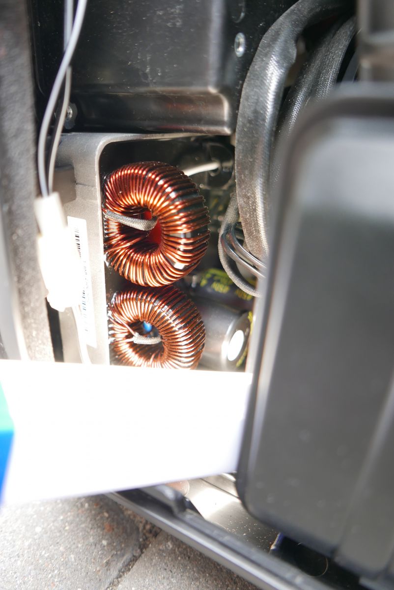

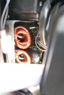

    Inverter:
    Internal view of a generator inverter showing coils and capacitors. Close-up of an inverter component in a generator showing copper coils.

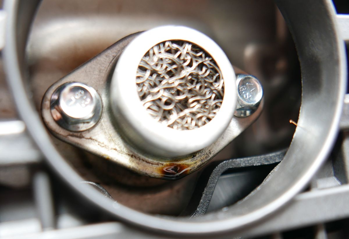

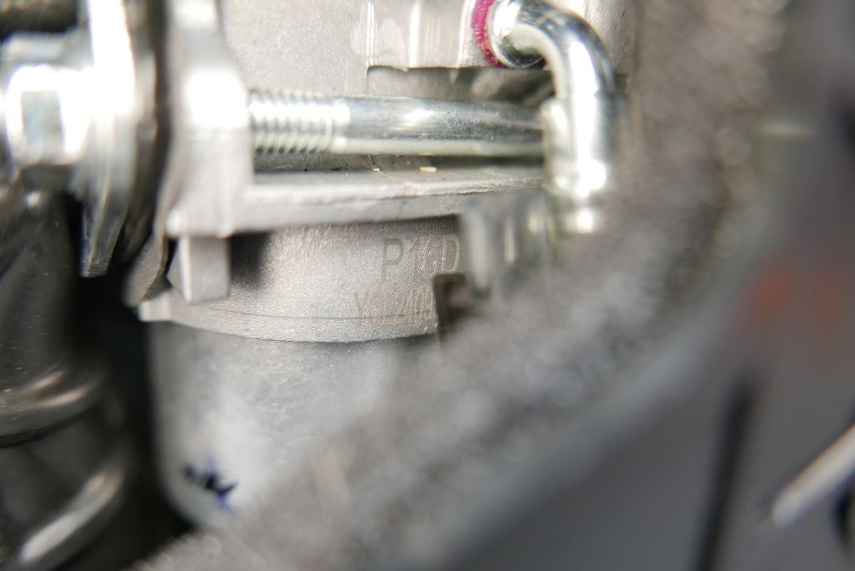

    HUAYI P16D carburettor:
    Close-up of the interior of a suitcase generator showing mechanical components. Close-up of P16D carburetor in the generator.

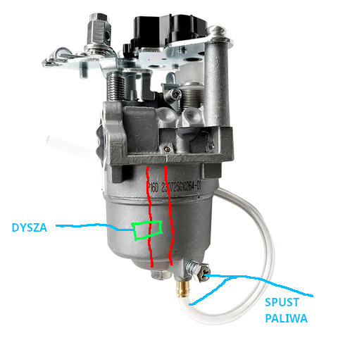

    To remove the carburettor I think you have to unscrew the whole housing. Without this, the fuel tank gets in the way.
    If you are stubborn, you can get to the main nozzle as if something is blocked. You have to unscrew the air intake tube from the filter. This thin black tube can be slid out of the thick one.
    After removing the tubes from underneath, you can unscrew the carburettor bowl. The nozzle will be screwed in from the side.
    Nozzle #70, 4mm diameter.
    Metal carburetor with labeled components: jet and fuel drain .

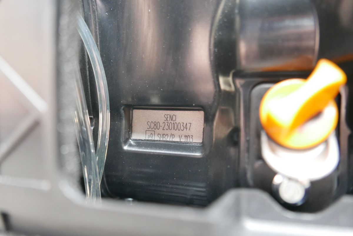

    SENCI SC80 motor:
    Close-up of the nameplate on the SENCI SC80 generator. .

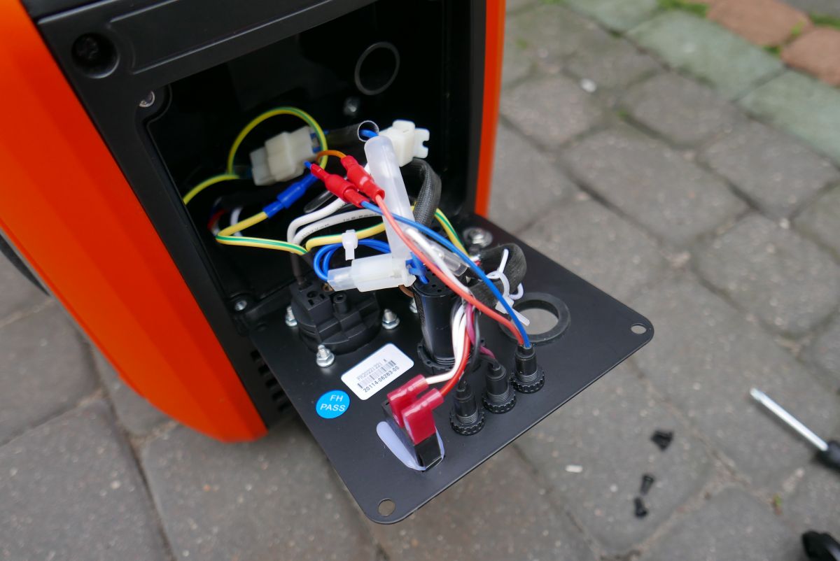

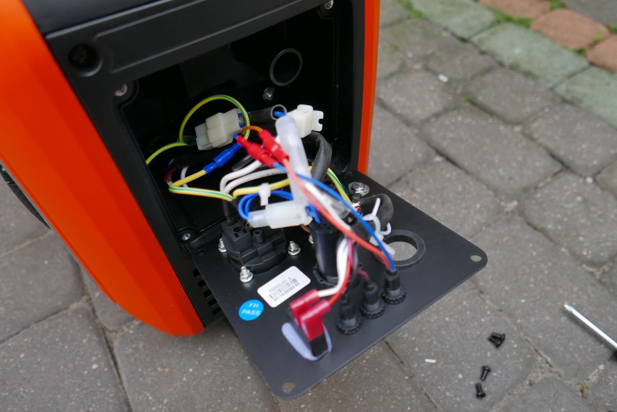

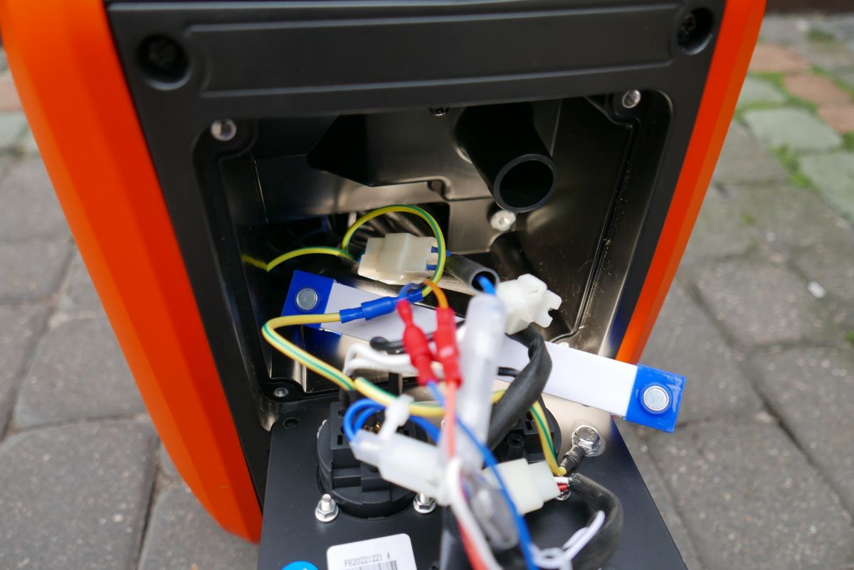

    Front panel:
    Close-up of a generator's front panel with visible wire harness. Front panel of the generator showing wiring and connectors. View of the interior of a portable generator panel with wiring. Interior of a generator with visible wires and connectors. Interior of a generator with visible wires and connectors.

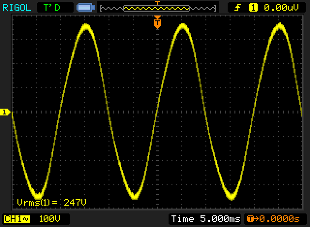

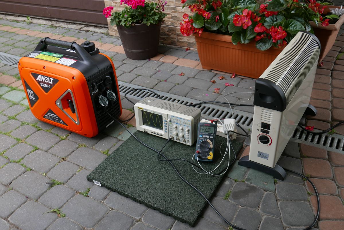

    <spanclass="notranslate"> LOAD TESTS: .
    Load: 700W / 1200W / 1900W heater.
    Fuel: E10, 95 octane
    Oil: 10W30

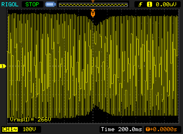

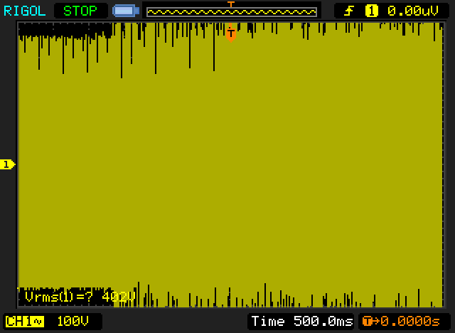

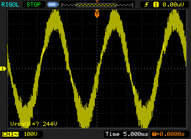

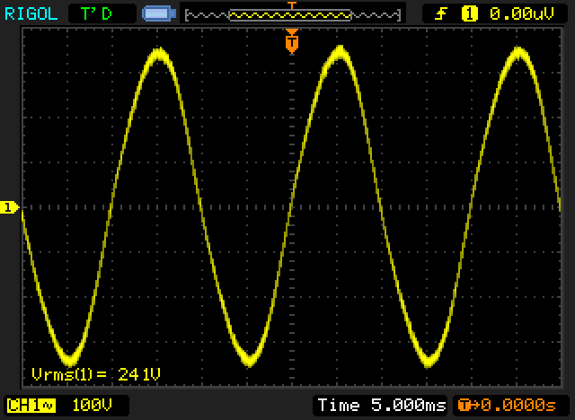

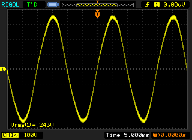

    Due to the lack of a 100x probe, I connected the oscilloscope via a 100:1 transformer (I unwound some coils).

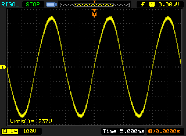

    HONDA EU22i: .
    Load: 0W / 700W / 1200W / 1900W
    Oscilloscope screenshot showing a sinusoidal voltage waveform. Oscilloscope screenshot showing a sinusoidal wave. Oscilloscope displaying a sine wave with 241 V voltage. Yellow sine wave signal graph on a RIGOL oscilloscope. Yellow sine wave signal graph on a RIGOL oscilloscope.

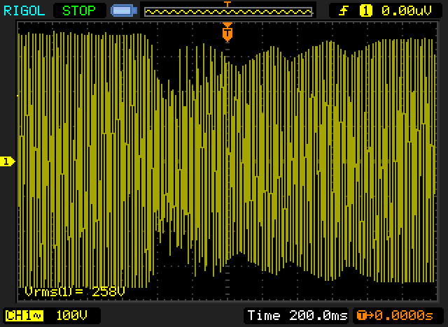

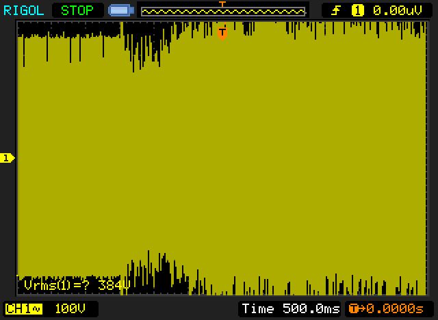

    Switching on 1900W load with Eco mode ON:
    Oscilloscope waveform display of tested electrical signal. Oscilloscope screen displaying unstable voltage waveforms over time. Oscilloscope screen displaying unstable voltage waveforms over time.
    * Ignore the voltage measurement. I forgot to turn it off.
    Switching on 1900W load with Eco mode OFF:
    Oscilloscope screenshot showing a voltage waveform. Oscilloscope screen displaying a voltage signal with many noises and disturbances.

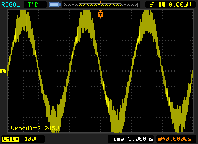

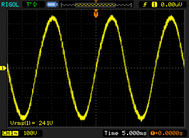

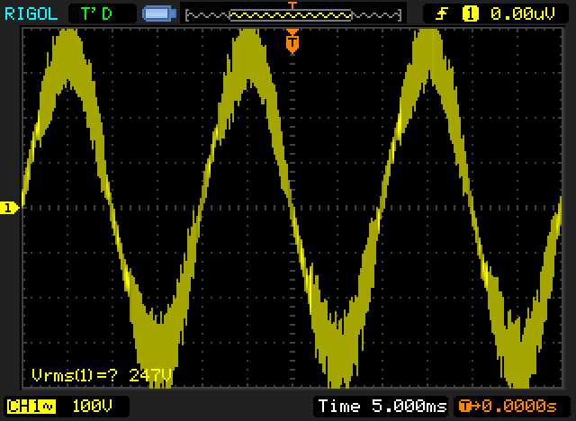

    AIVOLT SC2300i-0:
    Oscilloscope display showing a sinusoidal signal with an RMS voltage of 241V. Oscilloscope displaying a distorted sine wave. Oscilloscope signal graph showing sinusoidal waveforms. Voltage signal waveform from an oscilloscope displaying 244V RMS. Voltage signal waveform from an oscilloscope displaying 244V RMS.

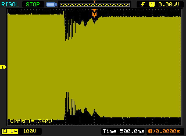

    Switch on load 1900W with Eco mode ON:
    Oscilloscope screenshot showing an unstable signal. Oscilloscope screenshot displaying a sine wave.
    Oscilloscope screen displaying voltage oscillations. Oscilloscope screen capture displaying voltage waveform. Oscilloscope screen capture displaying voltage waveform.

    - it smokes a bit when accelerating, smells of petrol
    - plug goes black after 90 minutes of operation
    - slightly rough running

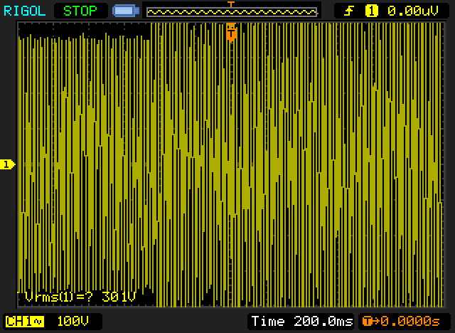

    I have one more question, what are these waveforms? Is it the same as the sine wave from the earlier oscillograms, only a larger time interval is included and the moment of change of the genset inverter load is captured?
  • #5 21131912
    piotr_go
    DIY electronics designer
    Posts: 2905
    Help: 94
    Rate: 3337
    saly wrote:
    Is this the same as the sine wave from the earlier oscillograms, only a larger time interval is included and the moment of change in the genset inverter load is captured?
    Exactly. Two versions with different compression. I have posted so that you can see how big and how long the drop is.
    For the voltage measured by the oscilloscope on these compressed waveforms, pay no attention. I forgot to switch off.

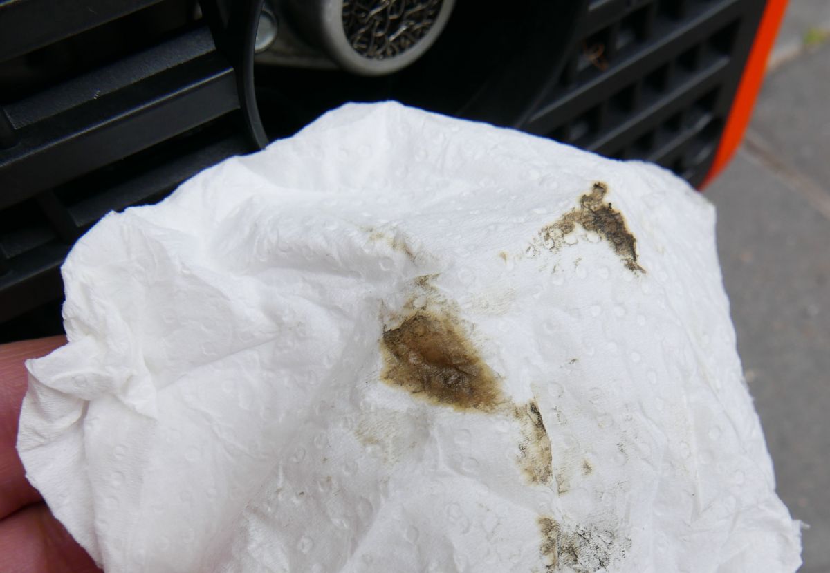

    This Aivolt is somehow too dark, either it takes oil or the carburettor is badly adjusted for a 4T engine. The 80 ccm engine is rather a dedicated piece of equipment for a small obcìążenia. I wonder if Loncin hasn't already copied the Honda generator?
  • #7 21132788
    piotr_go
    Posts: 2905
    Help: 94
    Rate: 3337
    I have not noticed any oil loss so far. Oil colour OK too.
    It seems to me that rather petrol smells too much.
    I've tried with smaller jets, without load it stops kicking, with load the revs float a lot.

    Have you tried changing the spark plug to a branded one, such as a Denso?
    I in a Chinese (branded Stanley with an inverter) replaced the original spark plug with a Denso and it's a completely different unit operation. It ignites more easily and runs more evenly.

    @GUTEK@ wrote:
    Tried changing the spark plug to some brand name, such as Denso?
    Yes, on NGK BPR5HS, did not help.

    Something for something.
    You buy a Honda original and have virtually no problems. You only change the oil and check the air filter and spark plug every now and then.
    Buy a Chinese one and you have some problems right from the start. If you find one, the carburettor should be replaced at the beginning, because the engine doesn't work properly, it floods or stops, the carburettor is wrong for the engine. You don't know how long the engine will last, or whether the alternator or inverter will burn out. Power quality under load out of the norm - high content of higher harmonics.
    As you can see, plug black which means running on a rich mixture. Oil dilutes with petrol, which accelerates wear. Oil is already leaking from the exhaust. If it blows the exhaust with soot, the engine starts to choke.

    Changing the spark plug will do little if the carburettor is badly tuned and the engine is fed too rich a mixture.
    Probably this ch* brand carburettor doesn't even have an idle mixture adjustment screw, so nothing else will do with it. The only thing you can do is replace it with some better carburettor with normal adjustment, or with a carburettor from a genset that is correctly tuned.

    ledo99 wrote:
    A maybe a warmer BPR4HS would work?
    BPR4HS after 50 minutes of mowing with mower connected to AIVOLT.
