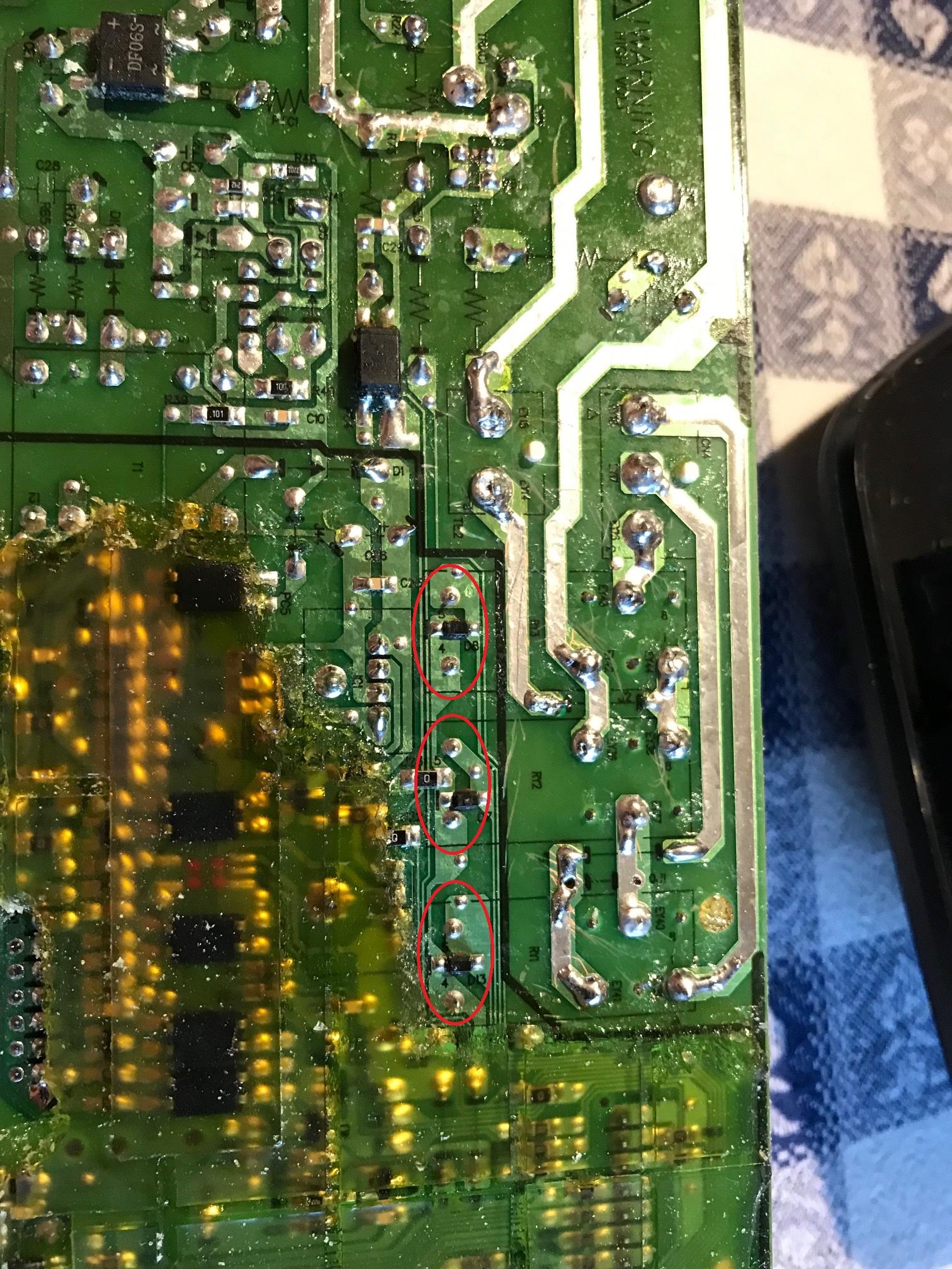

    The washing machine starts, but after a few minutes stops. I press again the start button it starts and stops again. It cannot fill the drum with water. During the filling it stops. The pumps are new and the filter is clear. The motor is ok. The draining program works. The display screen doesn't give any trouble code.
    Please help me, thanks.

  • Clean the impulse chamber and hydrostat hose
    #4 19861526
    Kenworth 18
    Posts: 11271
    Help: 2445
    Rate: 3752
    You should clean the impulse chamber shown in the photo to which the hose going to the hydrostat is connected: https://north.pl/karta/waz-polaczeniowy--beben---pompa--do-pralki-samsung-wf-70f5e0w2w,AN2- 2N-CMMV-JWF.html, of course, the tube itself must also be clear. You can also check if there is any dirt in this hose: https://north.pl/karta/waz-odpowietrzajacy-do...-do-samsung-wf-70f5e0w2w,4B2-7J-CMMV-JWF.html

    Does this engine rotate after the start of filling, if it is operational and does it spin in the spin program?
  • #6 19875003
    mirkozenere
    Hi friend, your washer machine mounts a DC motor?
    Try to check the welds below 3 relays...

    alexder03
    Τhank you. I will try it.
