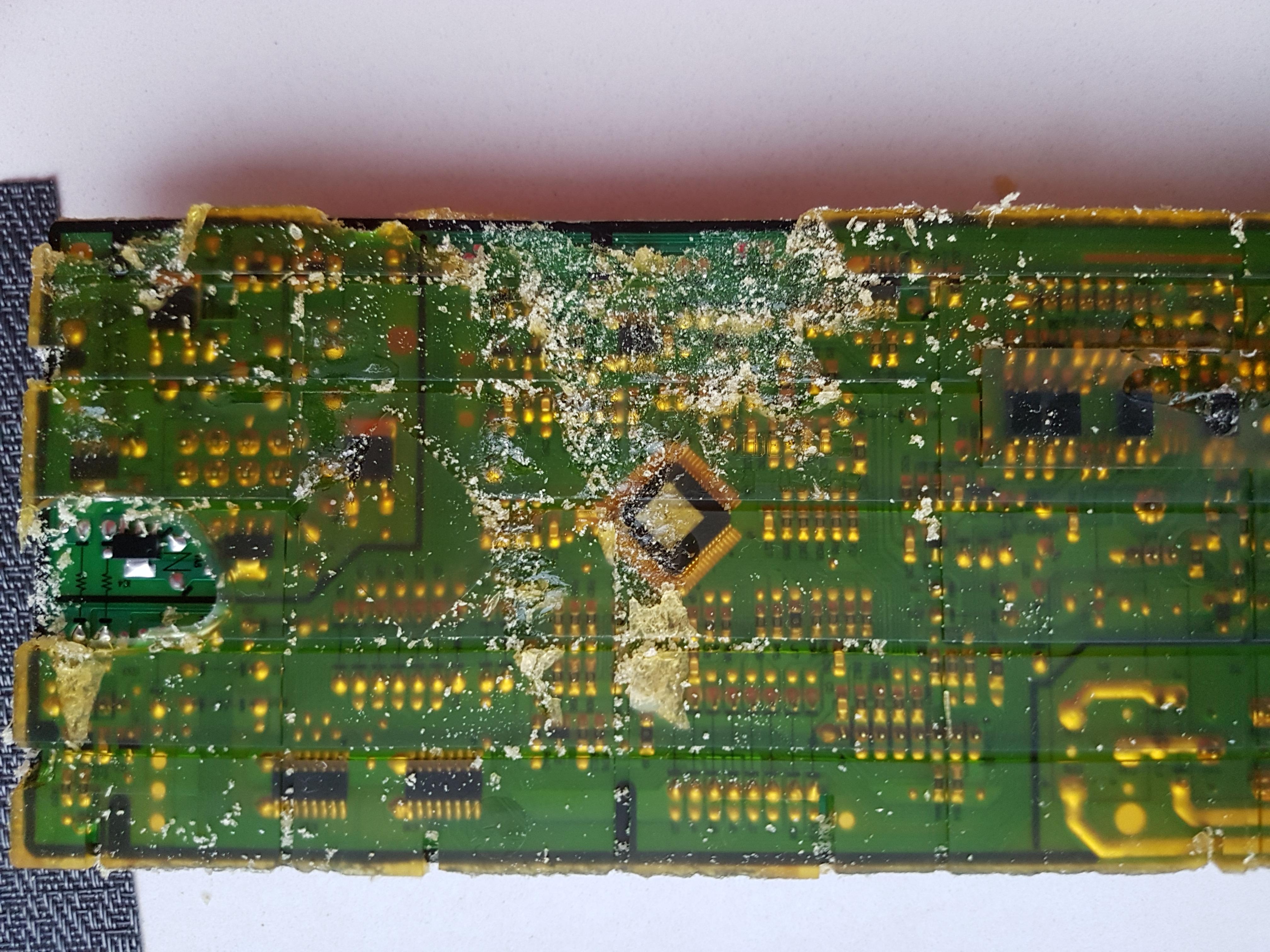

    Hello, and so, after turning on the program, the washing machine starts working, i.e. the pump starts, begins to draw water and after the water draws, it spins faster and the program no longer works (the display works, but stands still).
    Thank you in advance for the hint.

    Damage to the tacho generator can be evidently excluded. I connected to my washing machine a control panel with a module from another Samsung Eco bubble washing machine and the washing machine started working without any problems until the very end of the program.
    Then I connected my control panel with the module back and as I wrote above the same happens. I will add to this that every 4-5 minutes the drum once again turns a little faster and stands still (the display remains unchanged), so 3 more times, then it is as if someone pressed the pause.

    It's nice that you managed to check it out like this. In this case, photos of the module from both sides will be necessary.

    Hello, I am sending photos, module front to back.

    The module is flooded with jelly. That was just missing. I can't help it. Unless preventive relay replacement. There is nothing visible under the tacho circuit. Maybe some specialist will answer and help?

    If I had anything to advise, I would check the power supply first if the voltage is correct. Especially under load. Can you read what integrated circuit the power supply is working on?

    I need help with the same module, and after replacing the ICE2QR2280Z converter with TNY266 still silence. I do not know if it will be helpful that I have a transition on the pins where the UF4007 diode should be

    I have the same module. The washing machine took in water, the drum began to spin one way, then stopped and the other way did not move. After pressing pause and restarting, the situation repeated itself. It turned out that February was released on the relay coil from the engine speed. I corrected it and everything is back to normal.
