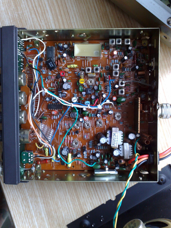

  • #4 20097189
    Asterix5867
    Posts: 33
    I am sending you attached photos. Could you kindly tell me where the Q510 and R650 are located? I have the scheme, but it looks bad if I try to enlarge the image it grains.

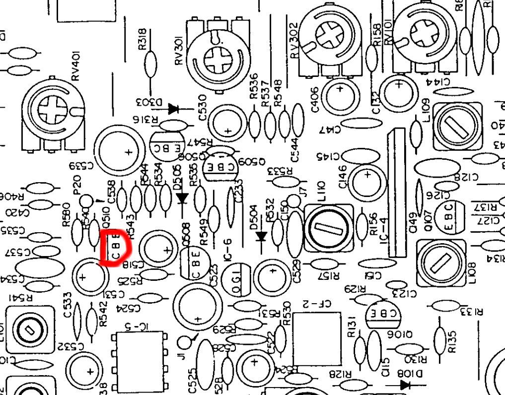

  • #6 20097575
    HD-VIDEO
    Posts: 8037
    Help: 1265
    Rate: 1883
    Q510:
    Alan28 - How to remove the modulation limitation on Alan 28.
    And R650 >> R580 has a value of 6k8 - I do not know why the replacement

  • #9 20097640
    Asterix5867
    Posts: 33
    I found the Q510, but I can't find the R650.

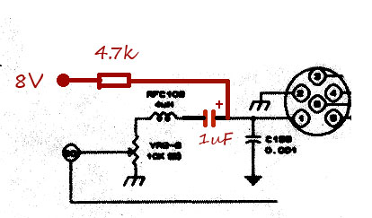

  • #17 20097763
    SP5IT
    Posts: 11616
    Help: 1298
    Rate: 1689
    Asterix5867 wrote:
    SP5IT friend, I'm using the original microphone.
    Put electret capsule instead of dynamic and mod radio inside as on attached schematic.
    Alan28 - How to remove the modulation limitation on Alan 28.ele.jpg (23.38 kB)You must be logged in to download this attachment.
    8V is present in many places inside radio.
    Mike

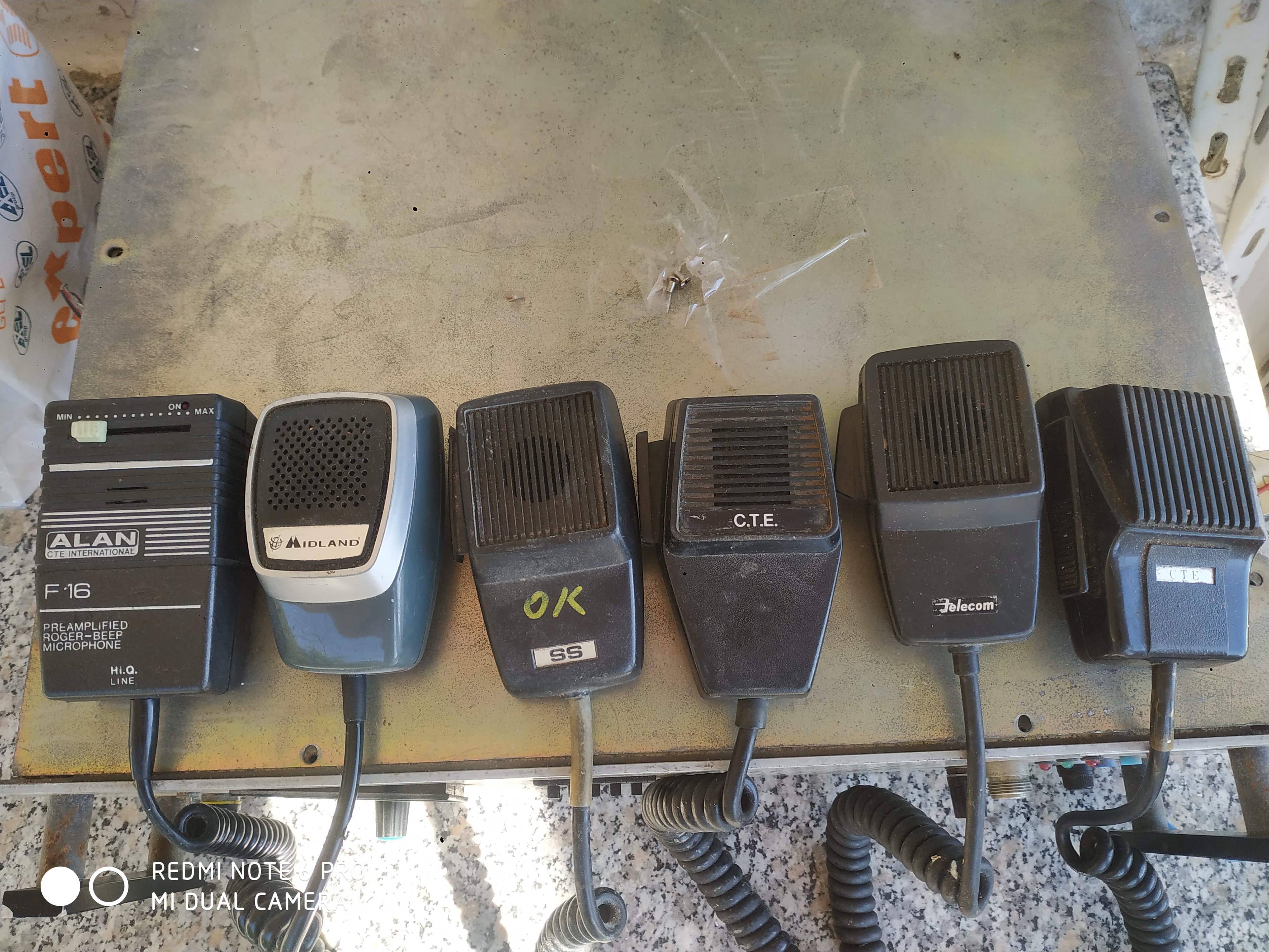

  • #18 20098185
    Asterix5867
    Posts: 33
    ok which of these mics is right? I send attached photos.
    • Alan28 - How to remove the modulation limitation on Alan 28. IMG_20220712_092212.jpg (4.99 MB) You must be logged in to download this attachment.

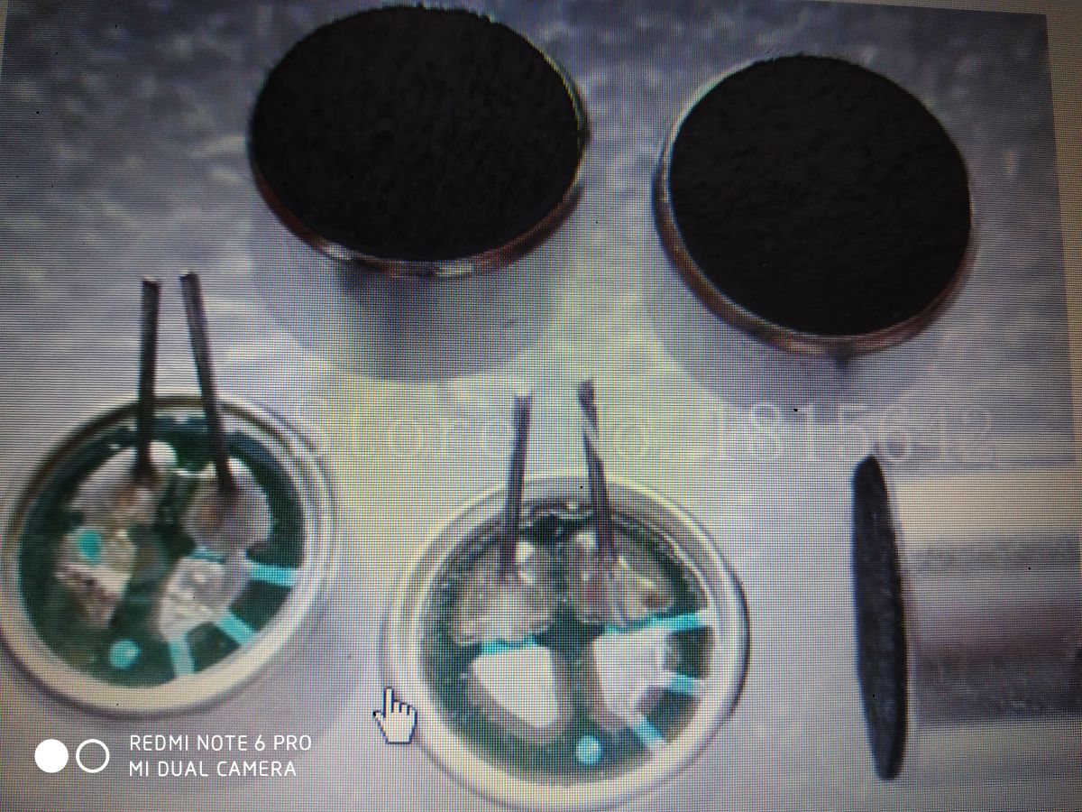

  • #19 20098211
    Asterix5867
    Posts: 33
    or maybe I have to fit one of these into a microphone? I send attached photos
  • #20 20098216
    gumisie
    Posts: 17928
    Help: 1667
    Rate: 2483
    I would call the F-16.
    EDIT:
    In the case of such a microphone insert, the CB should be modified in accordance with the diagram in # 17
  • #21 20098330
    Asterix5867
    Posts: 33
    if I understand correctly I have to remove the TR510 and mount the microphone " Alan F-16 ". if, on the other hand, I want to mount a microphone that needs power supply like the one in the photo I sent, I have to make the change according to the scheme in # 17.

    Asterix5867 wrote:
    if I understand correctly I have to remove the TR510 and mount the microphone "" Alan F-16 ""
    You don't necessarily have to disassemble the Q510. The F-16 microphone has a battery-powered preamplifier. I would connect this microphone and check the AM modulation level.
  • #23 20098365
    Asterix5867
    Posts: 33
    I was wrong I wanted to write remove TR 510 and use the original microphone, it is clear that the " Alan F-16 " microphone is internally amplified.
  • #24 20098366
