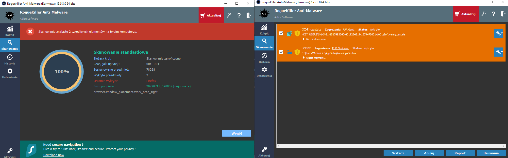

    Uninstall unnecessary programs:
    - Adobe Flash Player
    - WebAdvisor by McAfee
    - NVIDIA GeForce Experience
    Perform a full scan as a precaution RogueKiller .
    Before running the scan, enable the MaIPE (BETA) signatureless module.
    In addition, I'm dropping a Chrome guide → https://soo.bearblog.dev/chrome/
    Replace Adblock in your browsers with uBlock Origin + blog filters.
    Run FRST, press ctrl + y. Notepad will open, paste the contents of the script into it. Close and save. In FRST, click "repair" →
    Code: text
    After executing the script and restarting, attach the created fixlog.txt and a screenshot of the RogueKiller scan.
  • #4 20106632
    mateuszszy1
    Posts: 7
    Screenshot and report attached.
    • Trojan:Win32/Wacatac.B!ml - how to remove? Windows Defender, CCleaner, FRST skan.png (78.55 KB) You must be logged in to download this attachment.

  • #5 20106649
    mateuszszy1
    Posts: 7
    Thanks to the instructions of colleagues from the subject of the post, I dealt with the problem. Thanks
