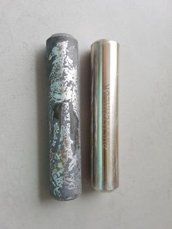

    For interested. After using this invention, the stains on the cutlery are the same as before, I don`t see any difference. The instructions say this is to catch loose bits of rust. After thinking about it, I don`t know where the loose pieces of rust in the dishwasher would come from. It is a neodymium magnet pressed into a block of aluminum. VooDoo product from the Energy Saver series.
    Rust spots on cutlery - causes and solutions when washing in the dishwasher Rust spots on cutlery - causes and solutions when washing in the dishwasher
    Sample reviews from Amazon:
    Spoiler:
    Actually not even worth one star. I`ve had the rust repellent for about 6 months and it has worked great. Unfortunately this product is a complete disappointment and is black after 5 uses! And I have more rust spots than before.
    Cutlery in the dishwasher comes out of the rinse with rust stains despite the rust repellent. The rust repellent is in the cutlery basket and has a compartment to itself - the cutlery is spread out in the other compartments. To be honest: with Rostschreck there are even more stains on the cutlery. This would be a great idea - unfortunately it doesn`t work.
    I`m not one to give negative reviews, I usually stay silent, but this product deserves a review. Theoretically, all this could work is that the rust particle is attracted to the rust repellent. In practice, however, it turns out that after the third rinsing process, the rust remover has significant dull spots. After another 5 rinses, the dull spots became rust spots. Cutlery that needs to be protected from rust will rust and stain, making it unappetizing (not cheap cutlery, but a 320 euro cutlery box). This product is the worst I have ever purchased from amazon. As an amazon, I would consider removing the product from your portfolio as it would only damage your reputation.
    Conclusion: product worse than bad, sent back after 8 weeks, bought a new cutlery box ........ expensive experience
    I wonder if electrolytic coating of cutlery with nickel/chrome (I don`t know, I`m not a chemist) might solve the problem. Spots always appear in the same places, in micro pits. A layer of non-corrosive metal probably makes sense.

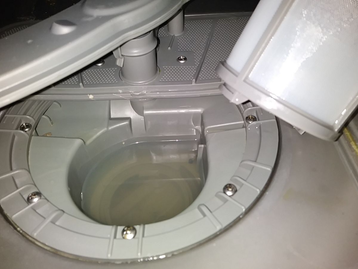

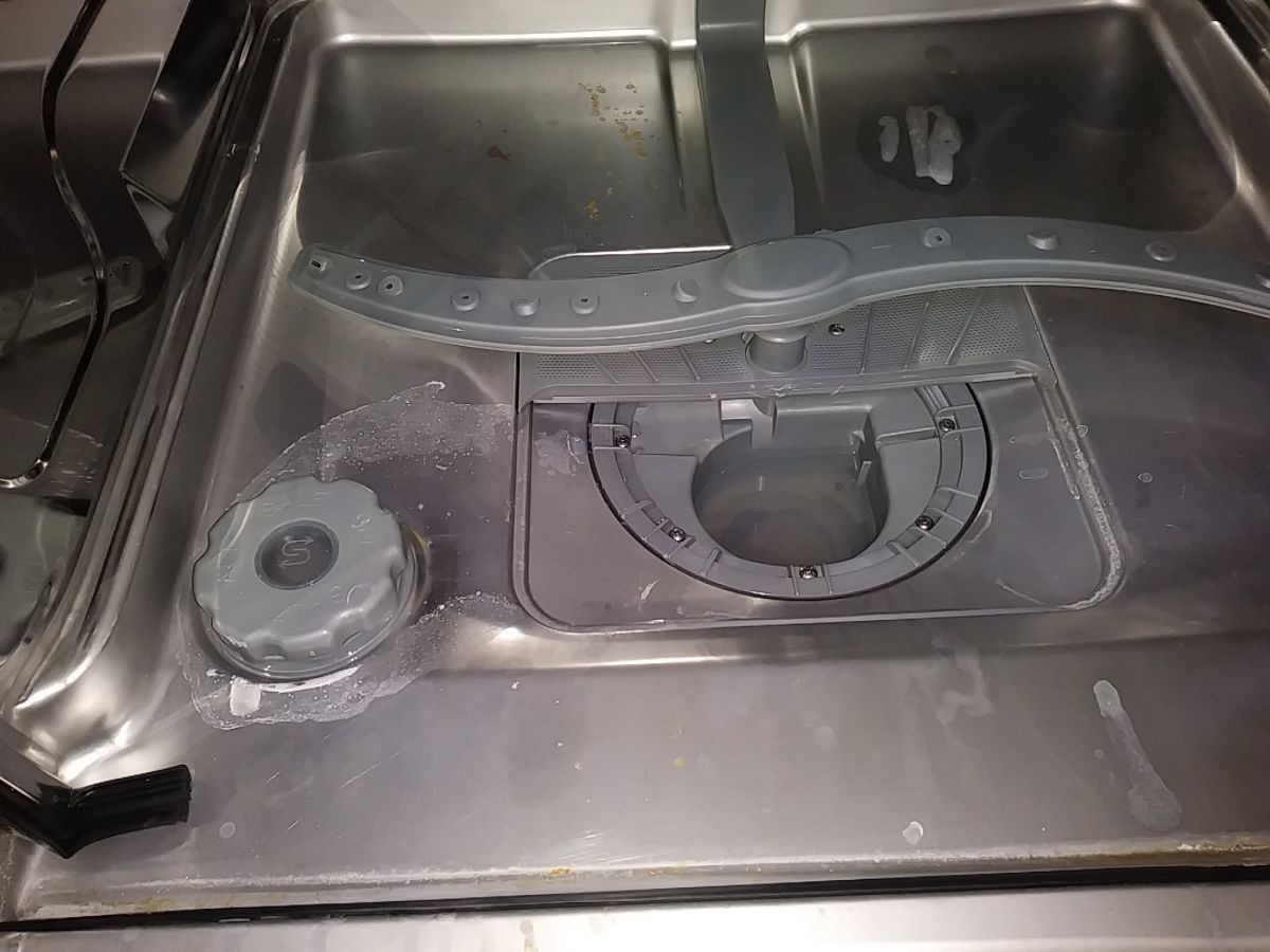

    I repeat.
    pilomatt wrote:
    You add salt and then pour water right up to the cork.
    Right under the cap, without any free space in case of volume changes due to temperature changes?
    Here the situation was such that while unscrewing the plug, fluid flowed out from the tank, pushed out by a slight overpressure.
    Maybe you need to leave some free space, as is done when filling various tanks?

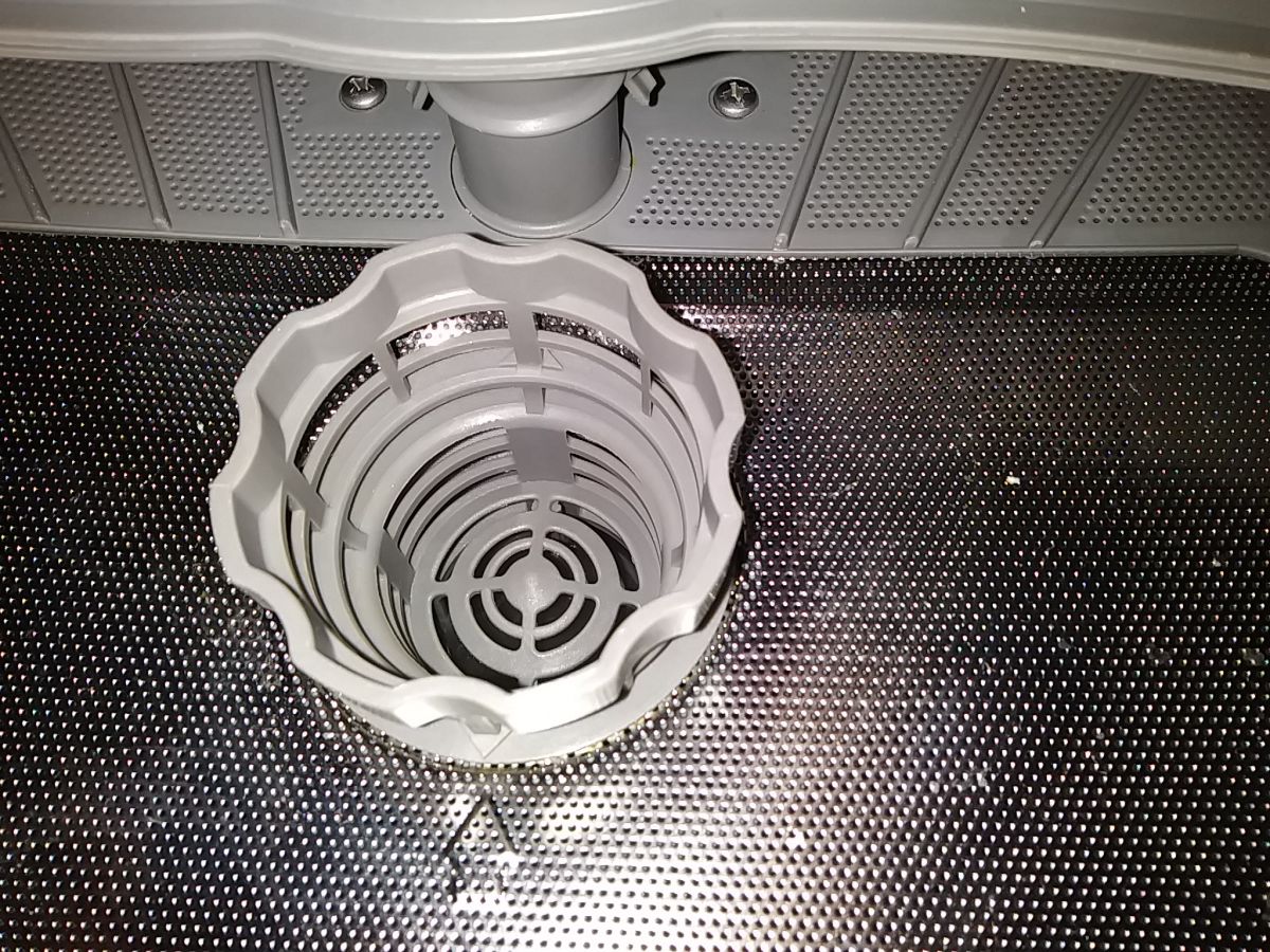

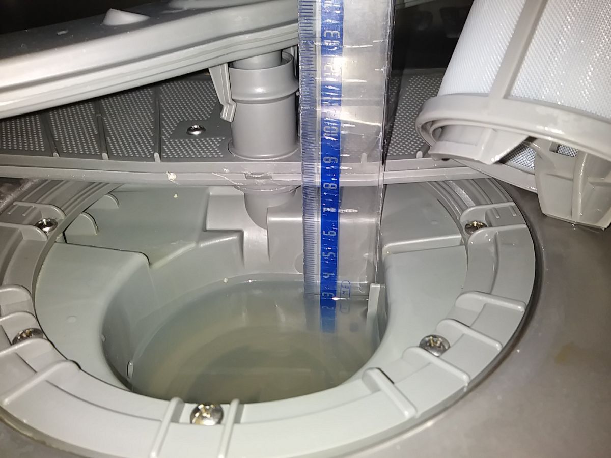

    Ture11 wrote:
    ...this level should not be so high with this filter chamber design. Maybe after the program was turned off, the dishes dripped so much, but it never happened to me. Some water always remains there (about 2 cm from the bottom), because the pump is not able to pump out all of it (the pump has an inlet from the side of the bottom).
    I will quickly believe that you have a damaged check valve behind the pump and that the water from the drain pipe flowed back into the chamber (after the pump turned off, immediately or after some time). Except that this amount of dirty water has no effect on anything. And immediately after starting the program, the water should be poured out by the pump as much as it can.
    The end of the ruler is placed near the sensor, not at the very bottom.
    I have previously pulled out pieces of a long-broken cup from the deepest recesses and for this reason I am wondering whether such an amount of water in this place is appropriate. Maybe the drain channel is partially clogged and the drain needs to be unscrewed and at least emptied of any pieces of the cup that may still be there?
