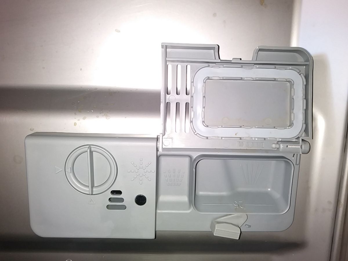

    @pilomatt
    The traffic jam was not completely closed, but there was no tragedy.
    Rust spots on cutlery - causes and solutions when washing in the dishwasher
    In general, its design ensures that it cannot be tightened too tightly.
    Attention. After unscrewing it, some excess fluid poured out, what should be its level and should some of it be removed?
    On the inside of the door I saw something like this:
    You add salt and then pour water right up to the cork. Of course, tap water ;) .

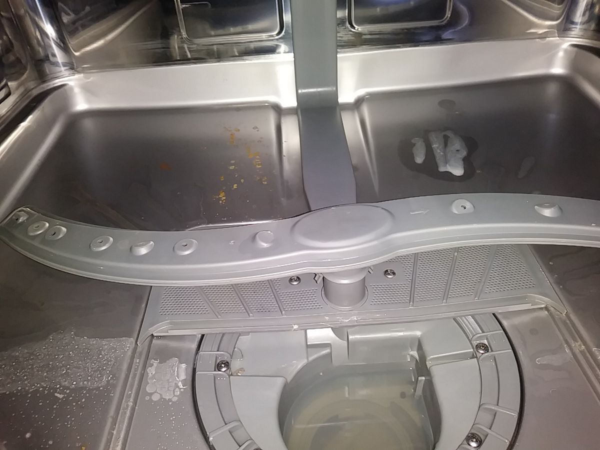

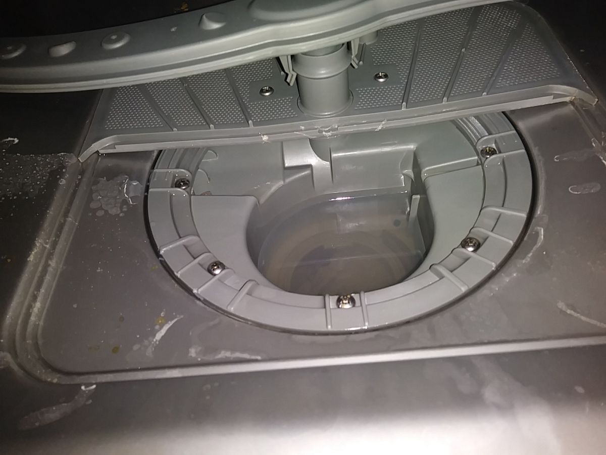

    The case turned out to be a development one.
    After removing the filter, I found in it and in the further drain the remains of a glass cup destroyed by the dishwasher at the beginning of its use.
    It seems that the drain itself is clogged and the problem may be a direct result of the water remaining in it.

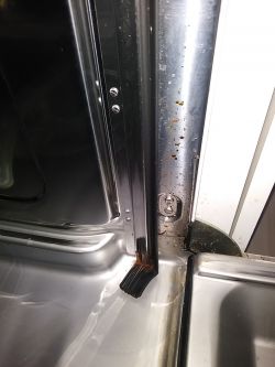

    Inside, although only on one side, I found very similar stains.
    Likewise on one side of the door.
    Unfortunately, the dishwasher is built-in, located in the corner and adjacent to a cabinet that cannot be pulled out due to the sink and water installation.
    What ideas do you have for dealing with the whole drain repair issue?
    And what is damaged in it?
    Is this water supposed to stay there instead of being pumped out?
    Of course! First dishwasher in your life?
    It has nothing to do with it, washing powders or tablets are very aggressive and therefore damaging, I have the same problem, either there are spots or the cutlery turns black, which is also a symptom of rust.

    ad.1 It`s about corrosion of the cutlery, not the dishwasher.
    ad.2 This is not a rusty coating that can be removed with a cloth. Some of them are burns the size of a pinhead with only a slightly darkened color, and some of them are rust that appears alive after a few days on ordinary steel exposed to rain.
    For now, I have cleaned the filters and am waiting for any results until the dishwasher is in use.
