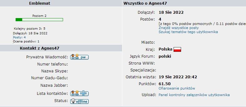

    Little chance of receiving this information. He hasn't been on the forum since reporting that
    Everything is working now.
    i.e. from August 19, 2022.
