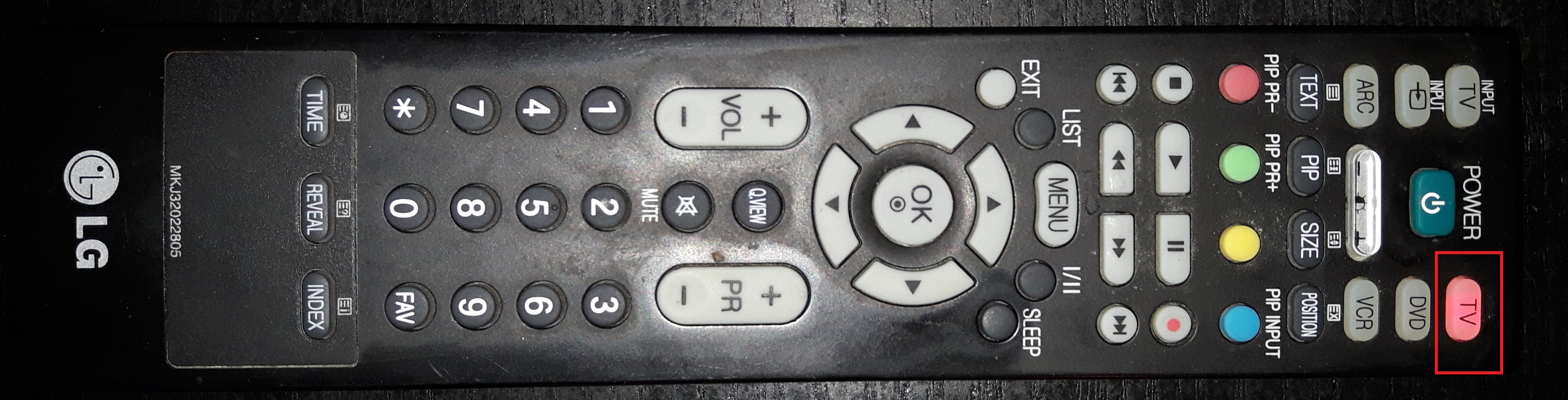

    Coincidentally, my mother decoded the original remote control (MKJ32022805) to the LG 26LC3R TV. I searched the forum and internet quite thoroughly and nowhere can I find a way to program it. The manufacturer's manual does not write anything about it.
    Maybe some of you have this model of TV or remote control and know how to program it back.

    I don't think it broke after all. Now, when you press any button, the button lights up (you can see in the photo). This was not the case before. Somewhere on the internet I found that programming is done by a combination of MENU + MUTE buttons. What next, I don't know.

    Probably someone pressed a button on another device. Press the TV button and it should work.
  • #5 16171921
    freeagentpl
    Well, after pressing the TV button, the TV does not react.
    Replace, check, batteries, see on others as the TV does not work. Keep this button pressed longer.

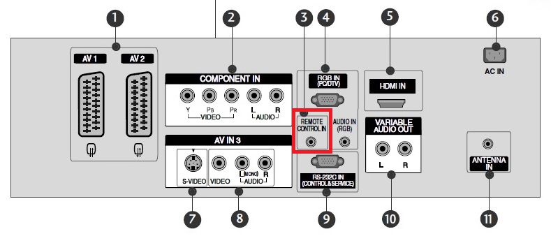

    New batteries. I held the TV button for about 1 minute. The LED on the TV button lights up when you press the buttons, but the TV does not respond :-(
    h jaworski wrote:
    When pressing, for example, the volume key, the TV diode blinks, it should be like this, just check if the signal is emitted by the infrared diode with a device, e.g. from a mobile phone.
    The diode emits IR waves. I checked with the camera
    Added after 1 [hours] 11 [minutes]:
    Problem solved. Own stupidity. A laptop was connected to the TV via the D-Sub connector and audio via AUDIO IN (RGB). I accidentally mixed up the sockets and plugged the audio cable into the (REMOTE CONTROL IN) connector. Therefore, the TV did not respond to the signal from the remote control.
    Thanks to everyone for your help. best regards
