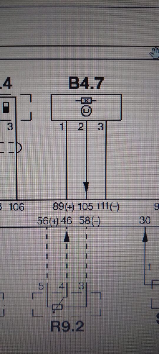

    Hi I have an Audi A3 2000 1.6 petrol BFQ/AVU. It starts but it won't respond good on throttle. I've changed the camshaft position sensor 3 times and still the same if I disconnect the sensor nothing happens. So I suspect a wire break?
    Trying to find a wiring diagram with no luck.

    And what is the engine power in KW?
    Added after 53 [minutes]:
    Please sensor fight
    Sensor B4.7

  • #4 20170037
    NIXIE_123
    Posts: 2087
    Help: 288
    Rate: 609
    Decide what engine you have. Avu has a shaft sensor under the shaft gear and a bfq under the throttle
  • #5 20170050
    UCY 7400
    Level 20  
    Posts: 257
    Help: 37
    Rate: 75
    The BFQ appeared from the 2003 model year. The title was 2000, unless the engine was changed.
  • #6 20189220
    larsbrodin
    75kw
    Shaft sensor? What is that and where is it located more specifically? Any picture of what I'm looking for?
  • #7 20190606
    larsbrodin
    This can't be correct?? 1.6 litre fuel injection engine (Simos), 75 kW, 4-cylinder, engine code AVU
    From model year 2001
    Says from the year 2001!
    Mine is made 2000/10!
