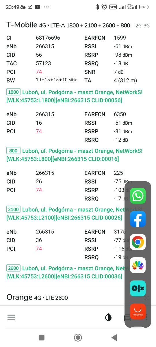

    Hi,
    I am looking for a router for LTE possibly already 4G/5G.
    I have an Orange/T-Mobile transmitter 700m away, super visibility across a field.
    I plan to spend about 1000-1500zl.
    What do you recommend, preferably new?
    ZTE MC888, OPPO 5G CPE T1A, WONDERS LT18?
    Maybe something else?
    LTE on the transmitter in all 5G bands is already there too.

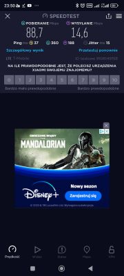

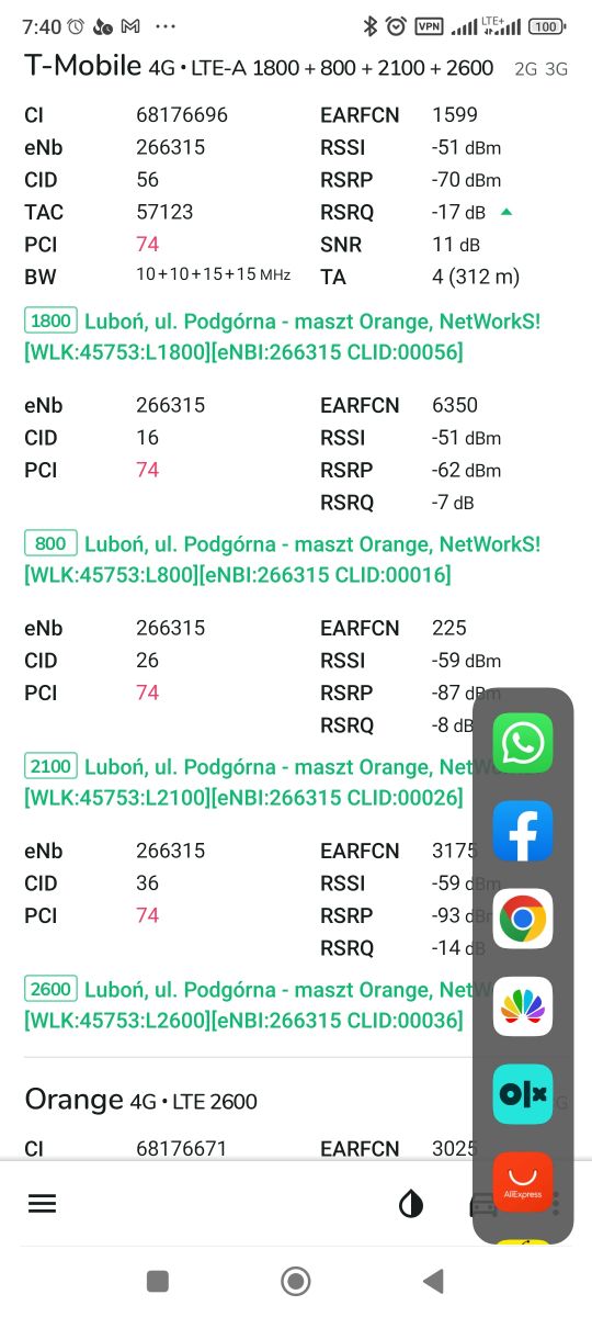

    Hey thanks for the reply I am attaching the screenshots. Router for LTE/4G/5G with band aggregation: ZTE MC888, OPPO 5G CPE T1A, CUDY LT18 or other? Router for LTE/4G/5G with band aggregation: ZTE MC888, OPPO 5G CPE T1A, CUDY LT18 or other?
    Added after 7 [minutes]:
    Small town at this point phone seen station about 700m.
    #4 20470000
    matek451
    Posts: 31253
    Help: 4352
    Rate: 5808
    At home on LTE1800/2100 signal parameters sufficient but on LTE2600 very poor, SINR poor. Performance correct for test conditions. The station on the second sector has potential, 5g2100 within DSS with LTE2100, it would be necessary to check how it works but I wouldn't count on miracles, aggregation of 4 bands in QAM256 with optimal signal parameters on 1800-2600MHz should give even better speeds.

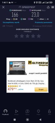

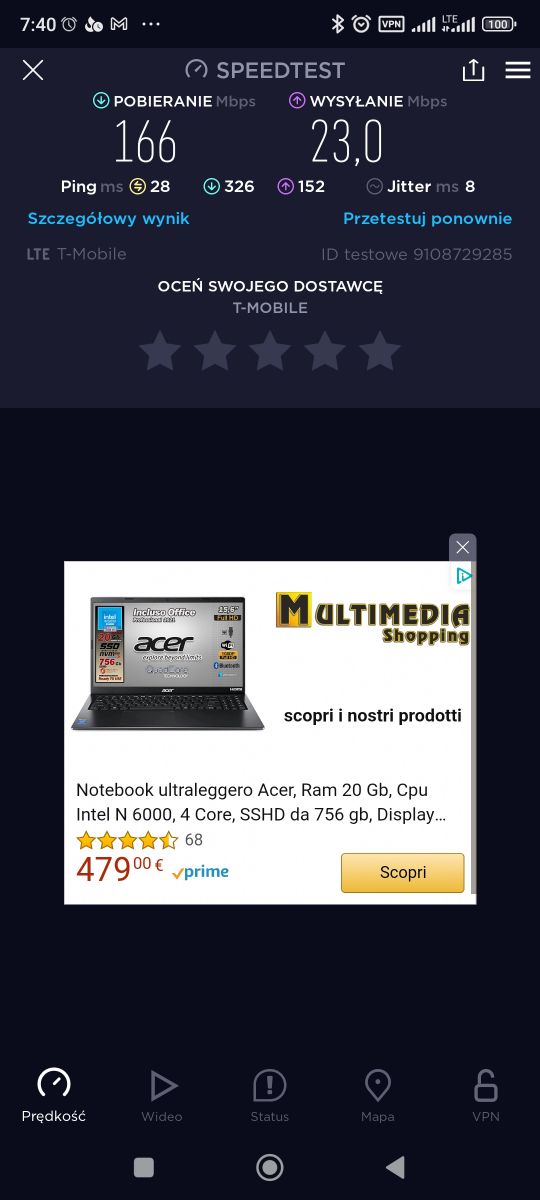

    Tests 7.40, 5G is not necessary, however, it is already nice such a router which aggregates these 4/5 bands. For me even this 100 mega is enough so temporarily without external antennas I would like to try. So should I hunt for a mc888? And what do you think about MC801, oppo 5g cpe, miracles LT18, ZTE MF289F, netgar orbi?
    Router for LTE/4G/5G with band aggregation: ZTE MC888, OPPO 5G CPE T1A, CUDY LT18 or other? Router for LTE/4G/5G with band aggregation: ZTE MC888, OPPO 5G CPE T1A, CUDY LT18 or other? .

    I use the LBR20, MC801A, MF289F, I have 500m from the BTS and inside the correct signal parameters, in Play the speed in the aggregation of 4 LTE QAM256 bands 250-350Mb/s practically on each of them, to the MC7010 outside and on it the ideal signal parameters and speeds of about 300-400Mb/s, it's the predecessor of the MC889 because I was thinking about it and not the MC888, a typo. OPPO T1A without external antenna connections. Some Wonders LTE18 I do not recommend, because even though it is 5G on EG25EA, the poor Media Teka chipset in such a device is a failure and the software based on OpenWRT does not save it. Personally, I think that one should not give up the possibility of connecting external antennas, i.e. a router with 5G/LTE e-couplers or CPE. The LBR20 has LTE 18 CAT. and SMA connectors, MF289f is a known ZTE configuration of antenna connectors like in MF297D/286D, MC801a connectors work only at 3.4-3.8GHz, OPPO T1A has no connectors. Cudy even has 4 pieces but has a weak chipset. MC889 is 5G/LTE X62 MODEM integrated with external antenna. 4x4 same as MC7010.
    Outside, the signal parameters are very good at 800/1800/2100 MHz, but the SINR does not allow QAM256 modulation to be switched on, probably noise from neighbouring sectors of other BTSs, as you have some in the area; LTE2600 is sufficient.
