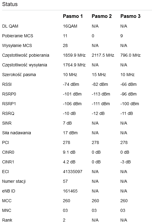

    In such conditions, a friend should not take this set, first of all it is problematic with FW Play and above all it does not provide the correct signal parameters on LTE1800 from BTS Pniewy, the aggregation on the screen is the LTE1800 base band, the signal is very weak and LTE800 to it with sufficient signal. LTE1800 + 2100 aggregation does not turn on, signal on LTE2100 is probably fragmentary. In addition, FW for Play does not allow forcing LTE bands, including LTE2100 + 1800 aggregation.
    He must try to change the mounting location of the antenna, and preferably change the equipment and after the tests select an external antenna for 1800-2100MHz with high gain.

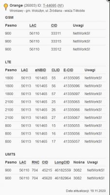

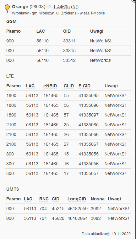

    I'll update the topic a bit. I bought a router MF258 Orange network. Request for help in optimizing band aggregation. You can set up band/frequency/pci locks in the router....
    The nearest transmitter to which the antenna is directed:
    Table with information about GSM, LTE, and UMTS bands for the Orange network showing band, LAC, CID, and other details.

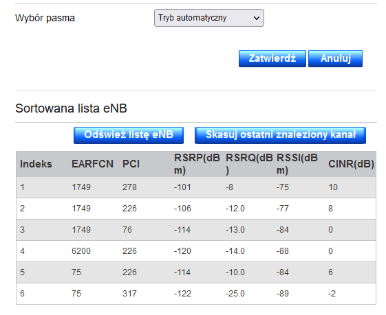

    Router automatic parameters:
    Screenshot showing network connection statistics for a router, with information on three bands.

    Ask @jarek7714 he knows it as little as anyone and based on the PCI shown he will show you BTSs and sectors on individual Orange carriers.
    Seriously, you have LTE1800+2100+1800 aggregation, 3 sector, you have sufficient signal parameters on LTE1800/800 and weak on LTE2100. Do you live in the area between Wroniawy and Obra? What are your DL/UL speeds under these conditions on the MF258K?

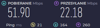

    Kębłów area. The antenna directed at Wroniawy. On auto settings DL UL:
    Internet speed test results showing download at 51.90 Mbps and upload at 22.18 Mbps.

    The result is correct for this time, but ORANGE is not an operator for this location, I bet on KĘBŁOWO because you showed PCI W in ORANGE and PCI 76 on LTE1800 is the 2nd sector from OBRA, the antenna receives backwards, the signal from OBRA is much worse for this reason . But Obra has LTE2600+2100+1800+800. PCI 226 is the neighboring 2nd sector from Wroniawa, I would try with this BTS Obra, maybe it will be better.
    And the operator for KĘBŁÓW is PLAY because it has BTS with LTE2600+2100+1800+800 there, I would test PLAY on Virgin-Mobile 470GB/MC pre-paid for PLN 15.
