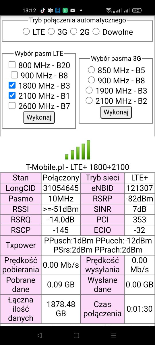

    Good morning, I have a few questions about the offer at T-Mobile Internet Home. I currently have an internet speed of 90 Mb/s, a Huawei B818 router and an external Cybertech antenna. My contract ends in about a month and I can upgrade to unlimited 5g speed and one of the routers listed
    1. ZTE MMC888 5G - unfortunately it does not have an external antenna output
    2. ZTE MC889 5G + T5400
    3. TP-Link NX510V 5G - I know the least about this router, can an external antenna be connected to it?
    Should I leave the B818 router with the Cybertech antenna and choose a 5G SIM card with unlimited speed? Will this actually increase internet speed if my current router does not support 5G?

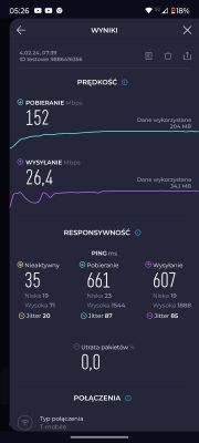

    It is impossible to answer your question factually. Not enough data.
    To make a rational decision, you need to know what signal you currently have from the antenna, what signal you have when switching to the indoor antenna, what speeds you get during the day and in the evening. Knowing whether an antenna is needed, knowing what the signal is, what speeds (transmitter load level), you can make rational decisions. If you are not currently achieving a speed of 90mbit/s and it is due to the load on the transmitter and not a bad signal, then changing to an unlimited contract or 5G will not bring much. 5G is not a game changer for Tmobile at the moment, it works on 1 band shared with 4G. If it is available to you, it should be slightly faster, but it will be a bit faster, not 2x faster.
    If you often reach 90mbit, i.e. you are limited by the contract and not the signal quality or transmitter load, a new contract without a 90mbit limit should result in higher speeds. How much more you won`t know without testing. You can also test it on a prepaid plan. You don`t have to commit to a new contract. If it turns out that you reach 110mbit instead of 90mbit, it is worth considering increasing the new costs.

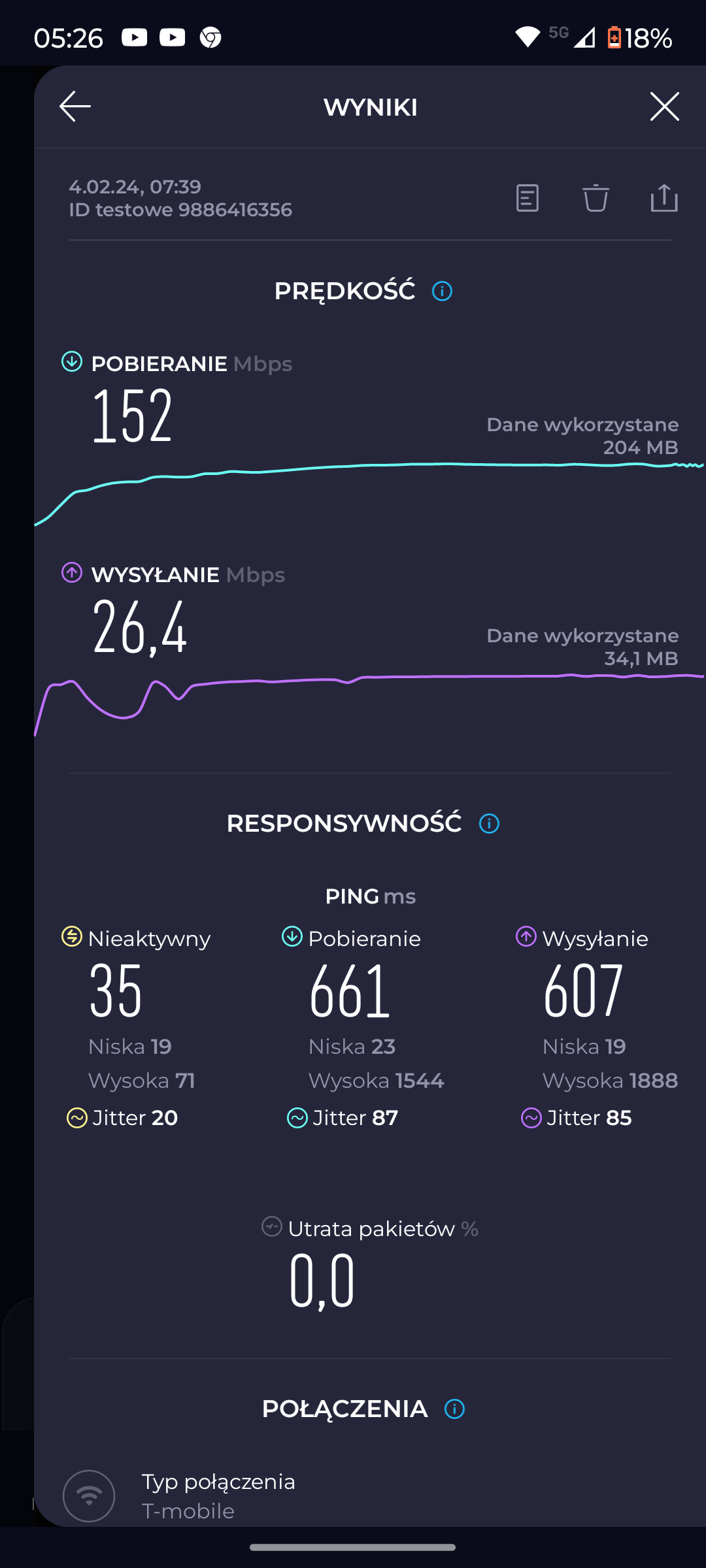

    Hello, this is more or less what it looks like for me Choosing a router for T-Mobile's offer: ZTE MMC888, ZTE MC889, TP-Link NX510V or Huawei B818? Choosing a router for T-Mobile's offer: ZTE MMC888, ZTE MC889, TP-Link NX510V or Huawei B818?
  • Need band, SIM, and time-of-day details
    #4 20634031
    m.jastrzebski
    Posts: 5252
    Help: 679
    Rate: 865
    So I assume you don`t have the 2600 band available there?
    And what SIM card are these speeds on? Because you talked about the 90mbit contract, here it is 120.
    The signal is such that I wouldn`t risk it without an external antenna. There you can probably change the antenna usage to internal in the configuration. And you will see how much it would go without external antennas, which will tell you whether you can think about a router without external antennas or give up.
    And what time is this speedtest from? Now in the middle of the day? How much goes in the evening, when the load generally increases.

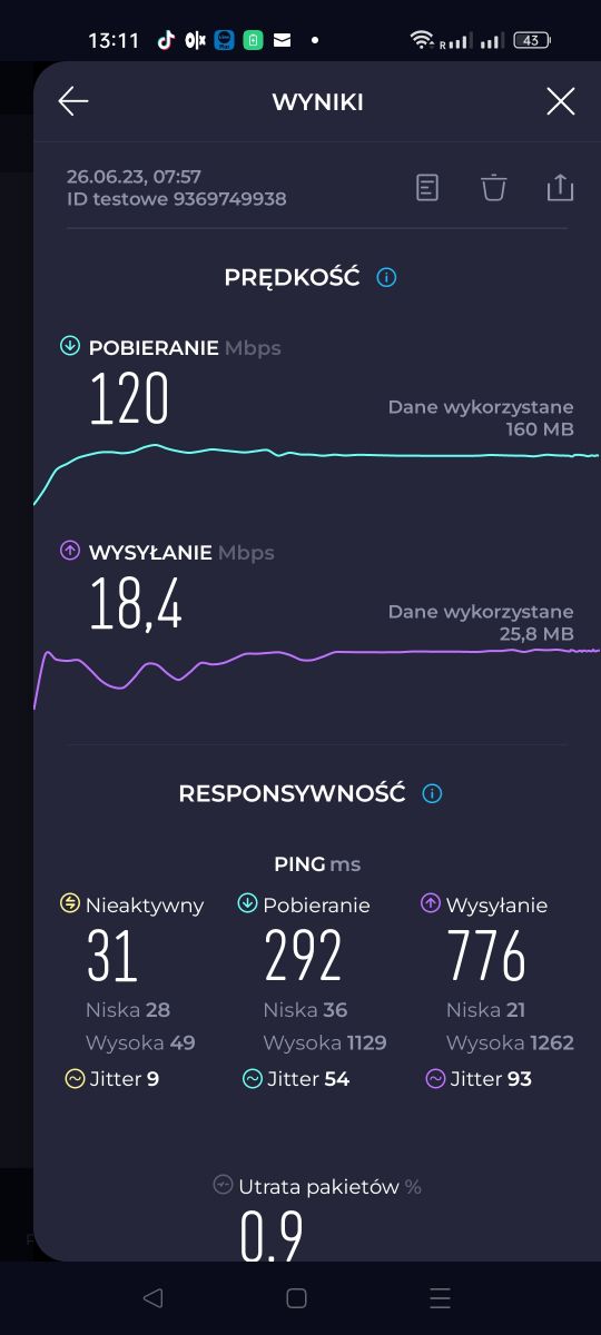

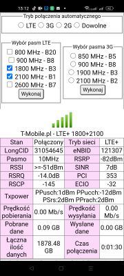

    The speed is almost always the same and I`m going with 90 Mb, that`s the contract I have :)
    MC889 recommended for external antenna support
    #6 20634237
    matek451
    Posts: 31263
    Help: 4352
    Rate: 5810

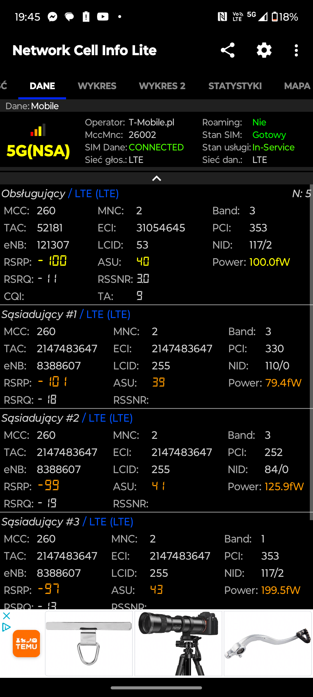

    Przemyśl, so it`s not surprising that LTE2600 from Tatarska Góra, signal parameters are very weak. It`s with the Cybertech antenna, what kind of antenna is it, it`s strange that you don`t connect to the BTS on Lwowska 36 because it`s the closest NetWORKS BTS with LTE2600+2100+1800. But on the other hand, it`s a mobile mast so it may no longer be there. Overall, the infrastructure is poor, LTE2100+1800, including Fibris. 3rd sector, signal on LTE1800 correct, no LTE800 because it is borderline, but they added LTE900 instead of the canceled UMTS900. 5g2100 should already work on it in DSS with LTE2100. Replacing it with MC888 or NX510V 5G is a misunderstanding, both of them do not have external antenna connectors. Only CPE 5G MC889 will do the trick. For the test, check the LTE2100 itself without the external antenna on the B818 inside the house. On 5G2100 they will be similar.

    Mc889 in unlimited offer, how much could he get, as now I have about 120 from Fibris, would the difference be worth replacing everything!?

    On LTE2100+1800+800 from Fibris you have high speeds, I am afraid that for your conditions and location it is maximum, the lack of LTE2600 has its effect, and SINR does not allow work in QAM256. Replacing it only makes sense with MC889 under 5G2100. In fact, TP-Link has TS9 external antenna connectors, but I am afraid that they only work on N78/79. Overall, the price is unprofitable compared to MC889+T5400.

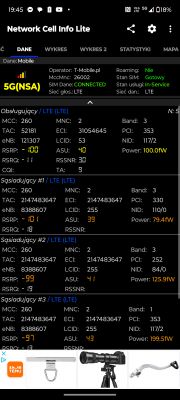

    Rate: 55

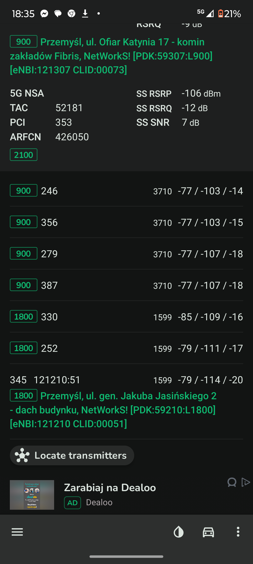

    Screenshot of an app displaying details of 5G and LTE network connections in Przemyśl. Screenshot of a mobile network signal analysis app.
  • #21 21029615
    matek451
    Posts: 31263
    Help: 4352
    Rate: 5810
    This is pseudo 5G at 2100MHz from Fibris, the question is whether the card has access to 5G N78 or only to N1, because it is possible in T-Mobile, you would have to check in another location where there is access to another BTS with N78.

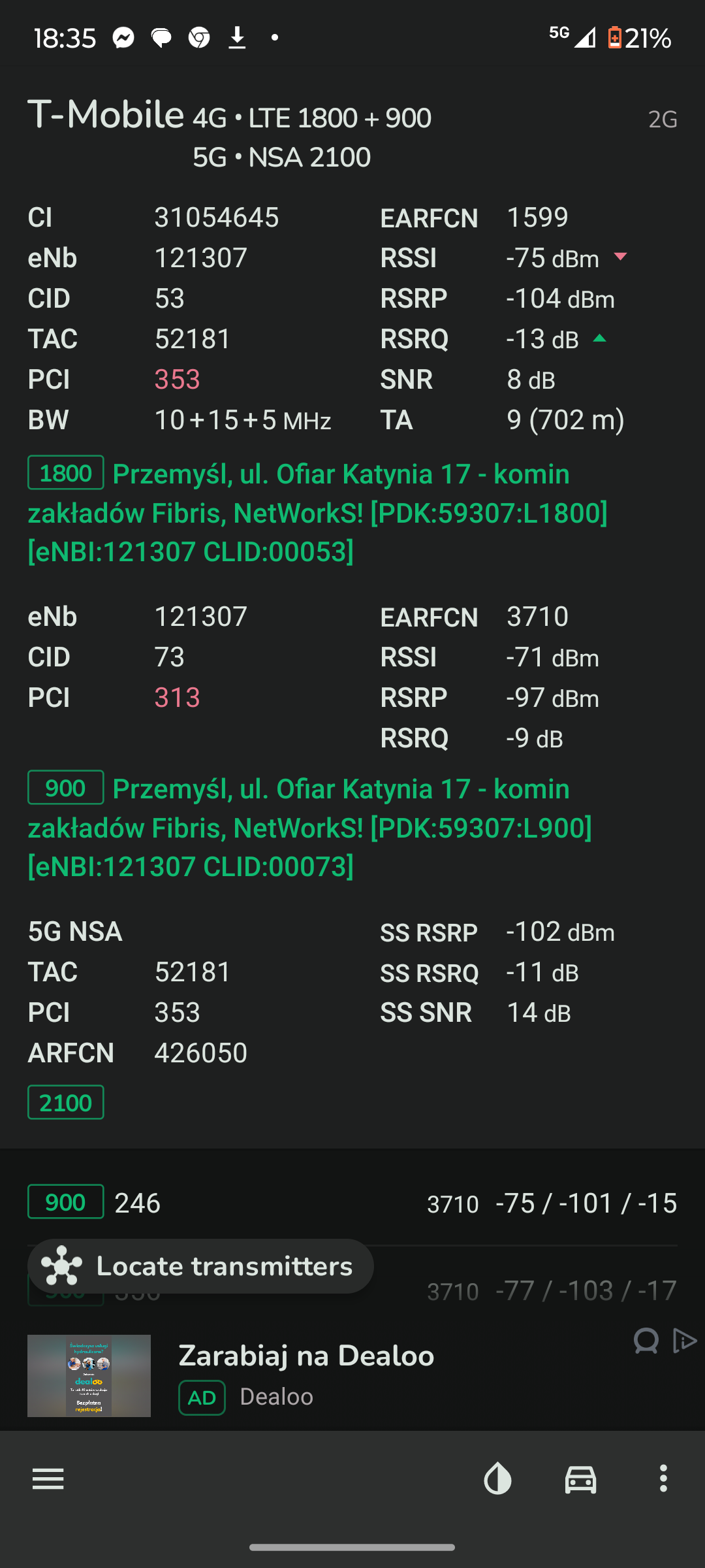

    I checked this morning and recently I drove up to the mast on the Fibris and under the Fibris I get about 800mb on the phone, so without an external antenna it`s probably not good. Will my antenna be enough or a completely new one? What is it about? At home, about 40mb on the phone
  • #23 21030268
    matek451
    Posts: 31263
    Help: 4352
    Rate: 5810
    I would not go for a 5G router plus antenna solution, a much better solution is external 5G access points, the MC889 from ZTE as an ODU in a set with T3000 acting as an IDU, i.e. an internal router can be purchased for PLN 1,200, there are also several other 5G CPE models on the market.

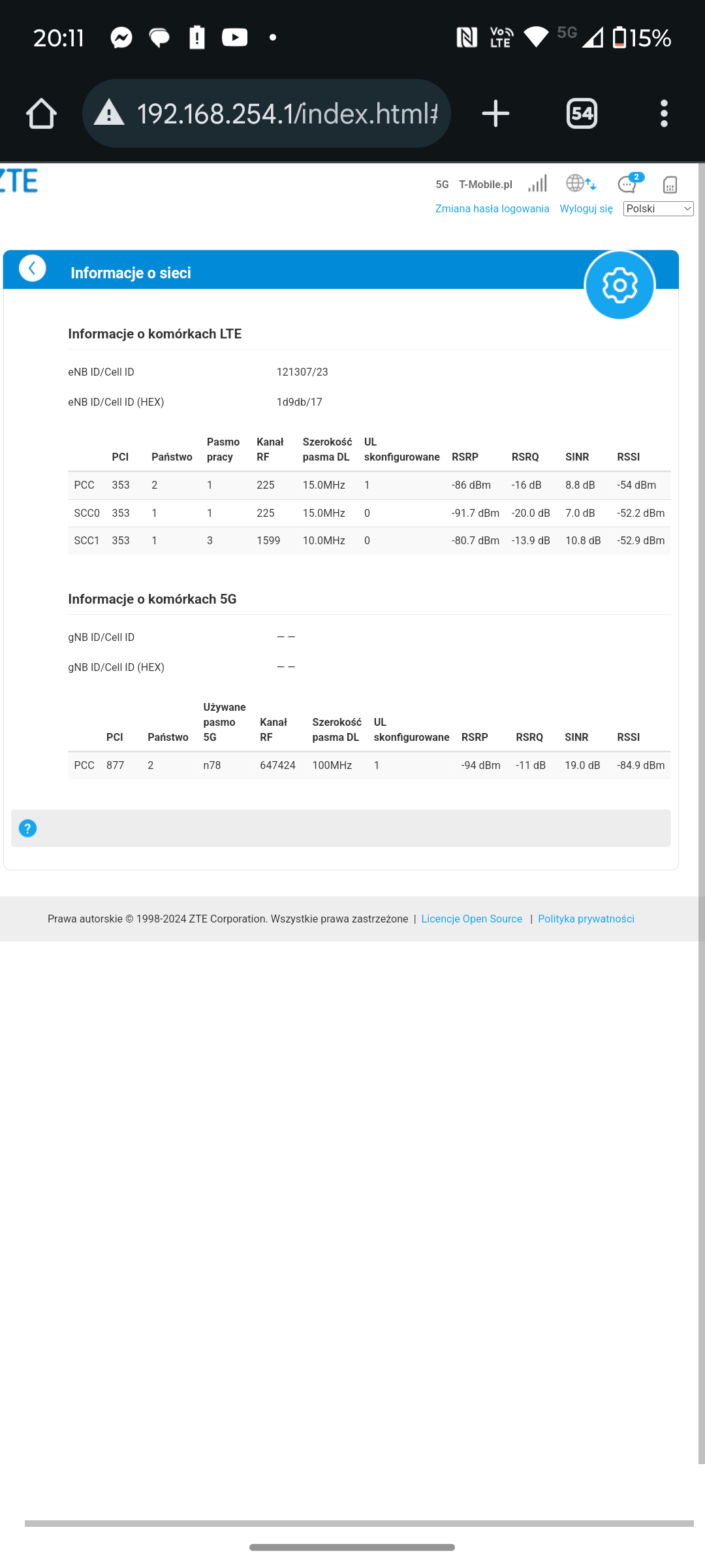

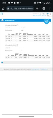

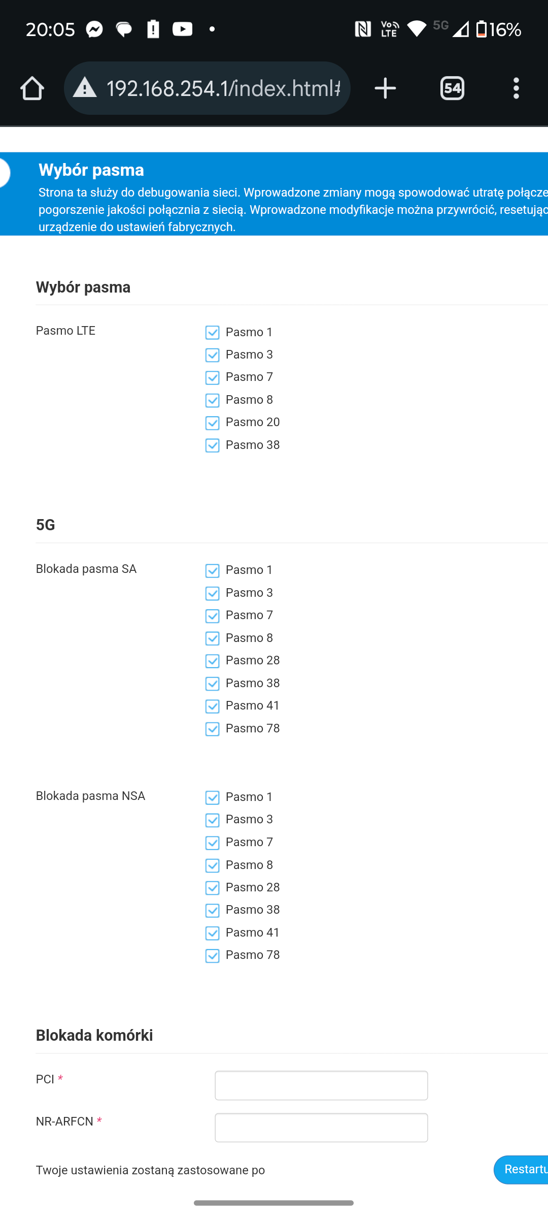

    Hello, I have chosen mc889 with an external antenna, unlimited speed, I have a few questions if it is better to connect to the transmitter from fibris or zana street and what bands to choose on the router when connecting to fibris, when I first start up the antenna on my chimney directed to fibris max 300mb download and checking on my phone also in T-Mobile it goes at 600mb what could be the problem
    Added after 1 [minute]:
    Screenshot of Network Cell Info Lite app showing LTE/5G signal details for T-Mobile, including signal strength data and advertisements at the bottom. .
    Router MC889 settings panel showing band selection for LTE and 5G with checkboxes and cell lock fields. .
    Screenshot of a ZTE router configuration page showing detailed LTE and 5G cell information. .
