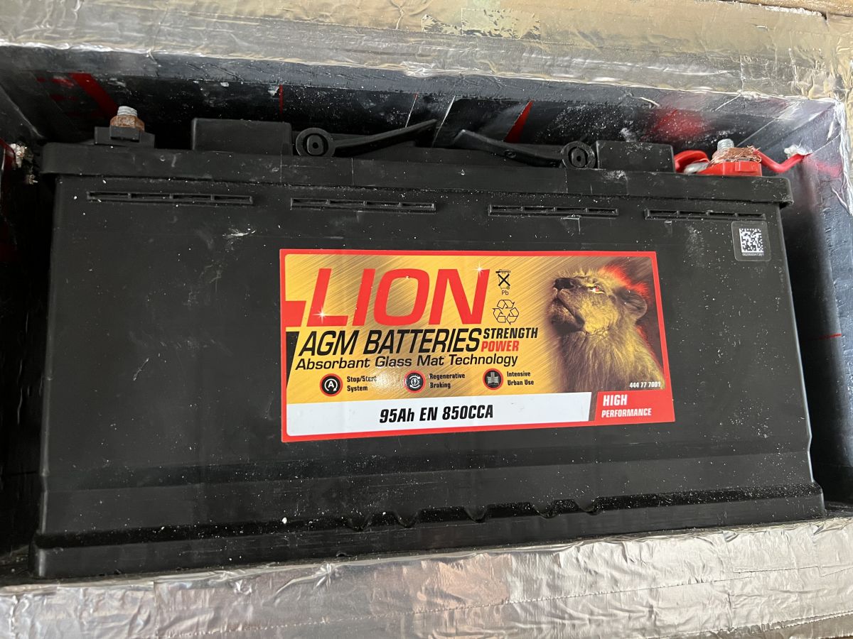

  • #5 20558298
    burczynski82
    Posts: 31
    The battery in the picture
    Calculation of the conductor cross-section - direct current DC, 12V
  • #6 20558311
    teskot
    Rest in Peace
    Posts: 2969
    Help: 420
    Rate: 957
    We return to the starting point :) Li-Ion is not Lion :P Your battery is a regular "lead" only with the electrolyte trapped in a glass mat.
