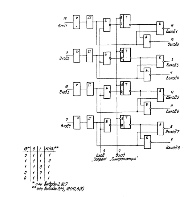

    What do you want to do with it?
    I found datasheet and translated description with google translator:
    Microcircuits are designed to work in non-contact keyboards
    consoles for information input of computer equipment, systems
    automation, means of organizational technology, information systems.
    K1102AP1 - Non-contact sensor signal generator.
    Create K1102AP1 Chip Circuit Diagram Based on Photograph: Identify Pinouts & Connections
    запрет - inhibit
    вход - input
    выход - output
    синхронизация - synchronization
