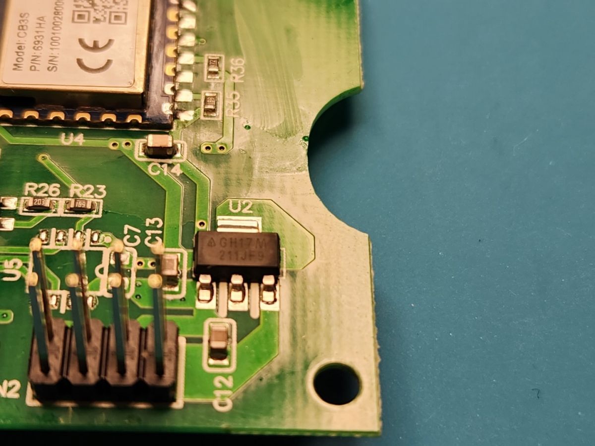

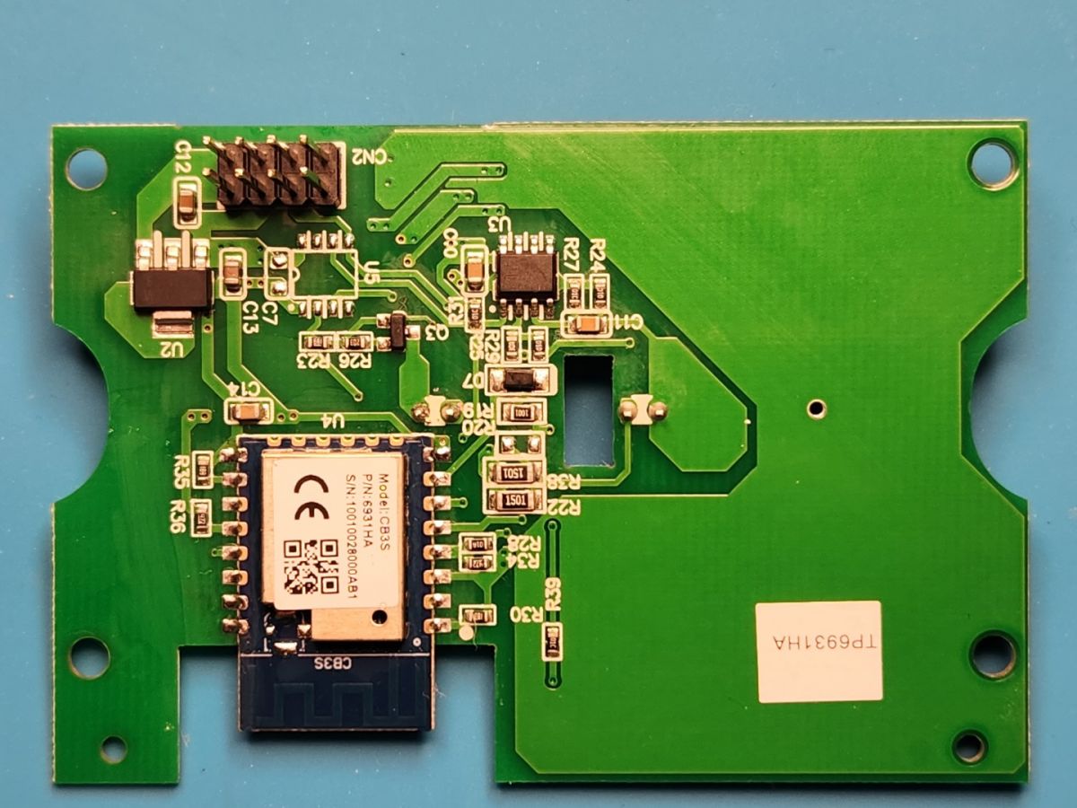

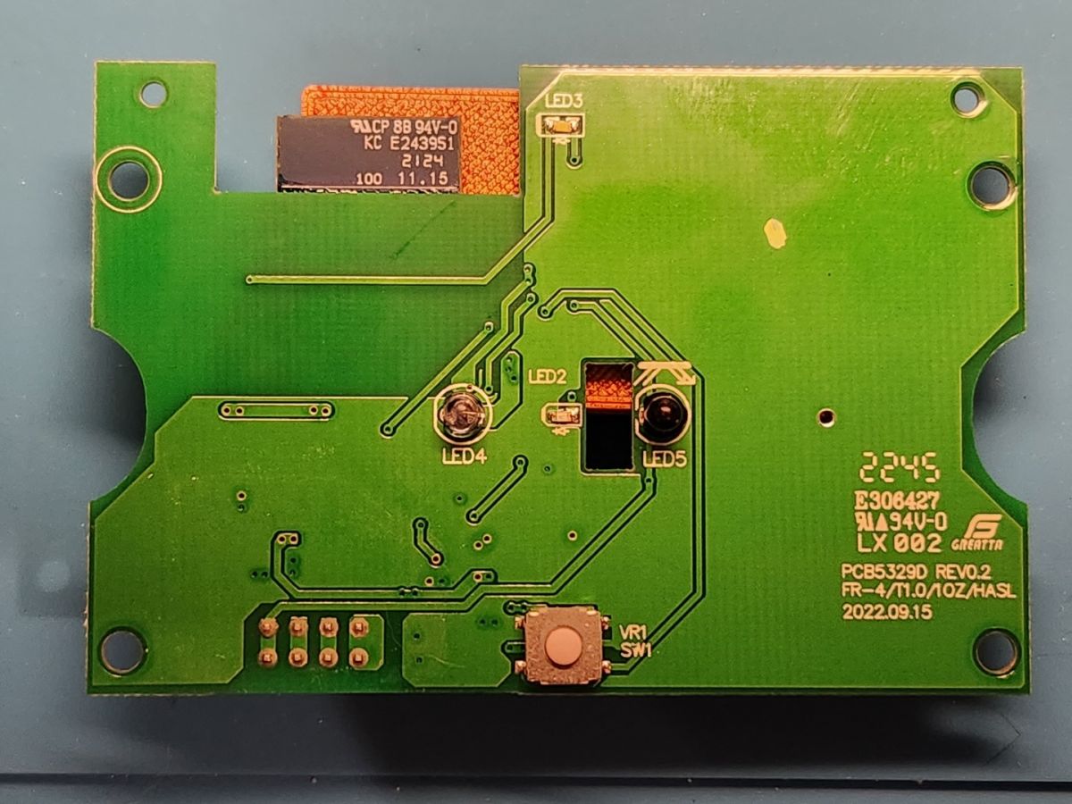

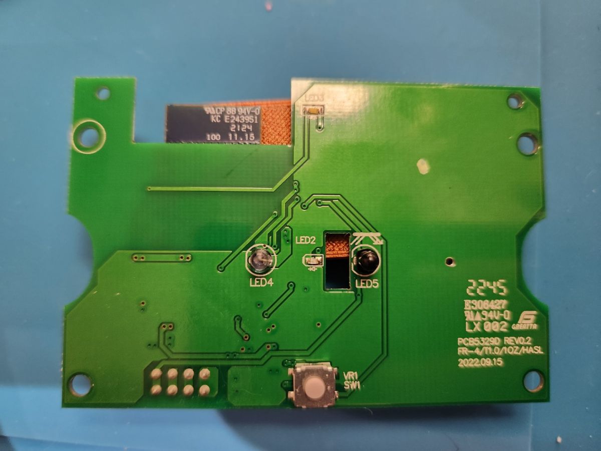

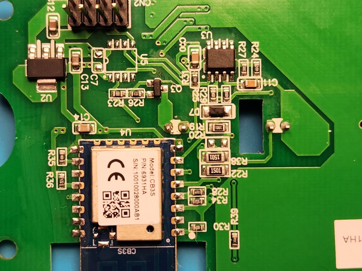

    Have added the photos of the PCB, it's certainly an interesting circuit, I have traced most of it out and will see about uploading a diagram of some kind but it looks like the only other larger chipIC is a LM358D which to me (with little knowledge of dual channel op amps) doesn't seem like it's what's doing the hand wave control maybe just helping? I may well be wrong though.
    I'm more wondering if it's even more simple than that... wondering if the Infrared receiver is just being detected for blocking of light vice versa for a period of time, the button on the other side of the board is used for pairing but also sensitivity (using timing thresholds?) when using it on stock firmware, it has low (default), medium and high sensitivity settings.

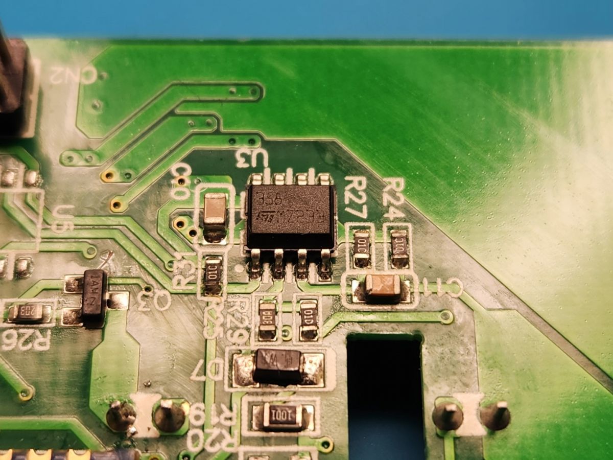

    Are you able to desolder CB3S so we can get a better view of traces?
    I wonder if ADC (P23) is somehow used there. If not, maybe they use PWM...

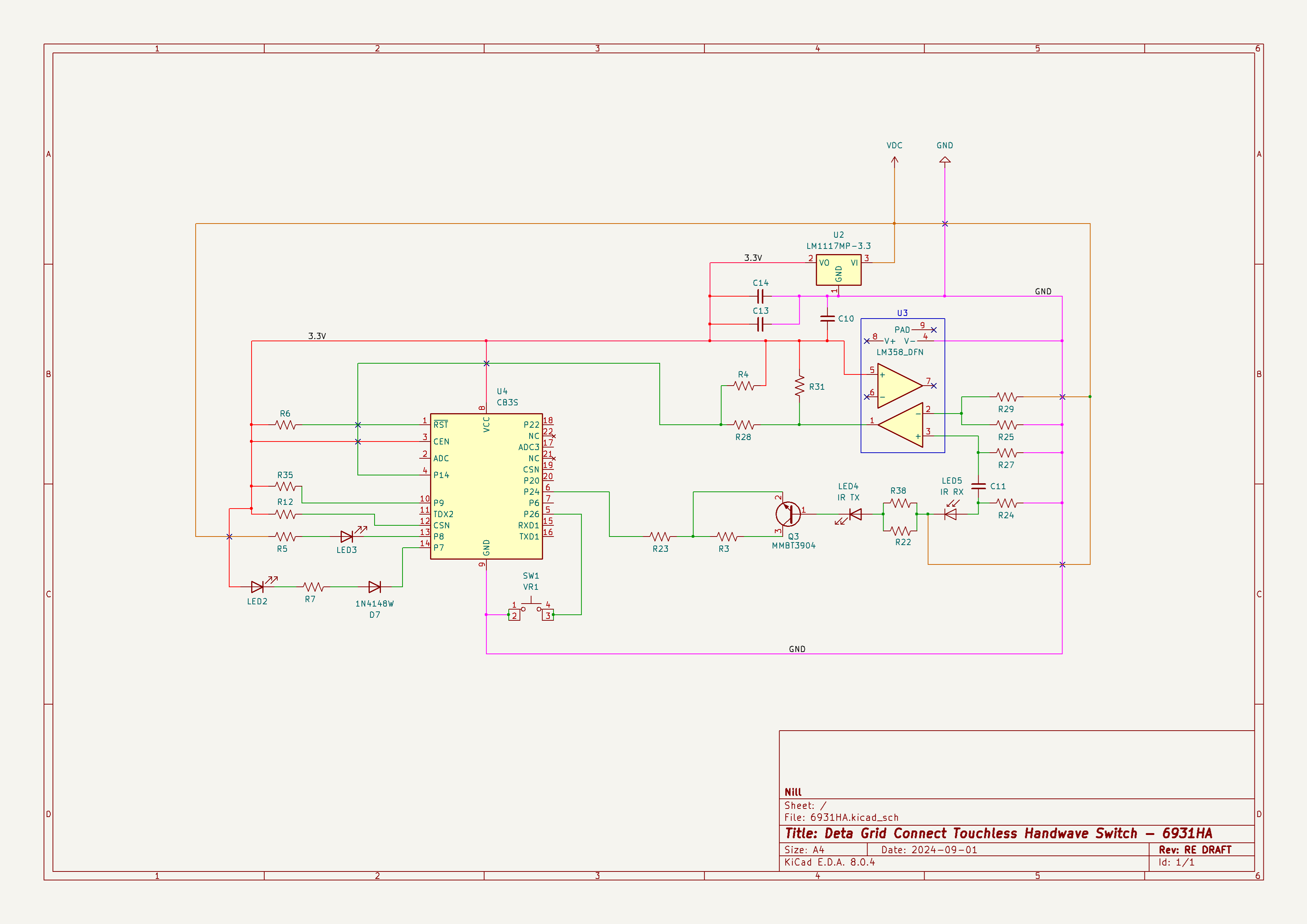

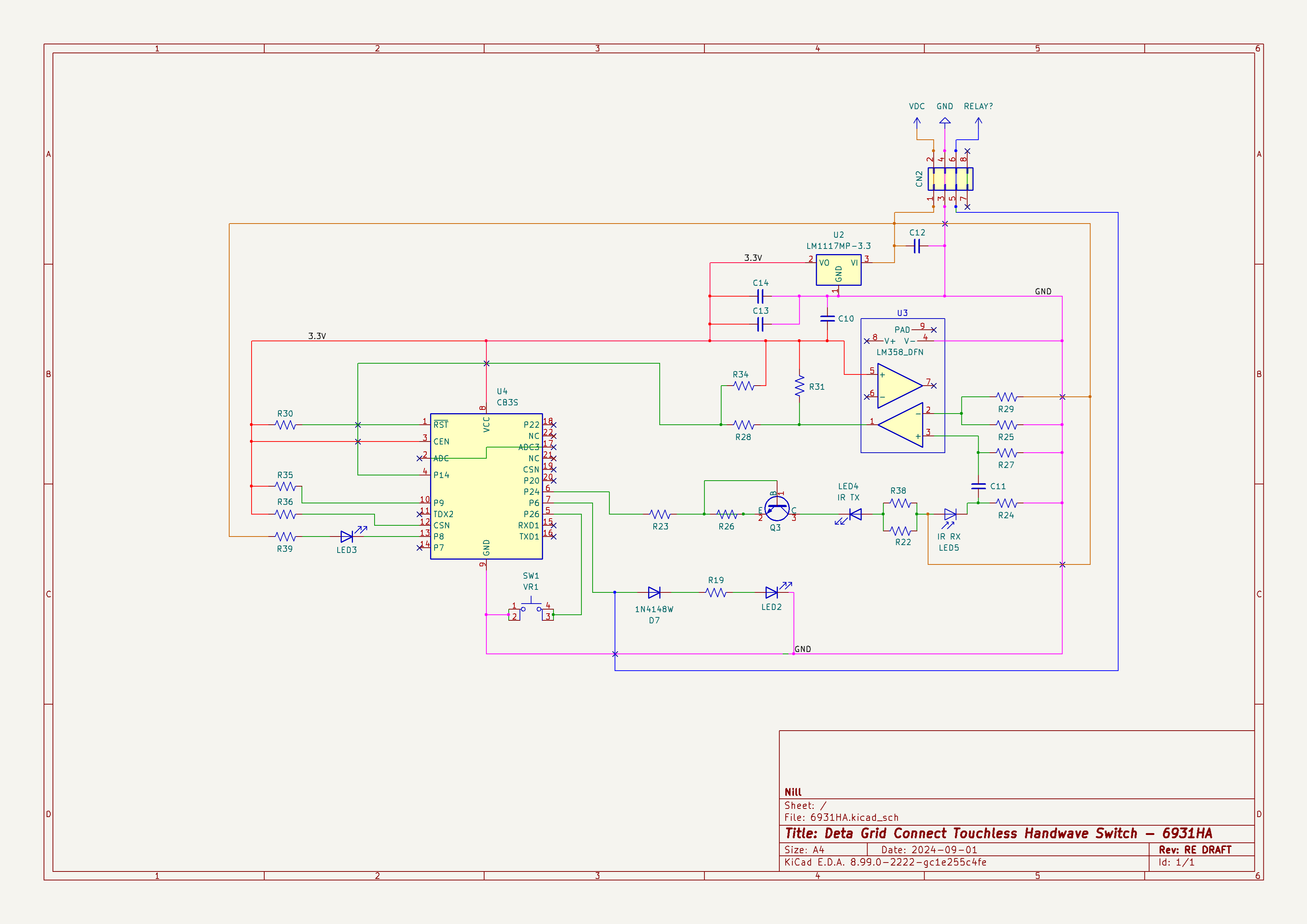

    Took me a bit but hopefully this helps, apologies if I got any components orientation incorrect its likely because I didn't trace trace this out while powered on.
    I believe I have all the connections are correct, double checked, hopefully no mistakes.
    Electrical schematic of the Deta Grid Connect touchless switch.

    >>21210981
    OK I got some of this wrong but will update when I get a chance.
    You seem to be right about PWM, P24 seems to be PWM for transmit IR LED and P14 is the input for rec IR LED, relay is on P6 along with LED2, in the diagram currently I have the LED2 on P7 which is wrong and it also looks like it's going to ground? but unsure as yet, will pull it back to bits and retrace.
    But can get the relay to trigger knowing this all this and setting P14 to a dinput, putting my hand in front of it triggers the relay on for a moment (P6 and P14 on same channel, P24 PWM_n)
    Adjusting the PWM seems to make it more or less sensitive but hard to tell at the moment as hand in front is very intermittent as to when it triggers.

    Are you sure about Q3 placement? It doesn't look right.
    Still, we can make some tests without having a perfect schematic. Just fire the PWM and try to observe what happens on another pin. Just.... we need to know which pin is PWM control (sensitivity) and which is input.
    Or maybe you'd prefer hooking up analyzer to original device with factory firmware?

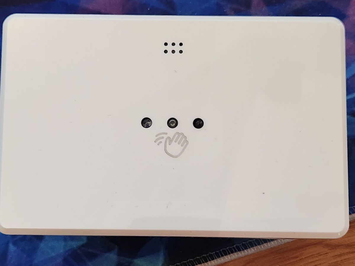

    Hmm that's super simple compared to what I have observed, initially I tried something similar to this with my one and OBK, but had very little success with the device, to get it even close to stock it required a few more changes, I have had it working somewhat but not reliably enough to use it, in the end I opted to just buy a touch switch similar to one I already have in the rest of the house.
    Can you confirm which version you have, what I found out later on was that there are two versions of this device.
    I think this version likely uses a very different mechanism for sensing a handwave, does your one look similar?
    https://detaelectrical.com.au/product/deta-grid-connect-smart-touchless-handwave-switch/
    This is the version I have, https://grid-connect.com.au/download/6931ha/

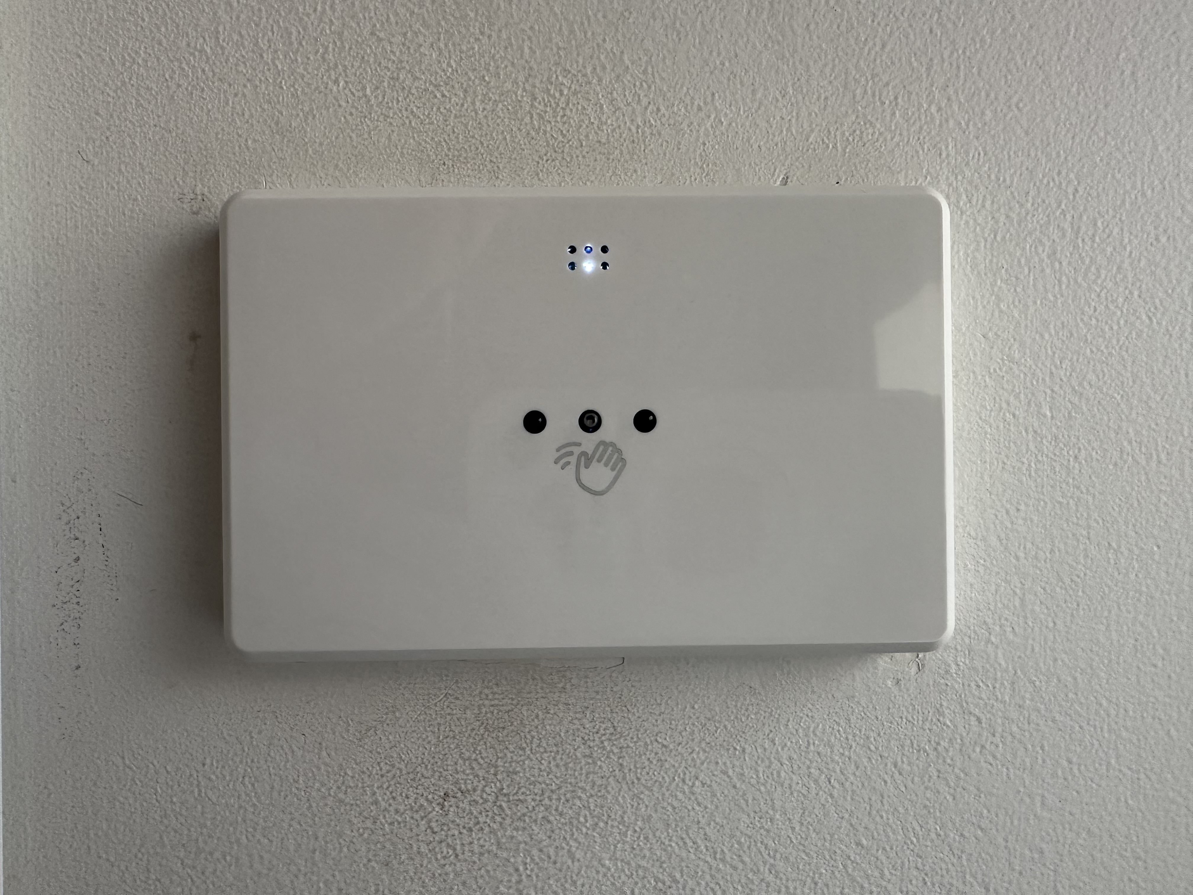

    Are you able to post any photos of your unit and its internals?
  • Request for UPK data from the other switch version
    #14 21414940
    darmok
    Hi,

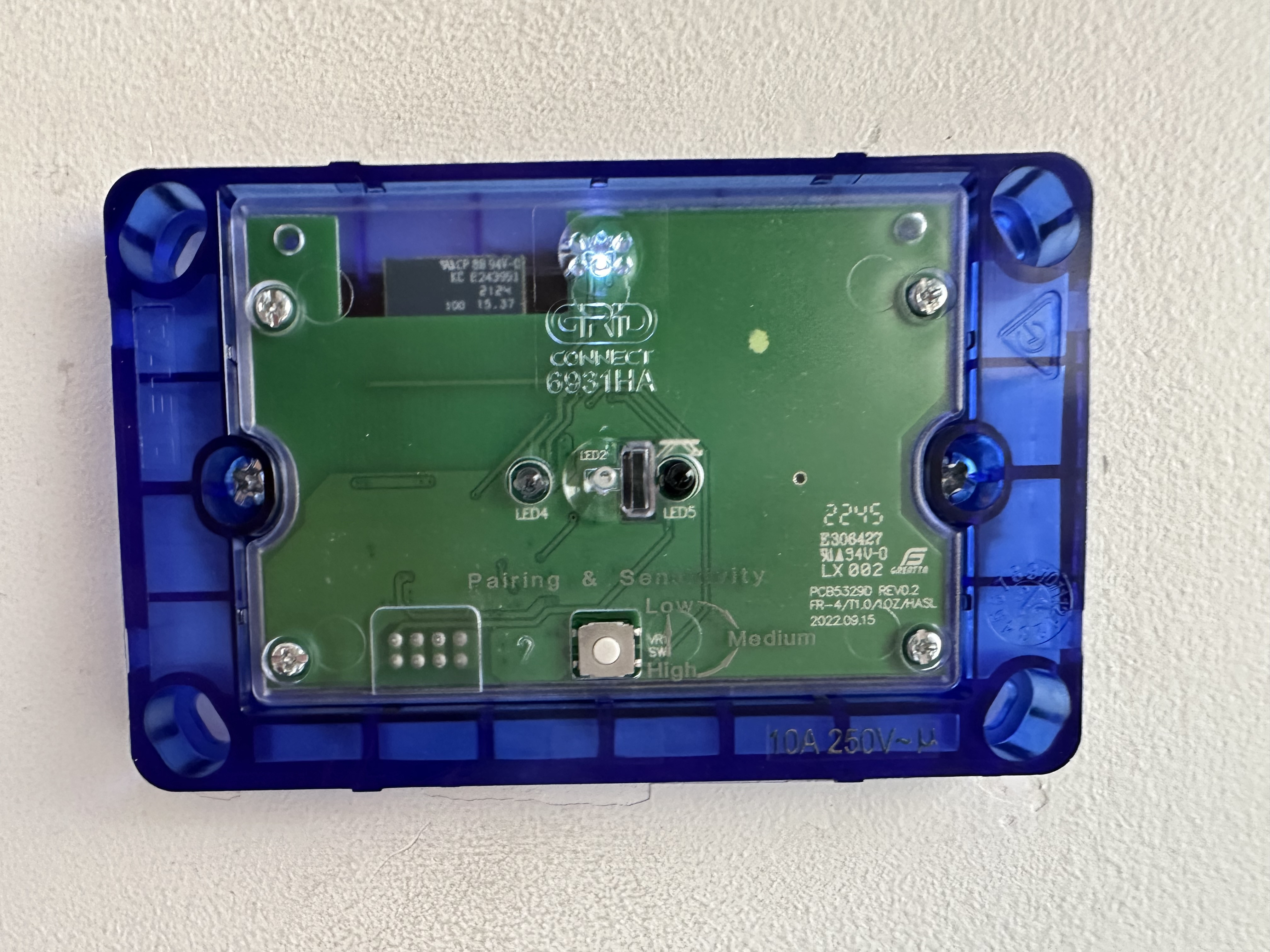

    My unit is the latter one with the three "leds" protruding through the cover. I have attached two photos of the outer, however as it is now installed, I am reluctant to proceed with a disassembly. I used ltchiptool to analyse the unit and it returned the same results as here: UPKESPHome
    I compared the data and yaml with another Deta switch I have and came up with the yaml posted.
    If you have the other version of the switch I would be interested to see the UPK data, maybe I just got lucky :)
    • [BK7231N/CB3S] Deta Grid Connect Touchless Handwave Switch 6931HA - Teardown IMG_1676.jpg (1.7 MB) You must be logged in to download this attachment.
