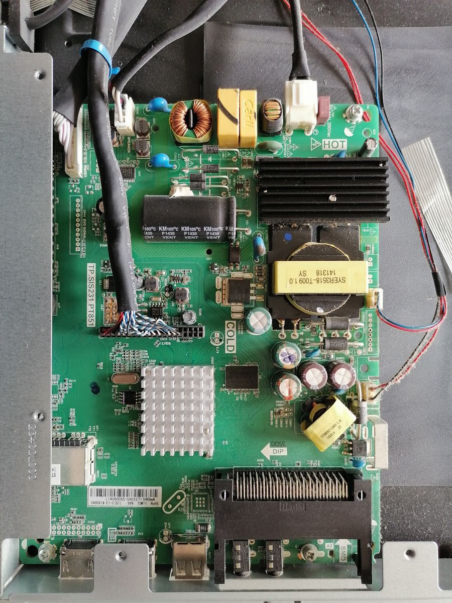

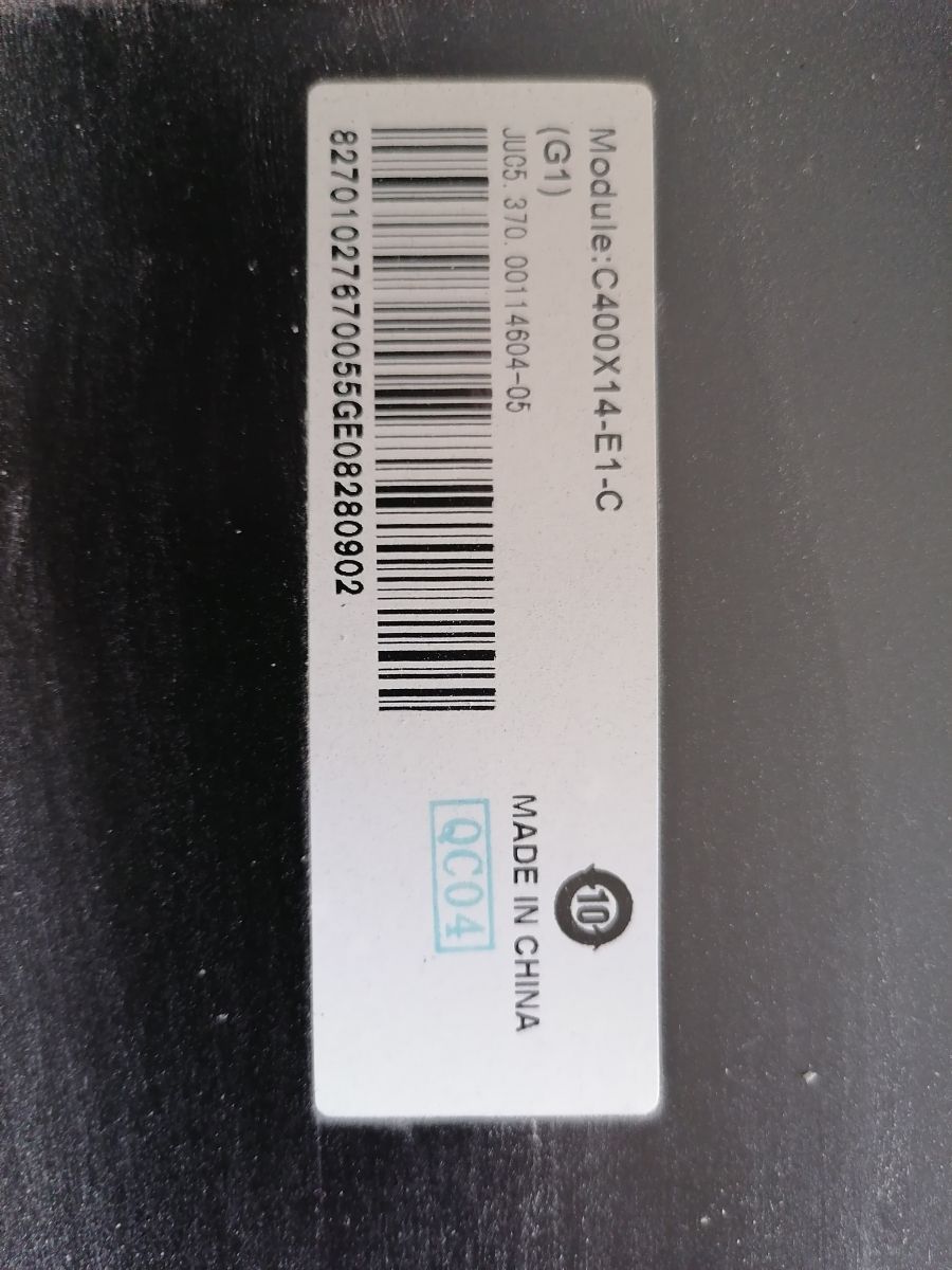

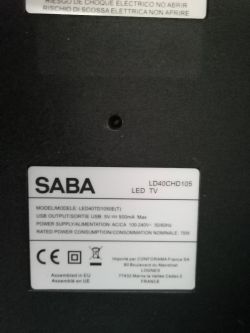

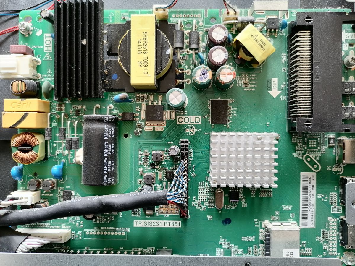

    Hello and sorry for my bad English.
    I'm searching for the French firmware for my Saba TV, but I don't have the serial number!
    I have opened it and here are the pictures I have taken.
    Thanks for your precious help.
    I forgot to say that my TV stays on "initialisation en cours"!

    The software is for one device, with the same specifications
    • CH_LSER( )_FR_V20.0326_40D1050_C400X14-E1-C(G1).rar (5.32 MB) You must be logged in to download this attachment.
  • #3 20711382
    RoyalC
    Posts: 10
    great thank
    i have try , it now quit from "initialisation en cours" but my remote control is not working now !!!
    Any idea ?
    thanks for your great help

  • #6 20712720
    RoyalC
    Posts: 10
    Hi, the keyboard of the remote control doesn't work. When I push vol+, I can see the TV LED blinking, but nothing happens.
    The keyboard of the TV is working fine.
    Thanks for your help. I appreciate it.
