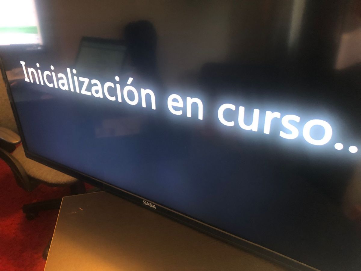

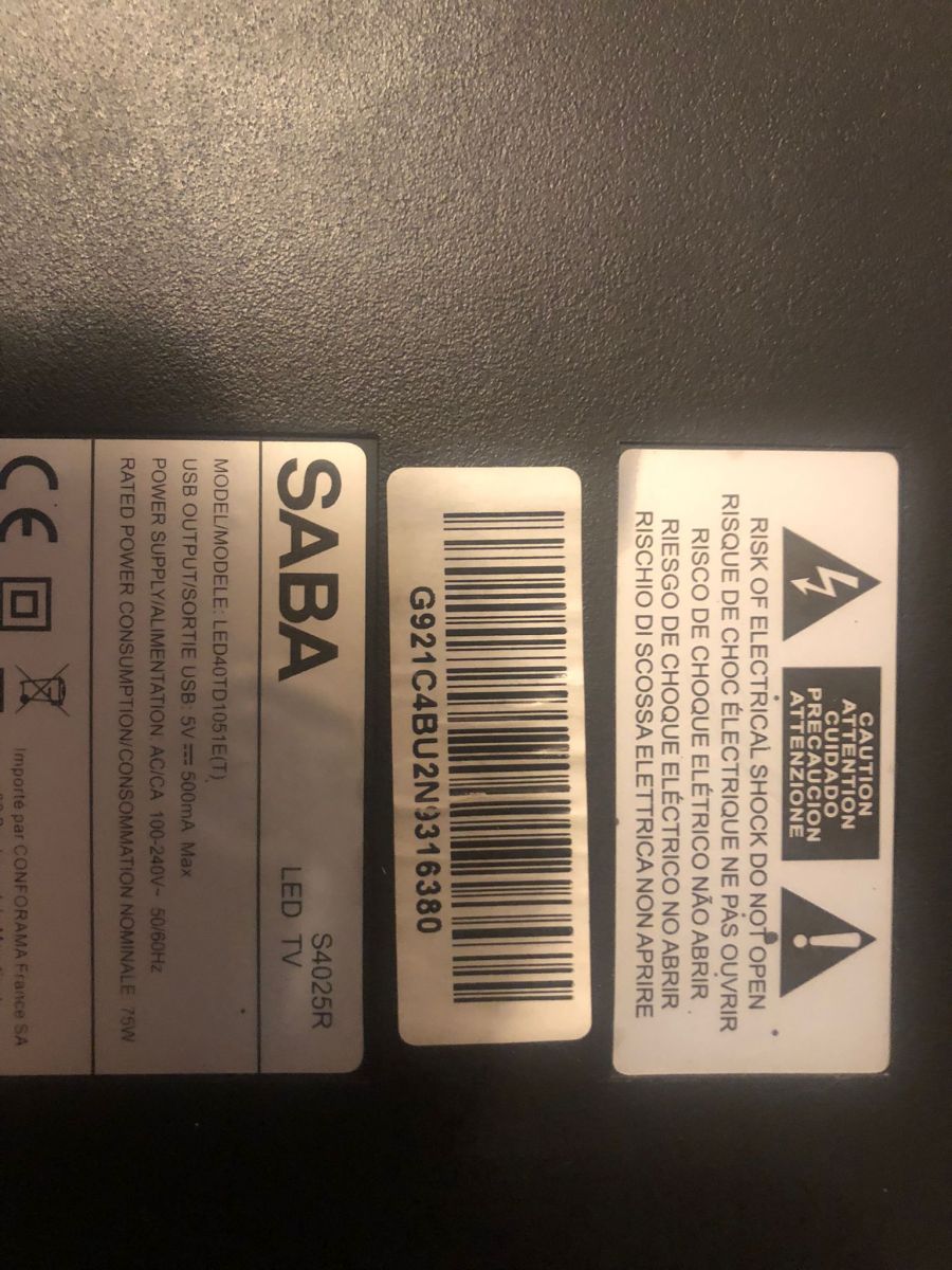

    Procurando firmware para TV Saba modelo LDE40TD1051E(T)
    Boa tarde!
    minha tv SABA fica em inicialização em curso e não sai desta tela.. precisava de ajuda para solucionar este problema...
    desde já agradeço a atenção.

    here is the software
    usb recovery
    copy the file SISEU23X8M_66.bin on an empty usb stick fat32 formatted
    unplug the power cord
    insert the usb stick and reconnect the power cord
    look at the standby led, at the beginning it flashes slowly, after about 1 minute it doubles the speed, update completed
    unplug the power cord, then remove the usb stick
    reconnect the power cord and turn on the tv: it starts in first installation mode
    if it doesn't work with usb recovery, replace the spiflash U5 25Q64 and program a new one with the file SISEU23X8M_66.bin

    viniciusmaiaeng
    muito obrigado!!
    a tv saiu desta tela de inicialização, atualizou conforme descrito. agradeço imenso por sua ajuda!

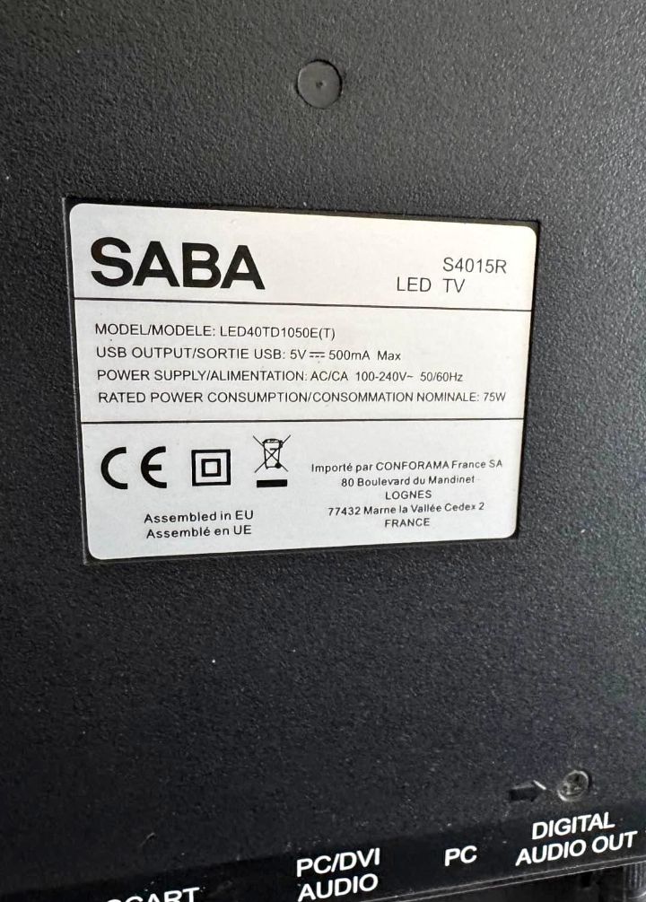

    My Saba TV s4015r has the same issue, I need a software for the TV pls!
    post a photo of the sticker on the back of the tv
    or write the serial number: it starts with G9
  • #8 21463877
    raulselegean95
    >>21463758
    Label on SABA television.

    for S4015R, try with this file
    • SISEU23X8M_66.bin (6.58 MB) You must be logged in to download this attachment.
  • #10 21464502
    raulselegean95
    And how to do it? Just plug the USB in the TV? Can you explain to me step by step?

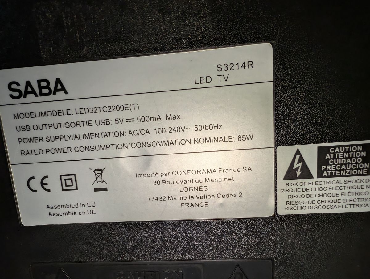

    My Saba TV S3214R has the same issue. I need software for the TV, please.

    for SABA S3214R
    if mainboard code is TP.SIS231.P83 and panel code is M320X13-E3-L(G3), use this software
    otherwise, specify the mainboard and the panel code
    and, if present, write the serial number (it starts with G9...)
    • V20.0359.zip (5.28 MB) You must be logged in to download this attachment.
  • #14 21731515
    gerardor
    It works for me. Thank you so much, you've given my TV a second life.
