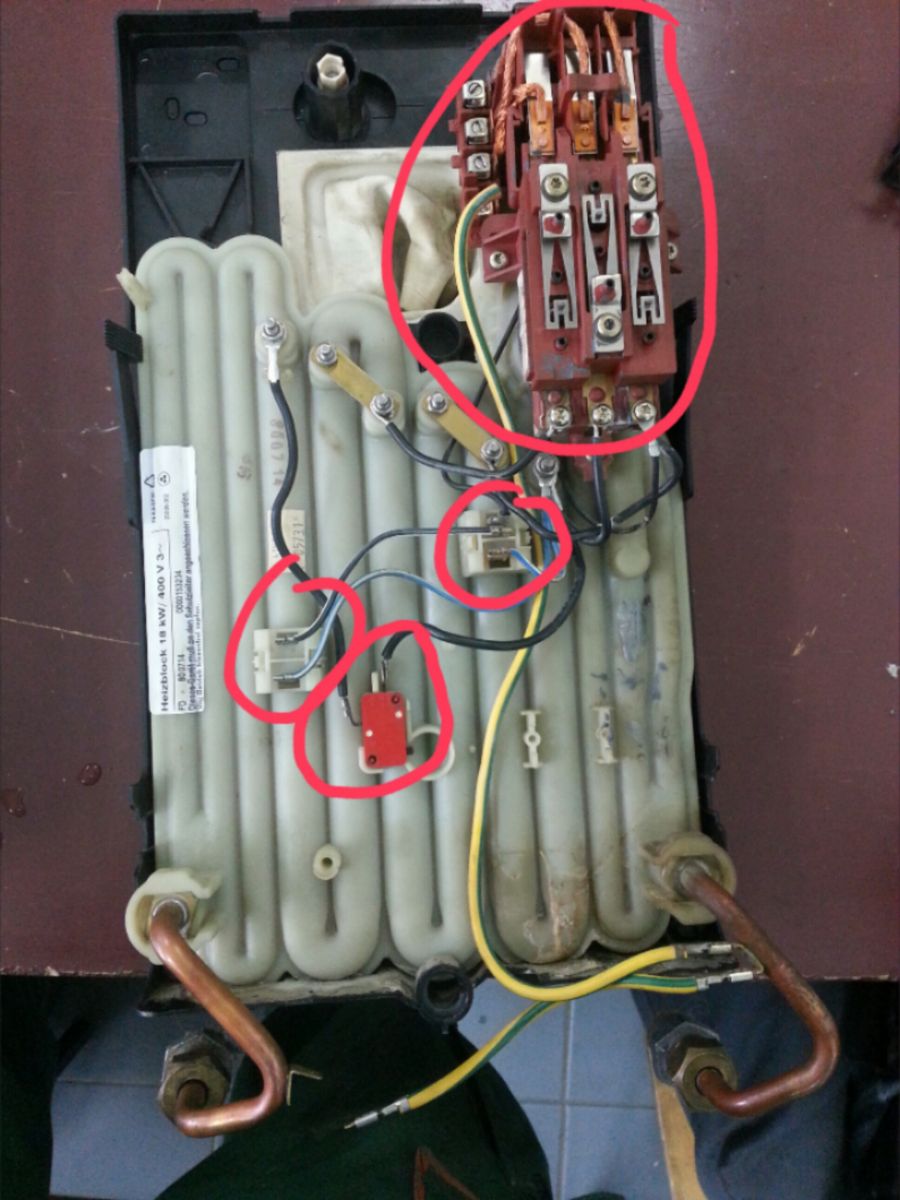

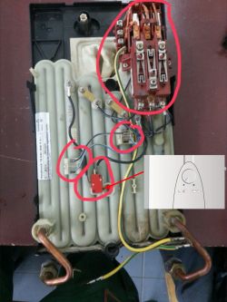

    remunnerado
    Hello good Morning. I have a Junkers ED18-2S water heater model very similar to the Siemens DH18200 water heater. Could someone please tell me what I need to do to increase the water temperature? Thank you very much in advance.Interior of a water heater showing electrical components and wire connections.

  • #3 21044110
    W0jtek92
    Posts: 3852
    Help: 469
    Rate: 1255
    Hello. The heater is very simple in design. The lower the flow in the tap, the warmer the water (this is how we regulate the temperature; if the flow is too low, the heater will turn off). These heaters are suitable for washing your hands in the sink when there is barely any water, but I wouldn`t count on a comfortable shower in this case.
    Regards.
  • #4 21044113
    misiek1111
    Level 37  
    Posts: 4052
    Help: 322

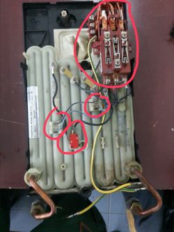

    Rate: 1083
    Water heater with highlighted electrical components and wires.
    It has 18kW, you can easily take a shower in Spain.
    If it`s too cold, it`s possible that one/two heaters are damaged or not getting power.
