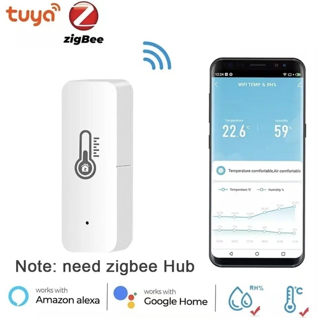

    ZigBee temperature and humidity sensor with smartphone app display.
    I use this type of sensor, the battery lasts half a year (sensor is located near the router) I once caught 2 pieces on promotion for 30pln (total)
  • #8 20848452
    areka9
    Posts: 88
    Rate: 16
    Well but on the screenshot it says it needs a zigbee hub? So it won't connect the sensor directly to the wifi router?
  • #9 20848557
    kasjo
    Level 26  
    Posts: 770
    Help: 94
    Rate: 89
    I quickly pasted a picture from the internet and this is what I found :)
    I mean this type of lozenge, on wifi there are also such.

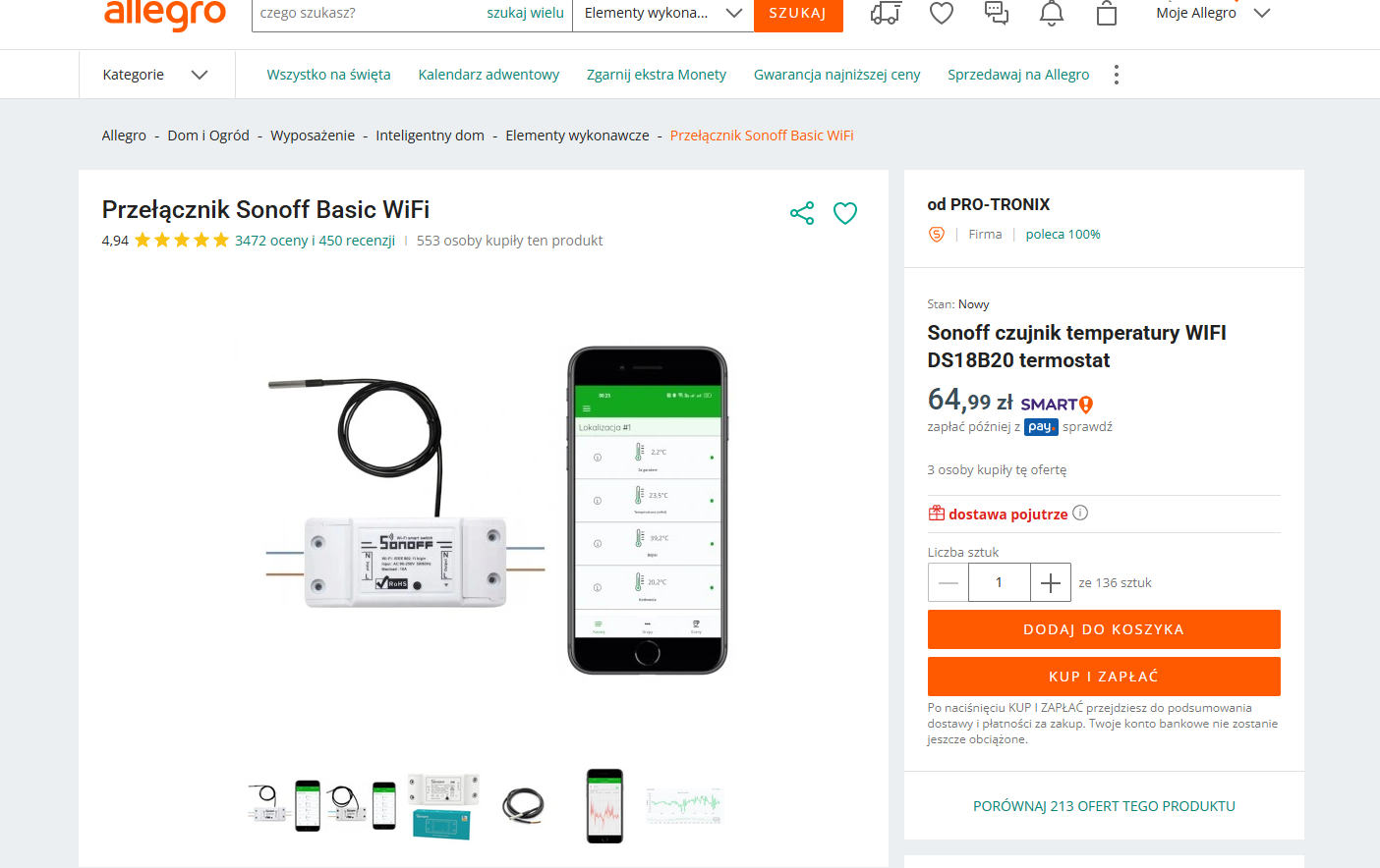

  • #10 20848603
    ChatGPT
    Posts: 86
    Rate: 20
    search for "WiFi temperature" Product page of Sonoff Basic WiFi switch with temperature sensor on Allegro. .
