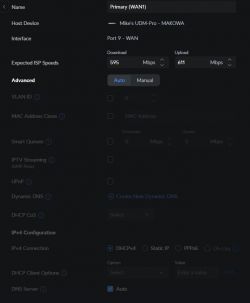

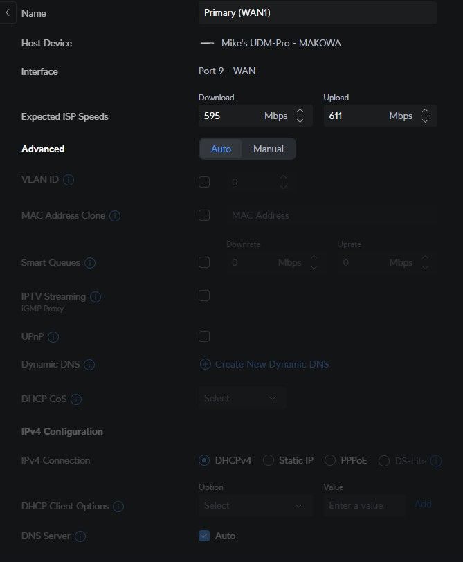

    lordleoric
    >>20863595 .
    Hello everyone,
    I recently got a fibre optic cable and took internet from INEA 600 as they were the only ones offering a symmetrical connection.
    I was searching the internet for settings for INEA and came across this thread. The first thing I did was to start with VLANs but none of them worked. It turned out that on my UDM-Pro, just leave everything on auto and it works! :)
    Greetings everyone. I hope this helps someone.
