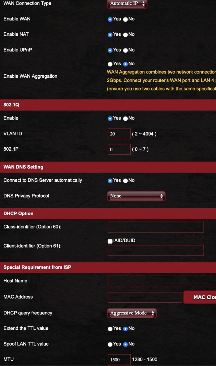

    Need help setting up Inea for fibre investment 1000/300.
    I have received.
    ONT : Huawei echolife HG8010Hv3
    Router : ZTE ZXHN H3640.
    Please help to configure this as I have 2 weeks left to terminate my contract.
    my router is an Asus GTAX6000. Config wan as in the screenshot .
    How to check what VLAN and how to do it HELP PLIX.
    Screenshot of network configuration for Asus GTAX6000 router showing WAN, VLAN, and DNS settings. .

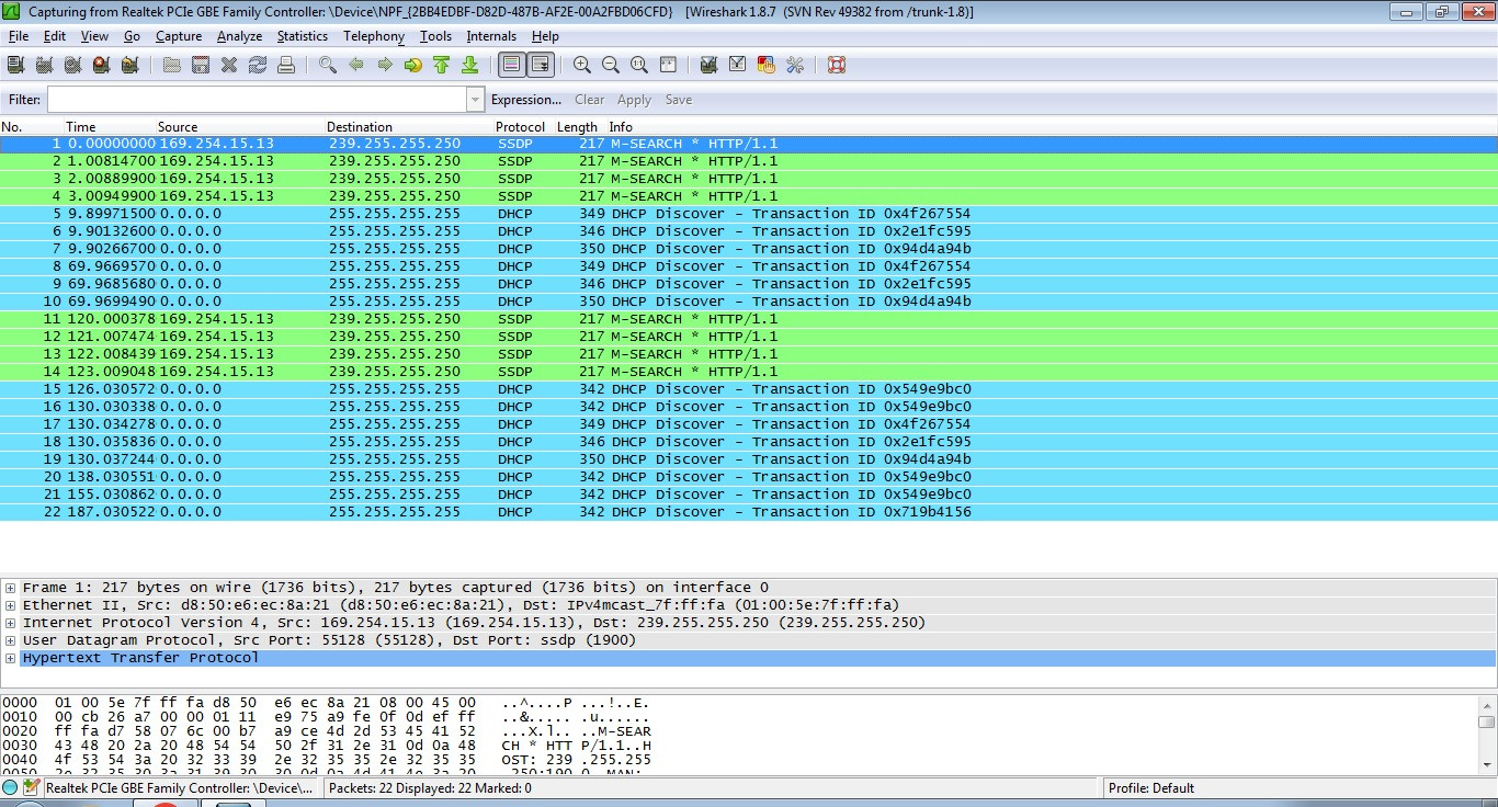

    Hi, it is possible that they are running on a different VLAN in your region. I'm not an expert so I don't know how this should be done according to the art, however I did the following:
    - Downloading WireShark
    - Connecting the INEA router (ZTE) to the power supply, without ONT.
    - Waiting a while for it to boot
    - Connecting the computer via ethernet to the ZTE to the WAN port
    - Start WireShark
    And in WireShark I found out what VLAN it was calling for.

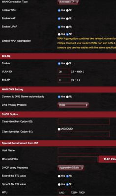

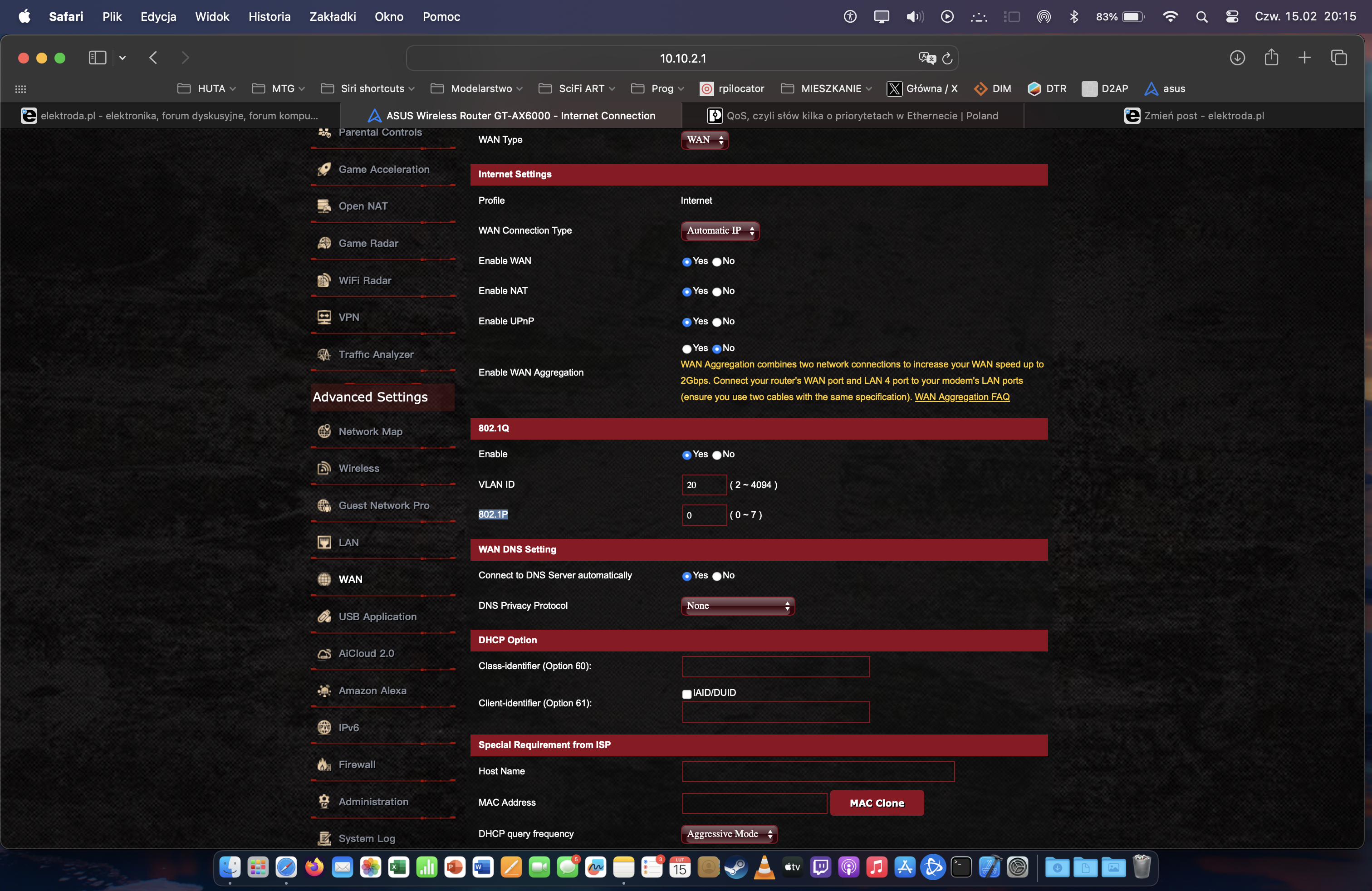

    Colleague orbit is not upset, I am still in the process of configuring, network iot etc. and in euphoria that I do not have to terminate the contract :) .
    My configuration on the Asus:
    Screenshot of the ASUS router configuration interface showing WAN settings. .
    Brwinów near Warsaw / 05-840
    Vlan 20
    DNS (all available ones work for me)
    Mac address I cloned, but it worked without the clone.
    We have this Mordo!!!!
    I took 4gsm (porting)+ Fibre from them.
    I've already walked on knives with them today, either they give data or out and I go to orange.
    Contract just signed.
    I was worried about PPPOE and here I didn't even clone Mac.

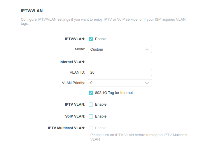

Manual WAN VLAN 20 Worked on several Światłowód Inwestycje installs Confirmed on Asus, TP-Link, Redmi, EdgeRouter cases
