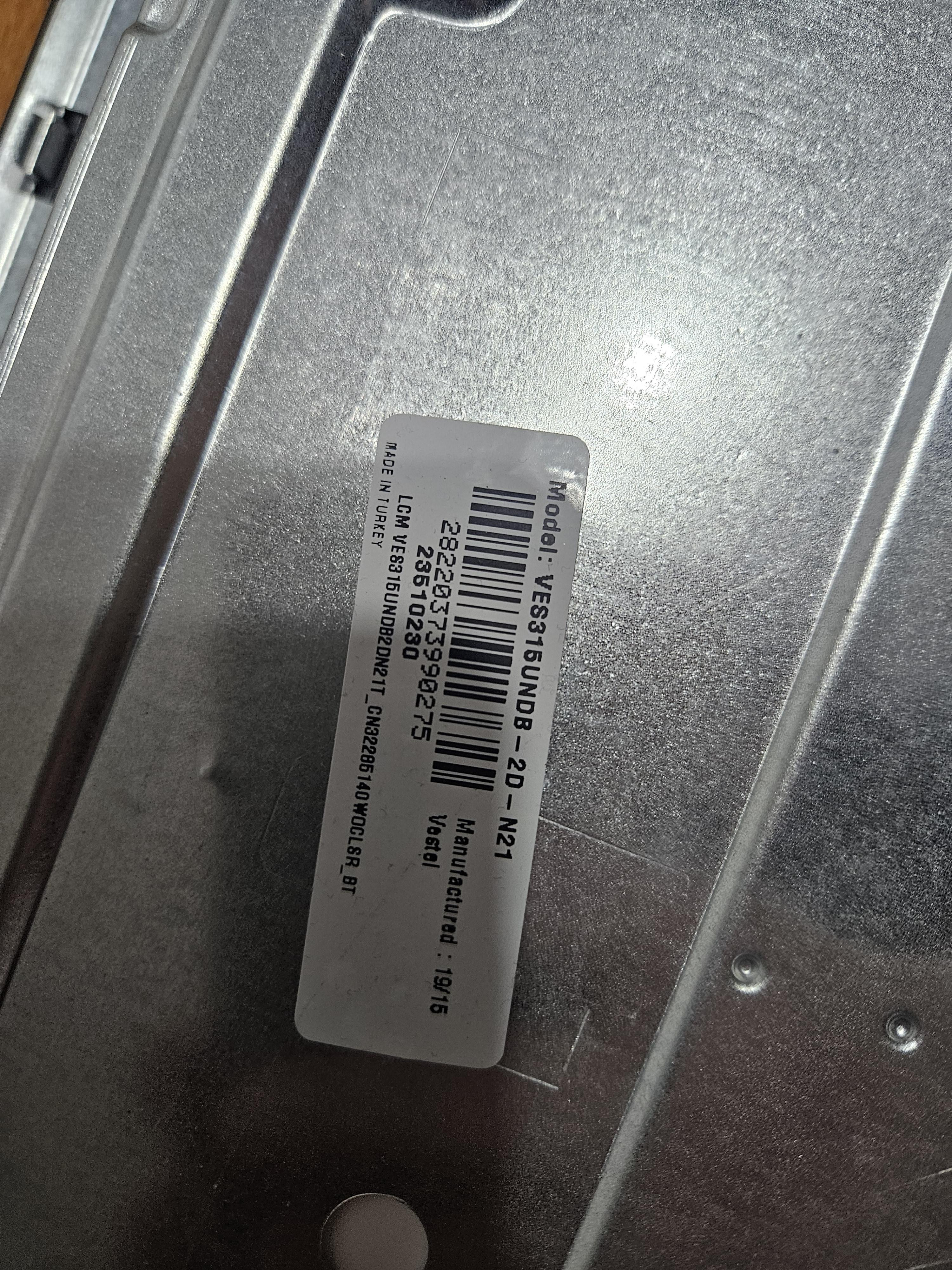

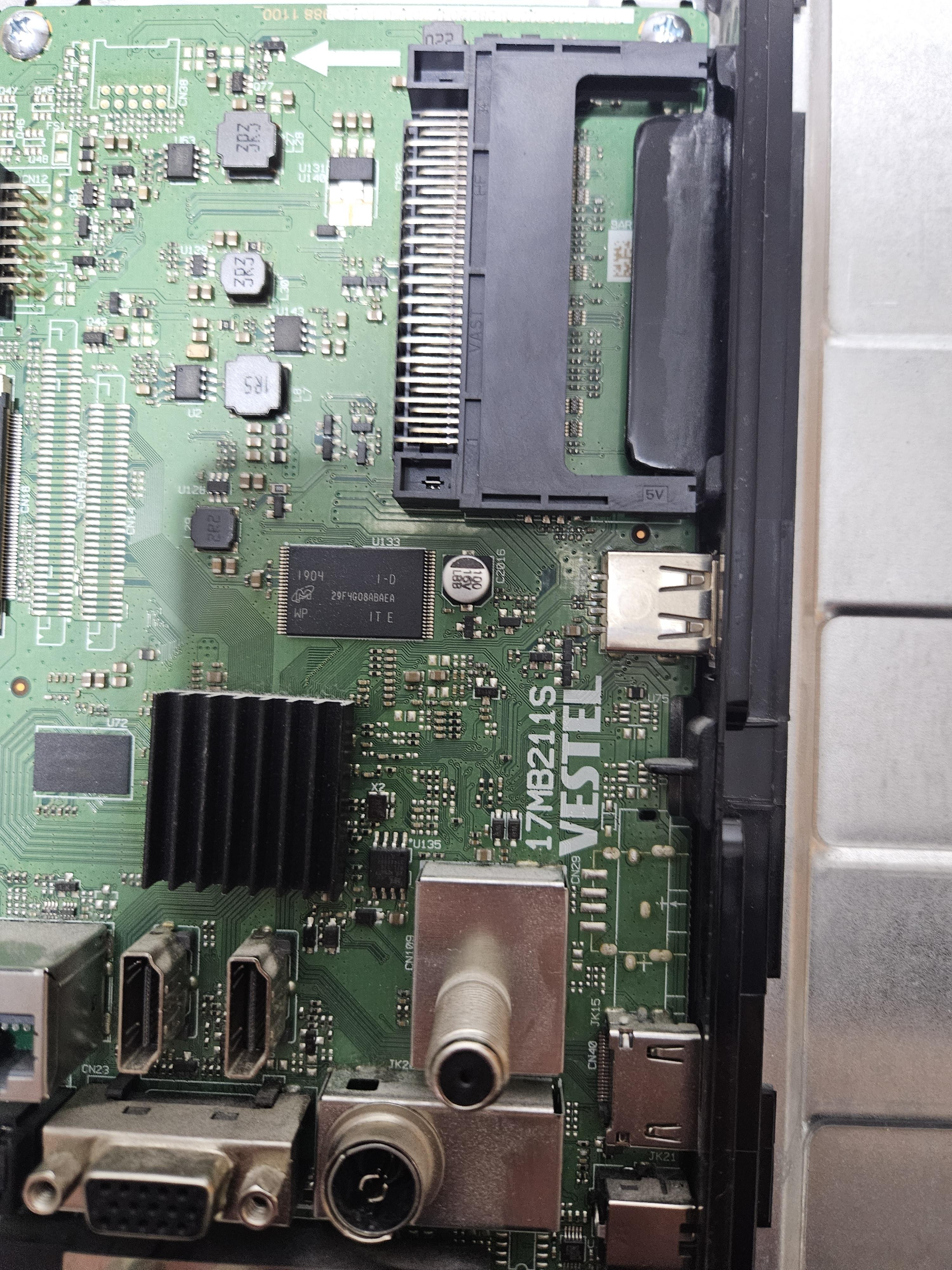

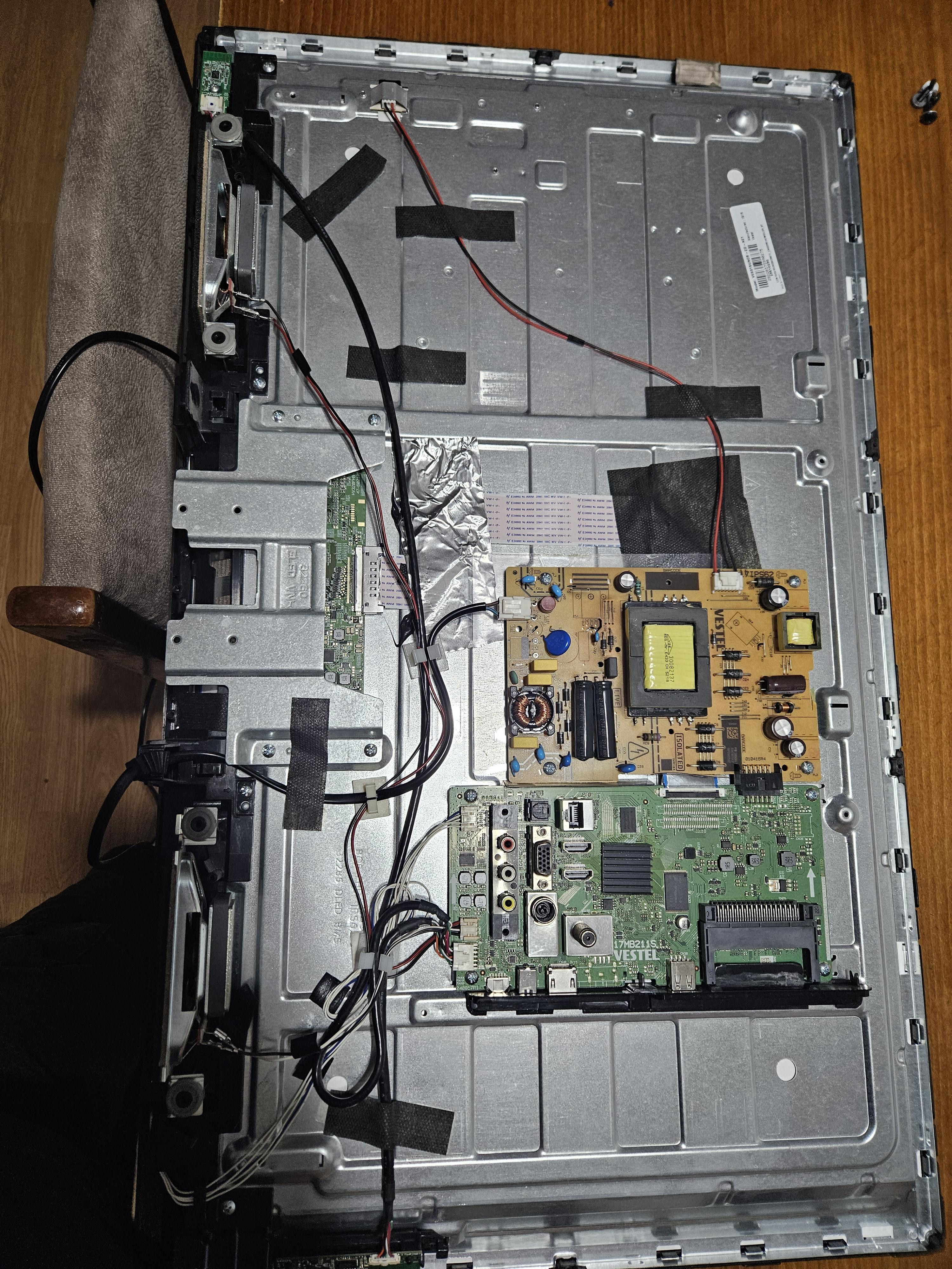

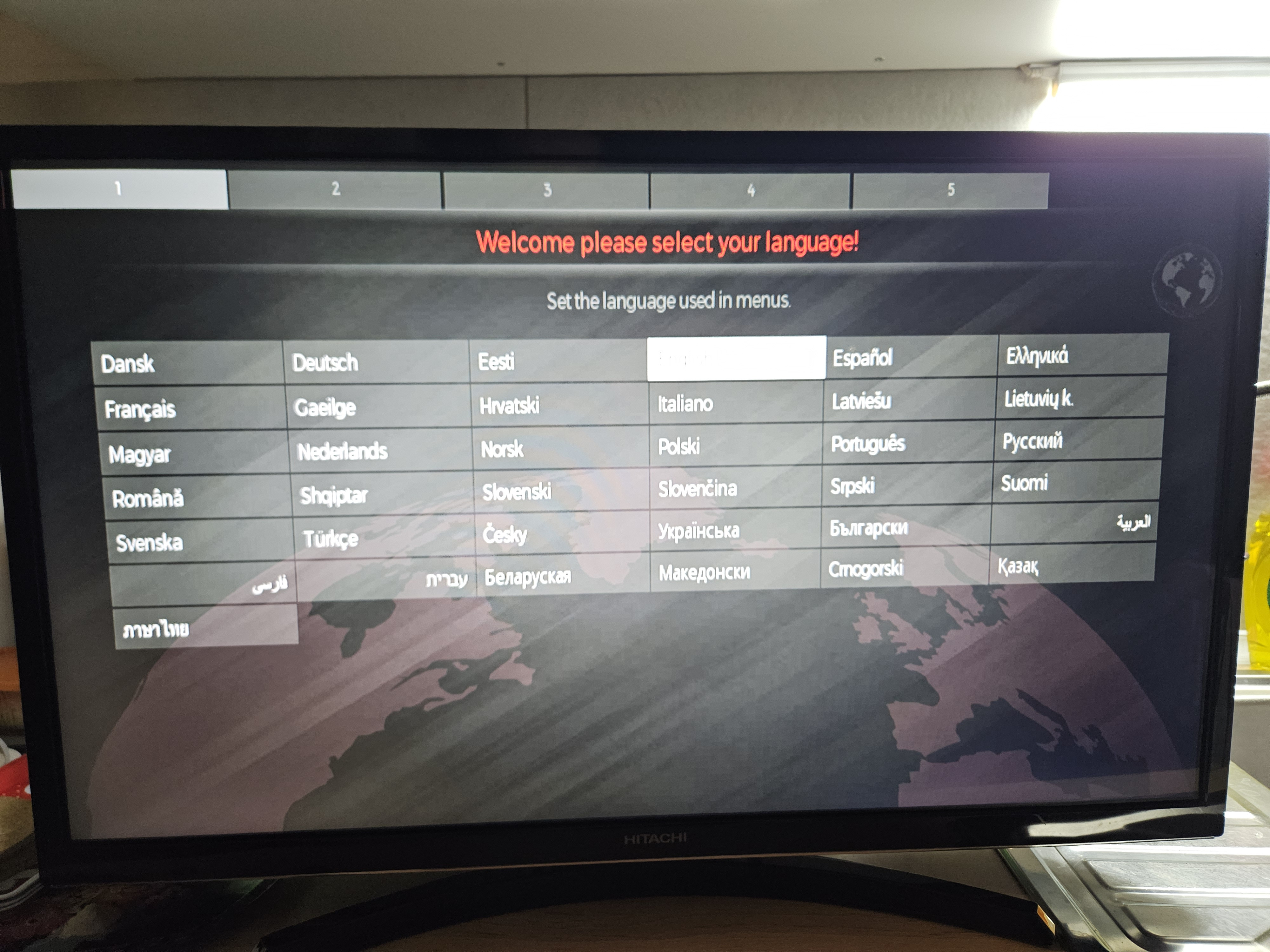

Firmware Needed: Hitachi 32HE4000, 17MB211S, VES315UNDB-2D-N21 - Boot Looping, installed incorect fi

    Except for the command, is the image correct?

    1. Look for a Tosiba remote control in the hope that it has the same code
    2. You use a programmable remote control
    3. You use a remote control with memorized codes
    4. Buy a programmer (CH341A) and rewrite the flash memory with the correct bin.

    If you can get a Toshiba remote, I'll help you get it working with the original remote

    The JVC remote control has the code RCA2_43XX
    The Toshiba remote control has the code Rc48XX_2D
    The Hitachi remote control has the code RCA3_48XX
