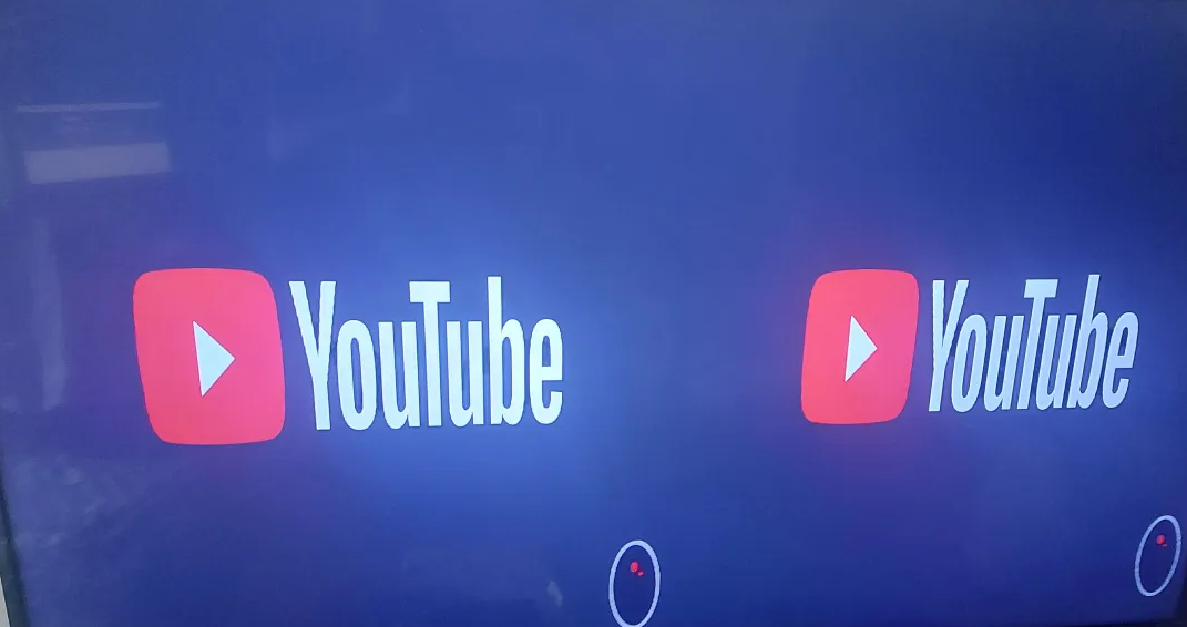

    Hello, I am looking for firmware for 17MB130S Himachi mainboard.
    Model TV: Himachi 55HK25T74U J
    Panel Model: 17IPS72
    Found a smart TV outside, took it home. It was turning on, but off. I thought it was the firmware, so I decided to download a different one. I took one for Toshiba, but it still did not turn on. Then I changed the panel model, and it turned on and works. However, the firmware for the TV wasn't correct. The only one that I have found was for 17MB130S, but a different type of TV. It was something 50HK, and everything was YouTube works, but I have a double picture on my screen. In the factory menu, I can't change anything. Please help me.
    Thank you!!!
    TV screen displaying a double YouTube logo. Double image on TV screen showing a girl holding a microphone.

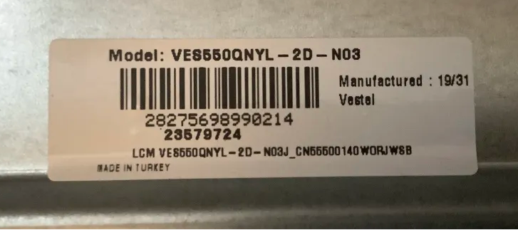

  • #3 21095365
    elthant223
    Sorry for not answering for a long time, here is what information that I have found inside of the TV, is this panel code? VE8550QNYL-2D-N03
    Label on the interior part of a TV with panel code and manufacturing information.
  • #4 21097692
    billobirillo
    Posts: 1141
    Help: 338
    Rate: 798
    try installing the usb panel bin files
    the files are for panel VES550QNYL-2D-N01
    maybe they can work on the panel VES550QNYL-2D-N03 too
    otherwise, I can provide you the complete software of a JVC with the same panel VES550QNYL-2D-N03
    unfortunately you will have to change the remote control

  • USB firmware update still fails with read error
    #5 21098001
    elthant223
    While attempting to use your firmware that you gave me, when I was in the Service mode and pressing USB operation, the screen became black for a second and said could not read. I still have followed all of the instructions that you gave me, but nothing has changed. My USB is formatted as FAT32, and I tried 3 times to do this; nothing has changed. I have tried my way by unplugging the power of the TV, plugging it back, and holding OK on the remote and pressing the turn on button to update firmware, but nothing has helped; it said error as well.
