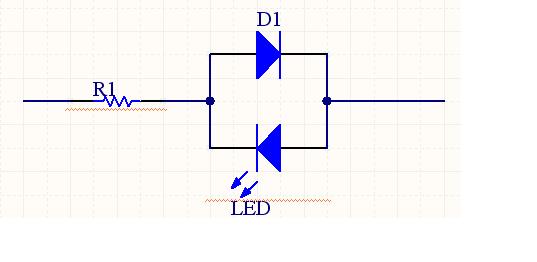

    I have a question, are there any LEDs or the like under alternating current (AC) from the transformer?
    The voltage I can get is 12V or lower.
    I don't want to do any DC rectifiers.
    BEST REGARDS

    You only insert the limiting resistance and problem solved. In the positive half of the sine the diode will be lit and in the negative half it will work in reverse mode (it will not light). This topic has been discussed many times on the forum, do a search.
    LEDs have a low value of the allowable reverse voltage of 3-5V. If you get 12V from the transformer, then you need to connect an anti-parallel rectifier diode or LED to the diode.

    at 12V it is not necessary to look at the reverse voltage yet ... at 1k Ohm the diode will be lit (in the dark you will notice its blinking vaguely, it will be these half positive sine waves :) but that's right that the diodes have a small reverse voltage, so at higher voltages you need to be careful, but I don't see a problem with such a diode to turn it on at 230V, a very large R will shine, olo999 or maybe it's better to put the diode in series ... ?? what's the difference?

    DEMkO wrote:
    at 12V it is not necessary to look at the reverse voltage yet... at 1k Ohm resistance
    It's like connecting a 100V to 200V rectifier diode. In the reverse direction, a current of a few hundred nA flows through the LED, almost the entire 12V will be deposited on the diode, because with such a small current, the drop on the 1k resistor will be very small.

    then why can't I burn the LED at 25V AC??
    and if the diodes are connected in series and the one has a much smaller reverse current, the other one will also automatically receive such a current

    And how long did the diode work in such conditions? It's not about the current, it's about the reverse voltage. I guess the manufacturer gives this parameter for a reason.
