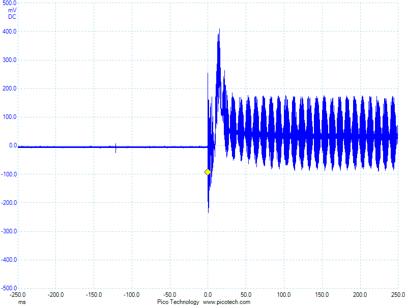

Which LED driver or transformer will reliably run Integral ILMR16NC033-3 MR16 LED lamps in UK low-voltage track lighting without flashing or overload trips?
A Mean Well DC LED supply is the best specific recommendation in the thread, especially the APV-16-12, with the HSG-70-18 also suggested as a workable option [#21682002][#21682008] For 12V AC-rated MR16 LEDs, the lamps may actually be more stable on about 15–18V DC rather than a nominal 12V AC output [#21682002] If you want to experiment, test the lamps from a DC bench supply to find the minimum stable voltage and then add some margin [#21682002] If you stick with the existing AC-style setup, adding a bridge rectifier before a smoothing capacitor is the suggested fix; a capacitor alone on the AC output will not help [#21682007] The APV-16-12 was specifically noted as promising because it has a detailed spec sheet and low ripple, though its short-term overload behavior was still uncertain [#21682009]

TL;DR: For 3×5W MR16 LEDs (15W total), start-up flashing comes from ~10 ms inrush tripping “fast” protectors—“draw a spike of current when turned on.” Use a DC driver with brief overload tolerance or switch on the secondary. [Elektroda, Anonymous, post #21682000]

Their internal drivers draw a brief inrush that can exceed a driver’s fast over‑current threshold. The thread measured about a 10 ms surge. Some users saw stable operation if fewer lamps start first, then the rest are connected, or if the switch is on the secondary. Choose drivers with delayed/forgiving protection. [Elektroda, Anonymous, post #21682000]

What ripple or noise should I expect from cheap ‘12V LED’ supplies?
The thread captured bursts of many kHz every 1 ms, making the “DC” look AC‑like above ~1 kHz. Such ripple can upset MR16 driver ICs at startup. Pick a supply noted for low ripple, or add proper rectification and filtering. [Elektroda, Anonymous, post #21682010]
