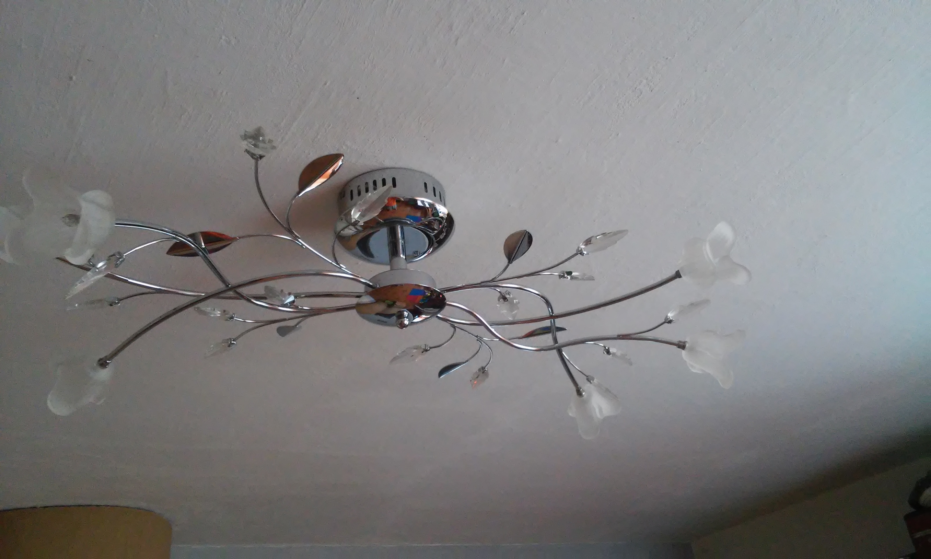

    Rate: 7
    I bought some 2W and some 3W. All AC / DC.
    Generally, there is space for 19 bulbs in one chandelier.
    And now like this:
    - Putting only one 2W LED is OK,
    - Putting one 2W and one 3W both shine well for half a second and then dim to about 50%,
    - Putting all the LEDs (19), everything shines cool at 100% and the effect is MUCH better than with halogens, but ... the LEDs flicker gently,
    - By inserting only one type of LEDs, e.g. 10 LEDs of 3W (leaving the rest of the G4 inputs empty), the LEDs flicker quite strongly.
    The question is where does this flickering come from and is it harmful to the LEDs? Ie. can they burn through it or something?
    Why are there different effects depending on the configuration? Is it necessary to calculate some appropriate power or distribution of LEDs?
    edit
    One "slot" G4 was still free, I bought too few LEDs for test. I added halogen there and nothing flashes anymore.
    In the second chandelier, where there are fewer entrances (only 10), 4 LEDs did not work at all - they lit for a fraction of a second and turned off. As I added all 10 of it all works.
    Probably a matter of the chandelier itself. I will buy the missing LEDs and it should be OK.

  • #23 15922308
    Zbigniew 400
    Posts: 4356
    Help: 283
    Rate: 794
    In the other chandeliers you have to replace the power supplies / for leds /. You have halogen power supplies that require a minimum load, so there must be one halogen.

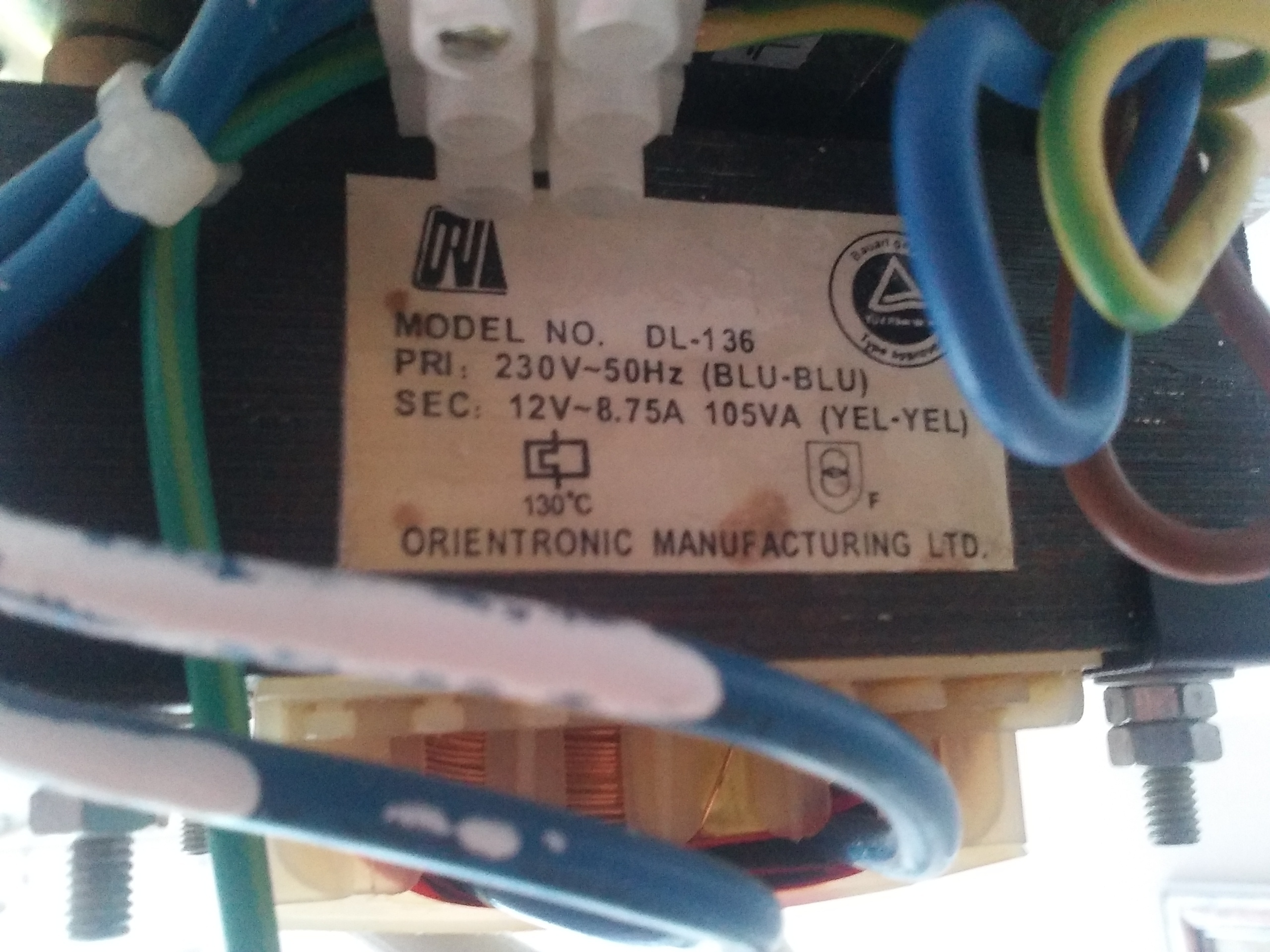

    Thanks, the power supplies were actually under the ceiling and they are actually electronic halogen power supplies.
    I am attaching a photo of this low-noise power supply that does not allow the LEDs to light up without halogens.
    I have the green light for replacement.
    Now the questions:
    1. What kind of power supplies to buy instead?
    2. How to remove / install it? :-D Turn off the plugs and just unscrew, replace the +/- cables and it's ready?

    Zbigniew 400
    Posts: 4356
    Help: 283
    Rate: 794
    It's best to buy transformers / failure-free /. Oversize approx. 30% or more.

What’s the cost payback?
Replacing thirty 10 W halogens with 2 W LEDs drops usage from 300 W to 60 W, saving 240 W. At €0.25 /kWh and three hours daily, annual savings reach €66; payback on €45 of LEDs is under nine months [Author calc, 2025].
Any edge cases to watch?
Avoid silicone-potted COB capsules over 2 W. They trap heat, degrade capacitors, and may fail catastrophically [BatSk8, #15977665]. "Heat is LED enemy number one" [a_noob, #15977665].
Can I use DC-only LEDs later if I pick an AC transformer now?
No. DC-only lamps need rectified output. Choose a DC driver if you want that option. AC/DC rated LEDs work on either supply, giving maximum flexibility [a_noob, #15970468].
Does LED colour temperature matter in halogen replacement?
Yes. Warm-white 2700–3000 K LEDs mimic halogen colour and avoid harsh glare. Many G4 capsules offer 2700 K variants at ~90 CRI today [Philips, 2024].
