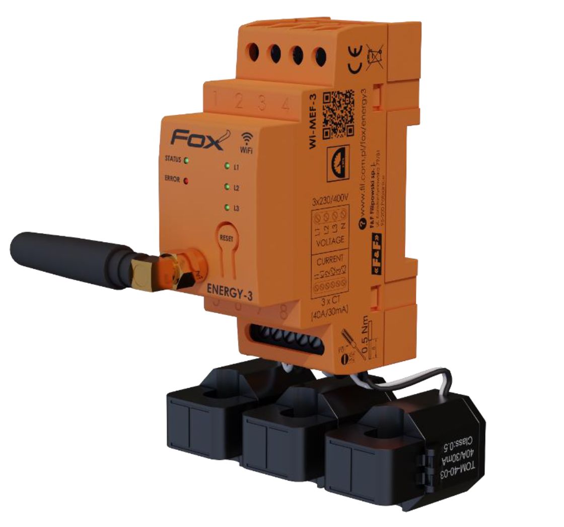

    The FOX ENERGY-3 (commercial index WI-MEF-3) offers indispensable support in controlling energy consumption and monitoring electrical network parameters. Due to its characteristics, the WI-MEF-3 is excellent for, among other things, energy control and billing in homes and rental flats. The WI-MEF-3 is also worth considering if you are planning renewable energy installations such as heat pumps and photovoltaics. Why do we recommend the FOX ENERGY-3 monitor for these applications?
    The Wi-MEF-3 is a bidirectional, 4-quadrant monitor for single-phase or three-phase network parameters. It needs a WiFi network with internet access to function correctly. The device is mounted on a DIN rail. To measure energy, the FOX ENERGY-3 uses three miniature current transformers measuring 25x25x50 mm, which fit easily even in a small switchboard. The transformers are equipped with an opening core so that they can be clipped onto existing current conductors without having to disconnect them.
    Orange FOX ENERGY-3 energy meter with three current transformers.
    FOX ENERGY-3 with connected transformers

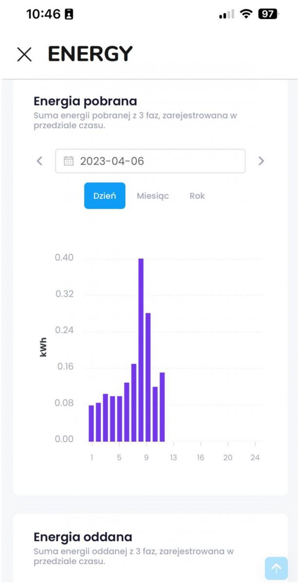

    - Analysis of energy consumption on a daily, monthly and annual basis;

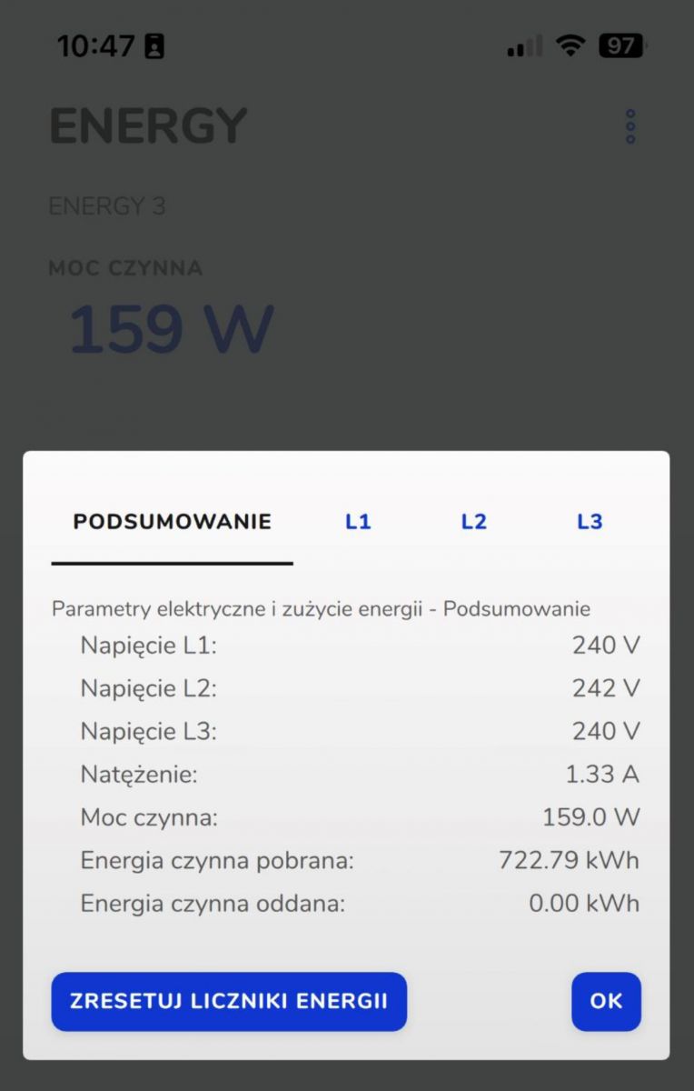

    - Control and recording of all relevant electrical network parameters: powers, voltages, currents. Minimum and maximum values of the measured parameters are also recorded, which can be used to detect problems with the photovoltaic installation and excessively high mains voltage.

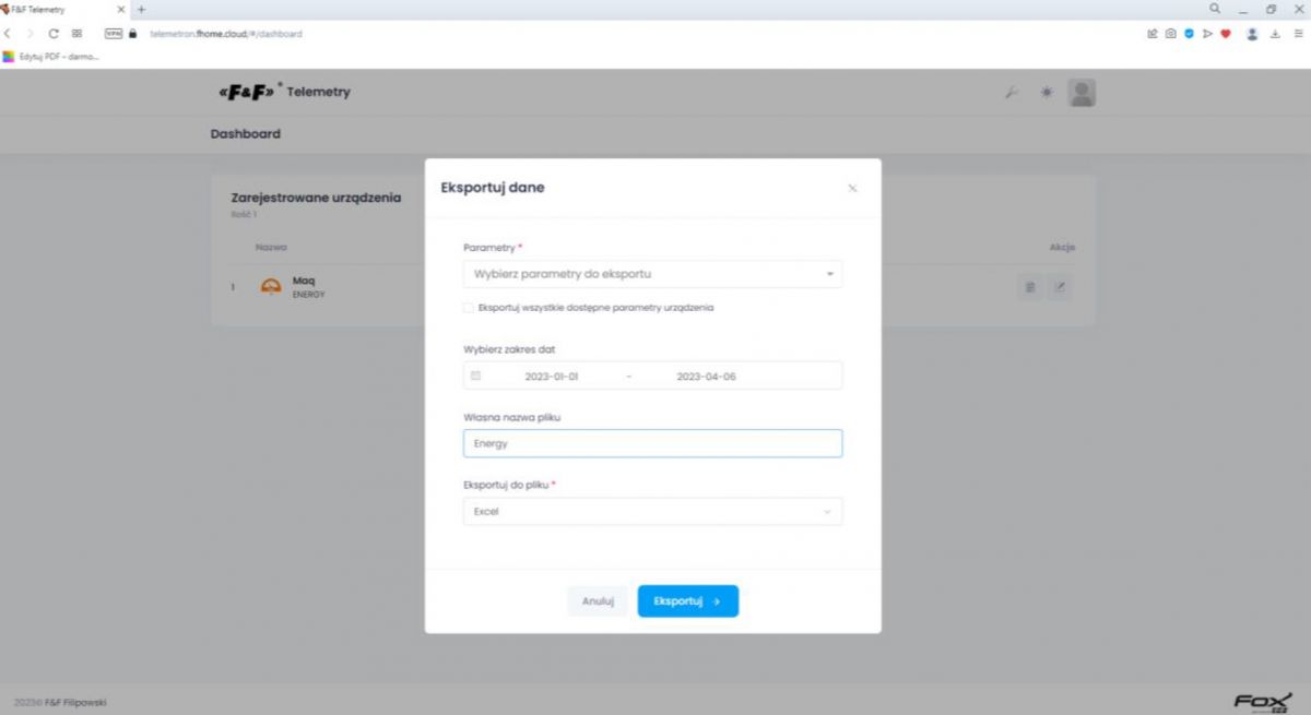

    - Export of recorded measurement results to csv and excel files.

    Screen of the FOX ENERGY-3 mobile app displaying electrical network parameters. .
    FOX mobile app - view network parameters
    Bar chart of energy consumption on the FOX mobile app screen. Mobile application - Bar graph (active energy consumption)
    Mobile application - Bar graph (active energy consumption consumed) .
    View of the data export window from the F&F telemetry application on the website.
    View of data export to Excel from www.telemetron.fhome.cloud

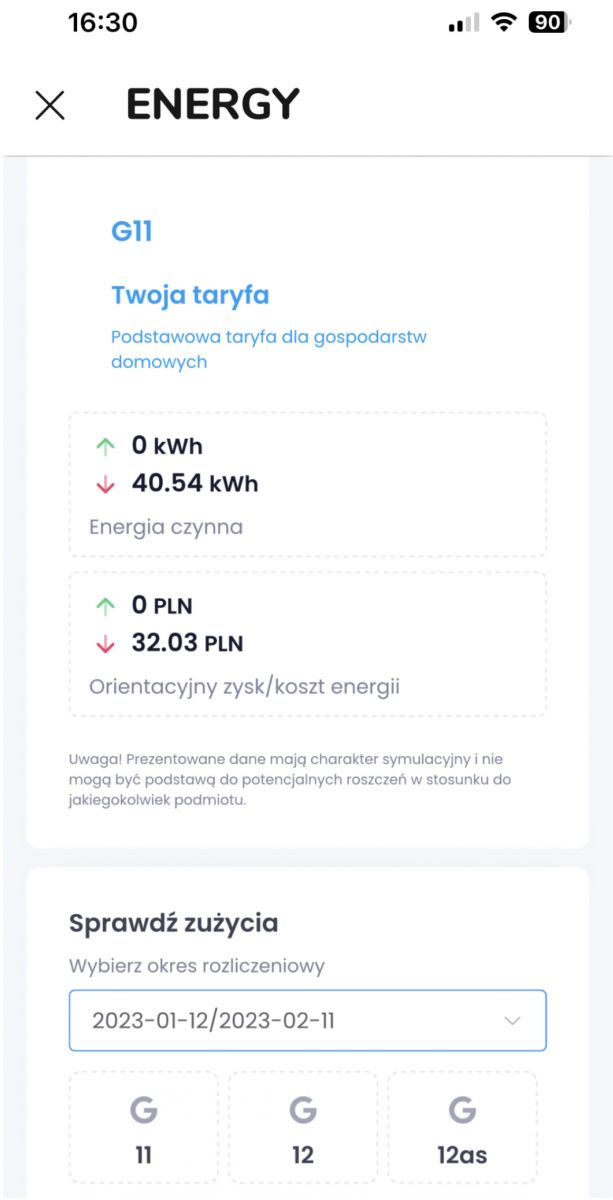

    For both solutions, the starting point will be the analysis of energy consumption and historical consumption data, which can significantly determine the use of the FOX ENERGY-3 energy monitor. The FOX ENERGY-3 energy monitor has a unique feature that helps in the selection of the main energy tariff according to which energy consumption is billed. This is made possible by performing calculations that show what the energy bill would look like if a different tariff were selected. As the solution is based on actual energy consumption history, it reliably indicates the optimum tariff for each home, with a consequent measurable effect on reducing electricity bills.
    FOX ENERGY mobile app interface with energy consumption details. FOX ENERGY mobile app interface with energy consumption details.
    FOX mobile app - fare preview

    A rather cool and interesting device.
    Why do you write that
    , "The transformers are equipped with an opening core so that they can be clipped onto existing current wires without having to disconnect them", and in the video posted on YT you are still connecting it with wires to the top screws.

    I had the opportunity to test this monitor FOX Wi-Fi control system from F&F while businesses and homes will usually use 3f, in flats and smaller premises the single-phase WI-MEF version is useful. You can try to optimise consumption under a selected tariff, rewarding a reduction in consumption at certain times or days.
    @szeryf3 are you referring to voltage terminals?
