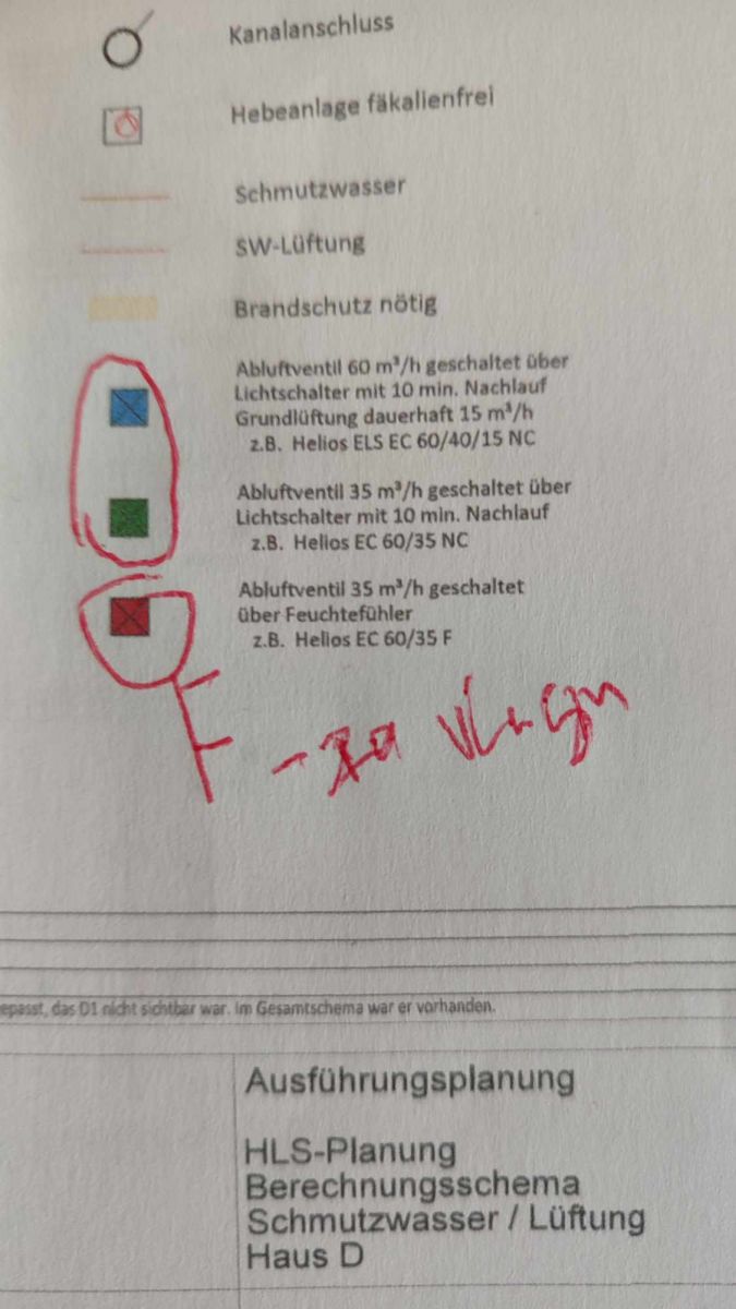

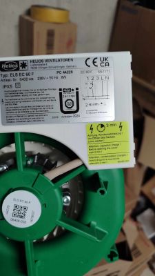

    Hello colleagues, I own this fan and I am wondering how to connect it? My opinion is the direct phase to L, the neutral conductor to N and the return phase from the switch to number 2, will it work properly like this and what other role does this fan have, does it activate itself on moisture? Tnx
    Helios fan with nameplate and wiring diagram.
    Added after 15 [minutes]:
    Fan wiring diagram with colored markings and a note about the humidity sensor.
    This third one, marked in red, says that it works on a moisture sensor. How to connect it

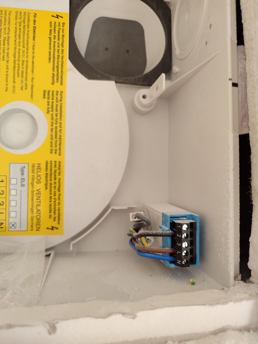

    View of the interior of a device with connected cables in a Helios electrical panel.
    This is how I connected it, I don't know if it will work, the black wire goes from the switch. Do I need a bridge on 1 (a) Automatic deactivation?
