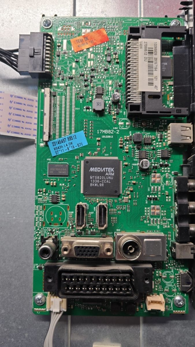

    Hi, I need firmware for telefunken TE40182N22FC10.
    I've replaced faulty power supply, now it doesn't boot.
    Buongiorno, mi servirebbe firmware per telefunken TE40182N22FC10.
    Ho sostituito alimentazione, ora non si avvia. Si è sprogrammato.
    modello tv : TE40182N22FC10
    AI: Could you describe the specific symptoms or error messages you see when you try to boot the TV?
    Multiple flashes
    Led fa flash bianchi

    Is it VESTEL? 17MB82-2?

    fotovip1
    Yes, 17MB82-2!
    Circuit board labeled 17MB82-2 with MediaTek ARM chip.

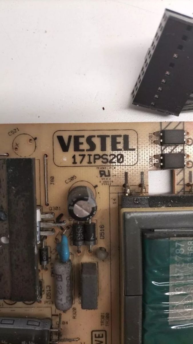

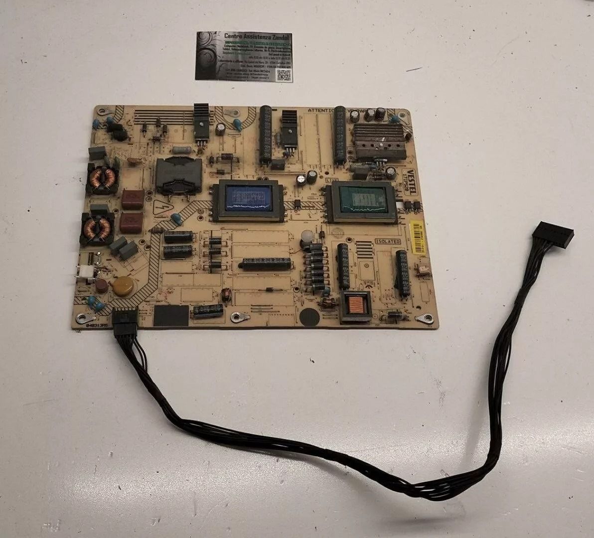

    does the replaced power supply have the same vestel order code?
    the power supply originally mounted is a 17IPS20 23144075 or 23152101 or 23108047
    what power supply did you replace it with? surely a 17IPS20: write the vestel order code (8 numbers, starting with 23, on a white label on the power supply)

    try a usb software recovery
    copy the file upgrade_loader.pkg on an empty usb stick, and insert it in the tv
    while holding down the ok button on the remote control, plug the power cord
    and continue to hold down the ok button until the standby led starts to flash quickly
    release ok button and wait
    if the usb recovery works, at the end, tv will turn on by itself
